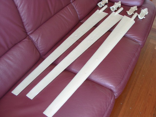

Hi All.
I've started on a page about my modifiactions of the Chinese blades. Its not completed yet, but worth a look anyway. I've finished my blades, just waiting for the paint to dry ( I should have read the can before I sprayed the blades, touch dry in 8 hours ).
So I wont get the blades mounted and tested for a few days yet.
The page address is http://www.thebackshed.com/windmill/articles/chineseblades.a sp
There are no links from the main site yet, not until I've finished the page and have some test results.

Excellent work.
The cut off disc should be for 'stone'. Not steel. Or better still, a diamond saw is the best.
Glass is derived from silica sand, it will make any teeth type saw blunt.
Trev @ drivebynature.com
Posted: 10:49am 13 Feb 2007
I was surprised how easy it was for the angle grinder to cut throught the fibreglass, like a hot knife through butter and very easy to follow the pencil line. I could see a orange glow inside the cut, but no flame or burn marks, lots of foul smelling smoke though.
I've given the blades a coat of paint, then sanded with wet and dry paper with water, and repainted tonight. This got rid of all the little fibreglass hairs.
