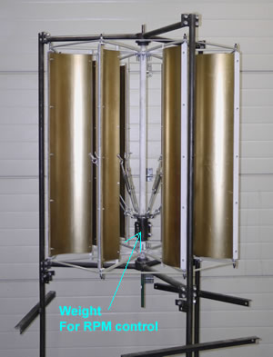

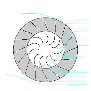

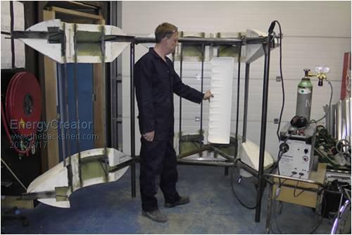

Hello all,
I am building on a V.A.W.T. and I like to share my design with all of you.
I don’t know if it’s gone work? But it’s the idea that the blades will automatically adjust by high wind speeds, so your generator will never turn to fast.
If the VAWT spins to fast the centrifugal forges will lift the weight and the blades change its position , so it catch less wind or will even brake.
With the weight you can set the maximum RPM for your generator.

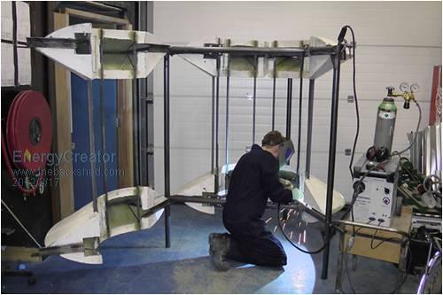

The prototype is made of Polyether and steal.

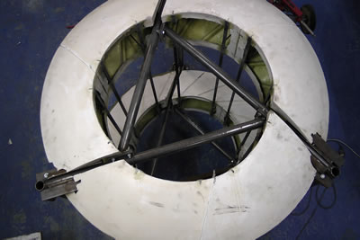

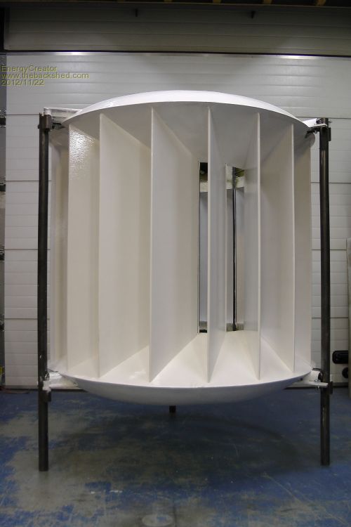

The directional scoops of the outer ring are not installed yet.
But you se the groves where they gone be placed.
The directional scoops of the outer ring will direct the wind in to the blades.
The back coming blades are not pushing in to the wind.
Whit this setup I hope to collect more wind, so the VAWT will turn faster by low winds.
The structure is like 3 doors you can open for easy maintenance

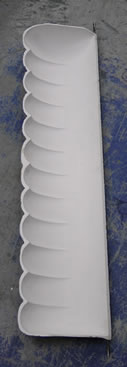

The Blade
The Blade design is just a gush, no idea if it’s working.
Therefore also the open structure of the VAWT so we can chance the blades easily.
This design is just a idea!
I don’t know if it will work?
There is only one way to find out.
Just build it!
I hope you like the design?
If you se some flaws , please tell me!
Brian

Welcome to the 4m. Overspeeding will likely not be an issue unless you run this in a wind tunnel.
If you're going to use the "directional scoops" in the outer ring, you'll do better to leave the "blades" flat as the outer ring will create what is called a "vortex" and it will automatically spin the air. Just make sure there is a clear exit out the top or bottom, so the incoming air has a place to escape or it will try to compress and just barely turn.
I built one like this about 40 years ago, but I usd one single blade made of sheet Styrofoam held in an aluminum channel frame mounted at its center through a timpkin bearing at the bottom. It was about 4 feet tall and 6 feet wide and gave plenty of both torque and speed with little to no noise. Unfortunately, it was ugly and got complaints from neighbors, so it went the way of most projects and was canibalized for other projects.
It looks like you've put a lot of time and effort into your idea; it looks well built. If it's performance you're after, flatten out the blades and open the top and it'll fly like the wind.

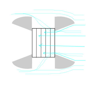

It’s a very interesting suggestion of keeping the blades flat, for the vortex!
I am very happy, it will cut down the cost and building time.
The top and bottom stays open for the wind to escape.

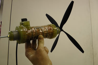

About the generators on my site, these generators I have used to explain the working of the coil in easy to follow steps, the output was not that important at the time.
But all kind of people were asking about the output of the generators I make in the movie, so I put them to the test.
Yes the first generators have a crappie output, these were only build to show you how the winding works!
Only Generator-3 and the micro generators have a reasonable output.

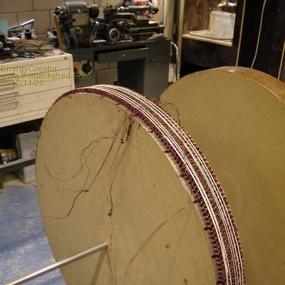

About the link, I didn’t show the flux ways so you can see the working principle better.
I only wanted to show that You can use a lot more copper wire by using the same magnets with my coil winding, therefore you can generate more energy.
But maybe your right, I have to explain it better.
But try to make this with a Axial Flux generator. Lol

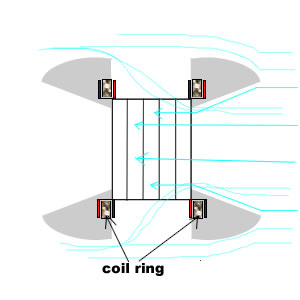

About the V.A.W.T.

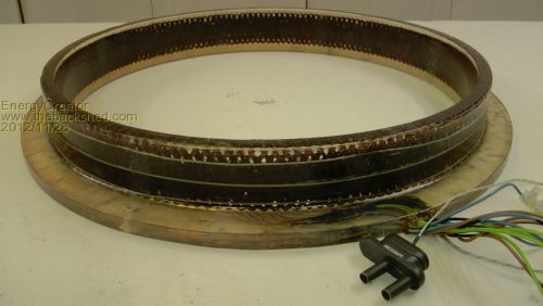

I don’t want a bulky generator under there, for this one I don’t I have much of a option.
But if it works I want to make 2 coil rings and place them like this.
Thanks for your comments
I will keep this post up to date with my building process.
Any suggestion is Welkom.

i want to compliment you on you little sausage shaped alternator .
the one you hold in your hand with a propeller on the end ,
that is a beautiful little machine to produce power.

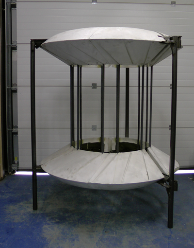

however, i just hate your vertical windmill design.
the reason is, the object you are showing us,
with the saucer shapes on the top and bottom, and all those horizontal and vertical steel pipes etc,
all of that, is not your windmill.
the actual windmill is not shown.
the way i am looking at it, the volume of material you have invested in the support structure is about 8 times as much as you have invested in the actual vawt mechanism.
what i am saying is, even with the increase in power that the peripherals may produce.
it would not compete with the output of 8 other stand alone vawt mills.
it's just a style i guess but at the design school i attended the idea was to remove any parts that were not necessary.
and when you had a devise that worked well with the minimum of parts you were done.

I hate my VAWT to sometimes, The thing cost me way to much time and money!
Your right the saucer shaped rings are the outer rings what will direct the wind flow, its not the windmill itself.
But the windmill is shown in the 1e picture in this post (the thing with the golden blades) is the windmill itself.
But its only a test model, the new blades don’t fit in the (middle thing) rotor?
I have to build a new rotor for the blades what fits nice whit the outer rings.
So, still lots to do…

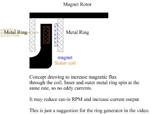

Hi, great project. I really like your idea for the stator placement for the PMAs. Have you considered using a MPPT controller for your system. It will make matching the PMA to your turbine much easier. Here is a video that explains why it is needed. Keep up the great work. I look forward to your future success. You have some very good ideas.
why a MPPT controller is needed Edited by govertical 2012-04-28

MPPT, never know from it’s existents?
But relay want to have the thing, I can boost my generators whit it!!
Do you have a link for the schematics?
Or where can I buy one?
Thanks again
