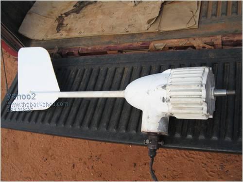

Anyone interested in seeing whats inside one of these 12/24 volt turbines ? I replaced the bearings but didn't have the camera with me when I cracked the case open. I still have a mount to manufacture for it, so I could open it up again and take a few photos if some members would like a look.

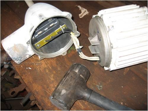

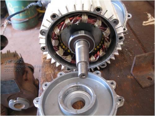

Anatomy part 1
There is six long allen key head bolts that hold the main body and tail section to the generator assembly. Good quality keys are essential because they are loctited in.
I used a dead blow hammer to split the case open by very firmly tapping on the cooling fins but a large piece of soft wood would do the same job.
In this pic you can plainly see the vertical shaft that bolts to the tower and the slip ring assembly ( I will take some photos of this but I need some more light to get a clear shot close up).
The two plates cast into the generator back plate hold the slip ring assembly so it does not move and wear the wires, very neat.

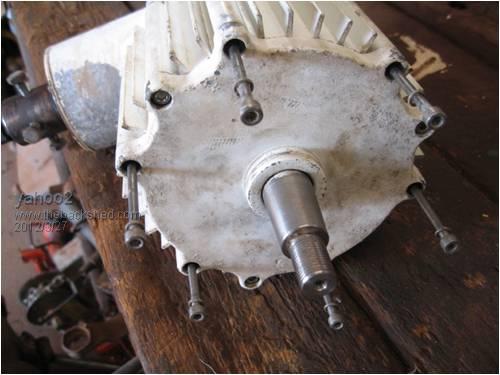

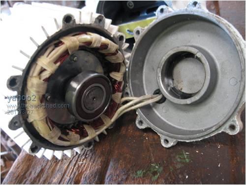

anatomy part 2
Next I removed the 3 short allen head bolts holding the rear generator case on, replaced the nut on the tapered shaft so I didnt damage the thread and hit the shaft on the end with the dead blow hammer. It is a tight fit, took 3 good hits to part the case away from the body from there the back case could be wiggled off by hand (lucky).
Removed the 3 remaining allen head bolts from the front case plate and tapped it to release the front bearing. Normally I would use a bearing puller, if you look at the first photo in the last post there is a recessed grip ring around the shaft made for a bolt on pulling tool.

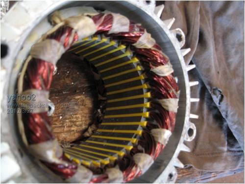

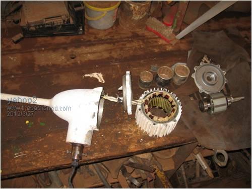

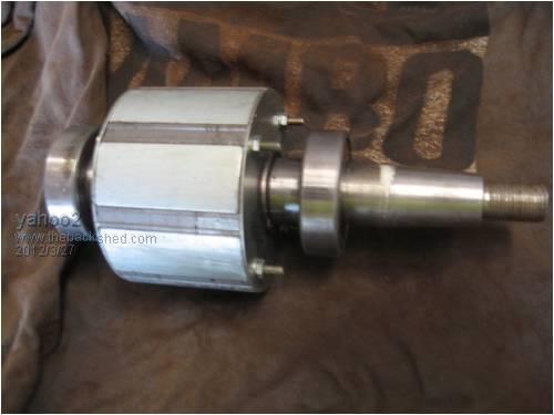

anatomy part 3
At this point I checked the wiring to see that there is no danger of breaking a phase output wire, it pays to cable tie them if they are not secured well, last thing I want to do is join a wire that has snapped below the level of the stator windings.
Next job is to remove the rotor, these don't have a lot of magnetism to fight so it is pretty straight forward. I found two large sockets and fitted one on top of the other on the bench, placed the case on top with the rear bearing fitting in the socket and just pushed down on the case until the rotor popped out the front.
and here it is!

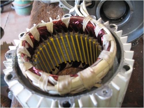

anatomy part4
Notice in the stator photos that the slots are slightly skewed,. I haven't had a good look at the wiring yet so I cant say how the field winding pairs are joined together, I expect they are in series.
The rotor runs very close there is less than 1mm gap between the rotor and stator body.
The bearings are a standard 2506, I replaced the originals with a NSK with a full contact wiper seal, I am not fond of the low friction non contact seal as it leaves a gap and lets in condensation as the turbine cools down. These only take a week to run in and loosen up anyway (and cost $7).
Well there it is, not to hard, 12 minutes to demolish a chinese turbine. I will take a couple of close shots of the slip rings and rotor when I have a bit more light and time. I gotta go study for flying tomorrow.

Posted: 07:06am 27 Mar 2012
Thanks Yahoo
Interresting. Looks a lot like a 3 phase servo motor inside, with the rounded magnets, no cogging.

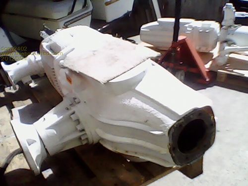

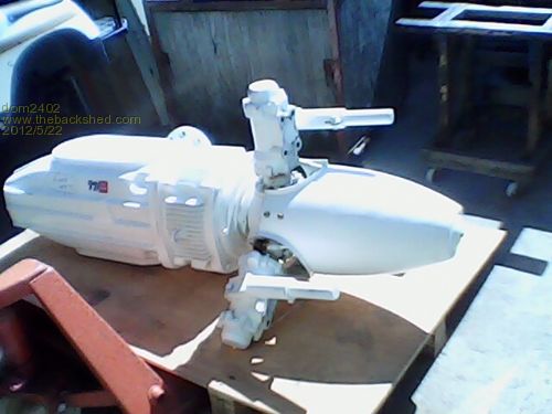

Posted: 01:54am 22 May 2012
My 2 projects 5kw and 10kw china specials 500v output I picked up at auctions need to make some parts, and building the 5kw buckboost to 240v ac controller right now then have to work on the 10kw fun fun

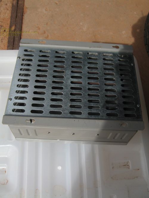

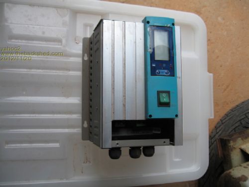

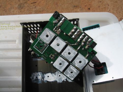

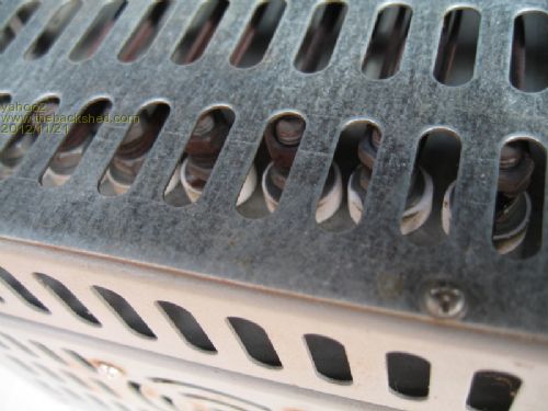

Here's a few posts of the controller from the little turbine. The controller is fully self contained with inbuilt fans and diversion load in the back half of the box.
It is quite a good design apart from one thing, in an attempt to go high tech the voltage adjustment for diversion is set via the LCD screen and touch buttons. It has given a high battery voltage reading from new that we have had to compensate for in the setup. I hoped it might be an assembly fault or a dry joint and stripped it down when it was new, unfortunately it wasn't that easy and I had no luck in getting a replacement circuit board so we put it back together and ran it until it died.
which it did.
stuck in the diversion mode and drained the batteries (all 24Kw).
and blackened the sheet of marine ply it was mounted to.
pics of the inbuilt diversion

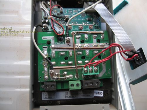

Posted: 03:02pm 20 Nov 2012
two boards inside, bridge rectifiers on one and the other with the row of 5 transistors along the bottom, switching circuit, voltage sense circuit and the chip that runs the LCD.
the second photo shows the back of the rectifier board, there is a couple of extra bits so that a couple of solar panels can be added but it is all pretty straight forward.

Posted: 03:21pm 20 Nov 2012
I am still a little confused as to what controls the running of the fan, if I can work that out I will wire a new controller into this box.
