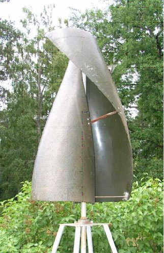

1. I came across this interesting design for a Savonius, apparently some Finns built it.
Does anyone know anything about it ???
No Finnish jokes please!

I have not heard or seen anything about this.
You can read about vawt turbines, in Hugh Piggots latest blog;
http://scoraigwind.co.uk/2012/04/helix-wind-asset-sale/
Beatiful decoration, but nothing to do with real energy production.

The vawt turbines are crap yes im full of beer but it is still true! good for decoration but power production they might give a little in a hurricane but for off grid A joke!
The basics are PV (the backbone) Hawt, fun and good power in good wind.
This has not changed for a long time and will not change any time soon.

that helical looks like a windside clone.
http://www.google.com/url?sa=t&rct=j&q=&esrc=s&source=web&cd =1&ved=0CE4QFjAA&url=http%3A%2F%2Fwww.windside.com%2F&ei=f8a KT4mIMIfn0gGR7-SZBg&usg=AFQjCNHYDygJNlYfsJTwniUfDuhRuNdcRA
verticals just can't operate as efficiently as a hawt.
but they look so good people keep trying.
you can't put a propeller on a stick in an urban environment .
but verticals fit right in.Edited by electrondady1 2012-04-17

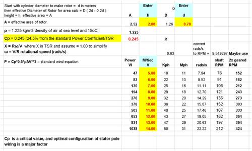

I recognise that VAWTs can never be as efficient as HAWTs, however I am looking for a starter project for a "Men's shed" which is starting here in Moss Vale NSW.
The relative simplicity means that a working example can be created and get ideas and enthusiasm flowing.
I knocked up a simple spreadsheet ( with some assumptions ) which, I think, support a dual F&P .6mm gen setup ( overkill, yes but I have two motors )
The fun bit will be experimenting with pole mix & matching, I am thinking of setting up a test rig to evaluate the stator config - again an activity which should get some chaps in the men's shed going.
Here is a snapshot of my spreadsheet for a particular sized VAWT.
The location of the Men's shed is next to a main road so it would attract interest.
To Err is Human, to Aar is Pirate

Posts: 1166
Posted: 11:30pm 16 Apr 2012
sod the calculations, I reckon borrow or hire a sheetmetal roller and roll up a few experimental blades one night, that will kick things away.
The angle needed to give it a 180 degree twist should be simple to calculate for a specific length and diameter cylinder, the beauty of sheet is that you can roll it back flat and try a different twist just for the hell of it.
Only thing you need to know is the smallest radius that the roller can make and the length it can handle.
Get a prototype flying on a bare shaft and learn from a few mistakes, before you start on the generator, it is way more fun than getting it right the first time.

Sorry to jump in so late. I built one similar to this about 3 years ago and I'm here to tell you two things:
Does it spin? Yes.
Does it create any power? Absolutely not!
Like someone else said, it's a nice ornament; animated yard art at its best.
