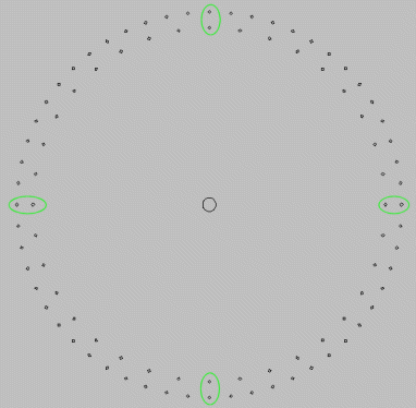

BTW, how do you do the math to come up with the phase combinations. That could be useful info.
Posted: 01:17pm 22 Apr 2012
I cheat. I use CAD to draw the stator,( just points around a center, nothing fancy, circular array they call it. ) and hub, then count how many stator poles line up with a magnet exactly. I also check the magnets are the same pole.
You can see in this one the magnets and poles only line up in 4 places. Count the stator poles and we have 9. Hang on, I'm sure that was 10 last time I looked
OK, my mistake, it's a 9 phase machine.
There would be a simpler way to work it out mathematically, but I think visually and hate maths.

O' I gotchya. Since you had the answer, I played with the math and, yeah, I can see why you do the visual thing
So, this means I should end up with nine blocks of four, right?
Posted: 12:57pm 24 Apr 2012
Yes, the max number of coils you can wire up in series is 4. Nothing wrong with that, 4 coils ( 9 phase 1X4C ) could be used for 24 or 48 volts, depending on the turbine. You could also wire it up as a 9 phase 2X2C for 12 or 24 volts, again depending on the turbine.
