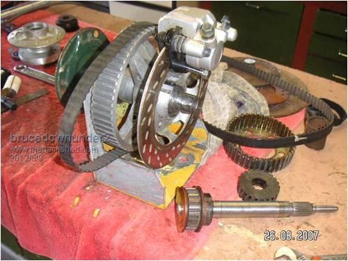

OK,, I'm fairly handy with tools --but need some assistance with a very important bit of control gear..
This is my tower -top disc brake . It needs a remote controlled (maybe a tacho-controlled) bit of electronics that can be operated about 100 Meters remotely.
I'm working 48v Exmork 2-3 Kw wind gennie --13 foot dia blades --
I have lots of cable and lots of electronic gear -67 yo retired communications guy , but the stuff in me head is dying fast..

Yes, Glenn. I tried the "fishing line down the tower" from the brake handle some time back --it worked,, was a deep sea fishing line ,,would take a lot to break it.
But, hey, the experiment was successful, she pulled a screaming mill to a stop fairly quickly..
Apologies to Phill for my "spit" --hard day at the office-- he's doing some good work,,hope he still talks to me?..
The office----- I'm building in under the house a "clean" area.. I'm sick of the westerlies and wet damp on my toys. I'll keep an area for the welder,grinding,painting,drilling and other rough work.
I hope to bring that disc brake out of it's coffin one day and fit it to the exmork.
Would still like a electro-mechanical fitting at the top to activate the master cylinder(have all the bits).. Any help will be appreciated..

Anyhow, I'm interested in comments or suggestions about building a faily simple electronic /mechanical push/pull master cylinder device to control the disc brake .
I've got the hydraulic (sp) fittings and master cylinder off a motorcycle disc brake installation. I'm thinking ,I just need the remote control to operate this plunger and release it ... probably only 25mm or so ..
About Pete's comment about revving metalwork up the top ,,, well, Pete, every car in the world uses disc brakes ,and every wind gennie I've seen uses a huge disc brake to control the rpm--..think about that!!.

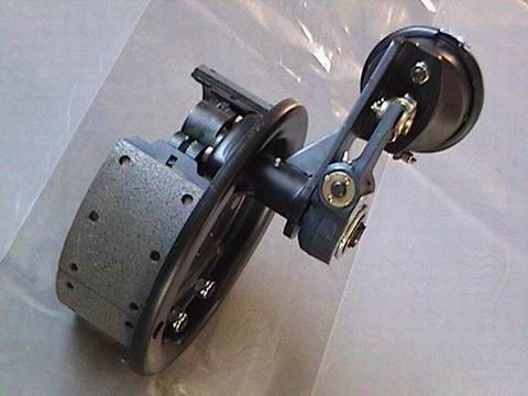

I think semi trailer airbrakes have a lot of potential.
the parts are very cheap new and I imagine that replaced parts with small amounts of wear could be had for free. When I rebuild truck brakes it is easier and cheaper to replace everything than chance a defect notice.
I have used the s-cam style brakes with actuators for some jobs and the original spring and air diaphragm setup for others.

Maybe a mill tower somethink like this then

yahoo2
Joined: 05/04/2011
Posts: 1166
Posted: 03:28am 12 May 2012
choice
