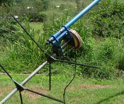

Well it happened, the yearly wind change. For the next 6 months the wind will be blowing from the south east, and I live on the north west side of a hill.

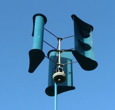

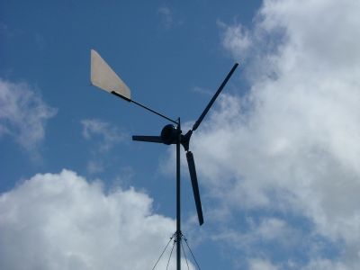

Last year the HAWT didn't move once for months, thought I remember the Lenz windmill on its stumpy little 7 foot tower was running every day. So this year I decided to take the HAWT down and put the Lenz up in its place. Even if it only made a few watts, at least it would be spinning around and looking the part.

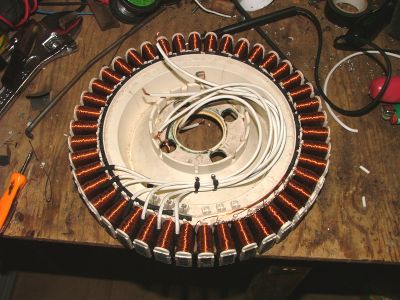

First up, since this Lenz is a low RPM machine, I re-wired a 60 series stator as a 7 phase cogless 6 pole. This will give the best voltage at low RPM, and a 7 phase conversion means no startup or running cog. Startup cog was never a problem for the Lenz, but the cogging did make a lot of noise in those big wings, so I figured a cogless F&P would work better.

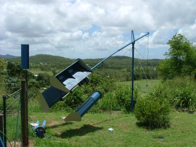

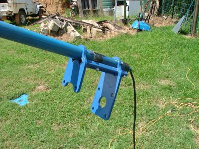

On Sunday I droped the tower and removed the HAWT, then fitted this bracket to take the Lenz. I wanted to keep the mast head intact so it would be easy to refit the HAWT when the winds return in September.
Here is the F&P stator and Lenz struts in place.
And all together. There was a bit of weight in it all, the tower was starting to bow.

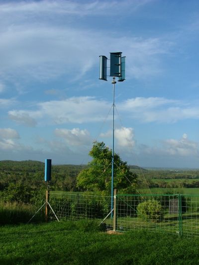

And up in the air.
So fars its going good, I had the PicLog windmill logger on it today to get some readings, very little wind, but it still made 14 watt hours for the day, and peaked at 22 watts a couple of times. Remember this is only a small windmill, 1.56 meters square compared to the HAWT's 3.8 meters squared. The HAWT would have made no power at all today.
Over the next few weeks I'll keep the PicLog on the Lenz to get some figures.

Posted: 11:21am 06 Mar 2007
Hi Gonzo
The F&P vibrates as it rotates, cogging we call it. Or at least the standard 3 phase version does, the new 7 phase version has no cogging.
When I first built the Lenz2 I used a 3 phase F&P, and the cogging vibration went up the drive shaft and into the wings of the Lenz. Now these wings have a large surface area, and they acted as speakers, radiating the vibration from the F&P. So it made a very loud drone noise, a bit like a 4 stroke motor bike.
A 7 phase or decoged 3 phase F&P gets rid of the problem.
