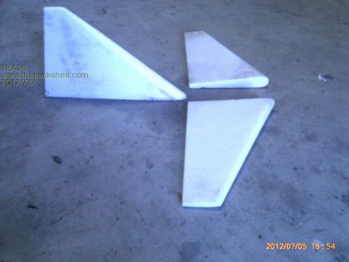

Hi guys, I have made a foam cutter from the nichrome wire removed from an old hair dryer and a small gel battery, to get the shape on the wings i made some end profiles out of MDF pinned them to the ends of the foam. I used a pair of metal rings on the ends of the wire to pull it tight over the two MDF ends, worked great

These where going to be the tail sections for the mod plane I mentioned, its still in the unfinnished projects area

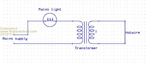

A simple hotwire cutter i have made that works reasonably well for how simple it is follows below.
You need a transformer of around 2 amp output capacity (or greater), the output voltage is not 100% important but think mine was about 24 volt.
A standard household light globe is fitted in series with one of the mains supply wires, this works as a current limiter to the transformer to prevent it burning up, because the secondary side of the transformer has a dead short across it being the hot wire.
The light globe can be changed to adjust the wire temperature..... a 25 watt globe will give a hotter wire than a 100 watt globe will.
The hot wire is connected as a dead short across the output of the transformer. (secondary side)
I used some 0.6 mig welding wire, but piano wire would work better, you need a wire with some strength or you will snap it frequently.
Also the wire needs to be left long and coiled up one end for spare replacement, as it will break, then you can just slide a few inches through, lock it in place and back to work.
I would do the wire as a bench mounted frame and feed the foam through it like a bandsaw, as opposed to a hand held bowsaw arrangement.

Posted: 09:49pm 06 Jul 2012
Not trying to be picky but putting a higher wattage bulb in series increase temperature as it is a lower resistance.
