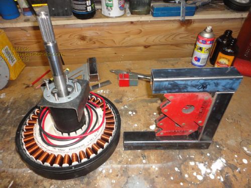

I thought I'd share my build with fellow members and hopefully discuss a few ideas along the way.
This is my 2nd F&P project, my first being a HAWT, rewired 6x2C, mounted on Randy's Weldment.

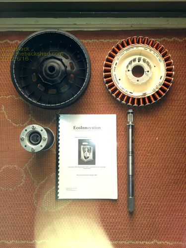

I now want to build a VAWT from scratch. I picked up an untouched DC 36 Pole stator, SD type 4 Rotor (Black One), shaft and bearing from evilbay for $70. It was originally purchased from ecoinnovations in NZ for about $200. This will be the powerhouse for the project.
I wanted Lenz2 wings. I wanted to recycle as much as I could from previous projects, I wanted it mounted on a 100 x 100 RHS pole (cos I have 6 of these at home).
Had to be in a spot lower to the ground (3m) as I plan on testing different ideas so easy access to it would be good.

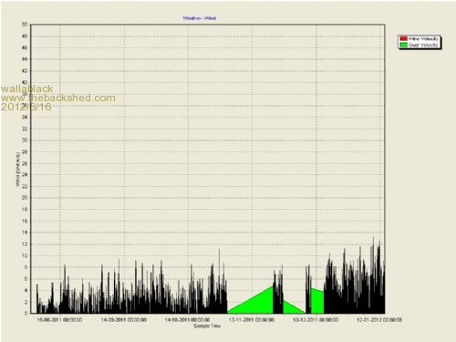

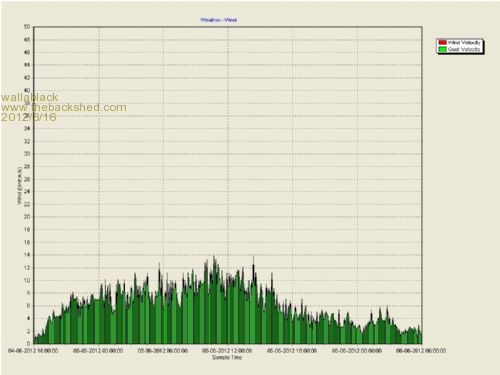

It had to be good for my areas wind, average about 5m/s but has to cope with 14-16m/s which we get often too.
As ar as wiring the stator goes - at this stage I might leave it stock to see how it perform, probably change my mind on that before its finished.
This was my evilbay purchase.

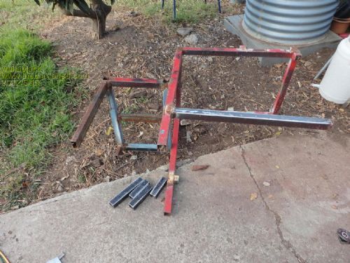

Good steel to recycle.It was an old brew stand I built for brewing beer which I no longer do.
I want to utilize two F&P shafts the older style srews into the new style, as long as the shaft spins the right way I shouldn't have a problem, but will probably put a collar at the join.

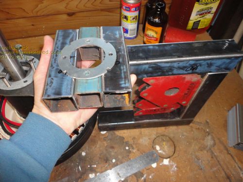

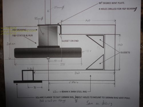

This is a drawing I did for the mounting. The angled plate was laying around here but after looking at it all cut up on the bench I have decided it would be too weak as it would be bearing all of the forces.
Will go for this idea for the bearing mount.
The bottom of the frame will have a 140mm x 140mm square flange to bolt directly to the end of my 100 x 100 RHS.

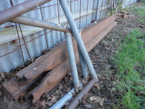

This is the 100 x 100 I will use for the mounting pole. They are 3m long each. They came with the house. The squashed end will be under concrete, and 2 will be welded together length ways for height.
Any comments more than welcome.

Hi wallablack
Have you thought about making the vawt horizontal? Are you going to use gearing?

I have thought about that windtinker but then I lose a mill. Gearing....I have thought about it and a reason why I will make the whole frame out of the same size materials, so it can be added to if I need to add extras ie gearing.

Hello Wallablack,
The vawt turbines are "not" for everybody...But haveing said that,
It will take considerable anchoring to keep the thing planted firmly on mother earth. I might suggest a cross or "x" welded at ground level with anchors at the ends in cement. You may even need to gusset the x braces to the vertical pole.
You probably won't spin up the rpms to reach cut in with out some sort of gearing.
There has been success with my 'vawt', however I believe it can be made to perform much better.
There is lots of reading here on the forum about vawts, and most are willing to help you with suggestions and info.

Two ways I have considered for foundations.
1. 1 Cubic Metre of 35N Concrete with 4 M20 Grade 8.8 Threaded Rods. Rods will protrude from the conrete about 50-100mm. The base of the 100x100 2-3m tower will have a flange to bolt directly to these rods.
2. Same block as above except the squashed end will be buried into the block.
Either way block will not be formed in the ground (shutter & backfill). It will simply be poured directly in the rough dig hole to form a better foundation. Rebar will be used in correct manor as well.

The decogged stator is awesome, it takes nothing to spin but that does not mean it will make good current. The reason for this project is to try different things and learn a bit along the way. My mills and panels are all grid tied but will be changing this to a 24V install in the near future.
A couple of weather station files...wind speed in m/s on the vertical axis.

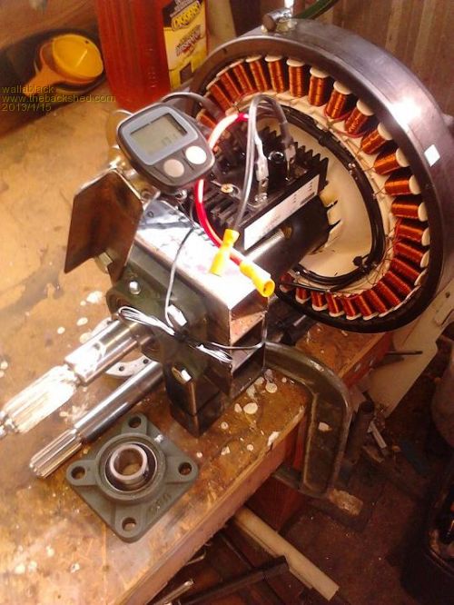

This is what my VAWT project evolved into. Thought I would share...
I basically flipped it onto it's side and clamped it my bench.
I brought a $10 bicycle speedo of evilbay to use as an RPM counter and mounted the sensor magnet on the mag hub. I was unsure if it would work as the diameter of the mag hub was greatly smaller than that of a bike wheel...then my brain started working and it does not matter, it is only RPM and is measured by how many passes it make...DUH.
I wanted to try the same thing with one of my mills at one stage but the wireless ones don't reach that far and I would have to extend the cable on the wired ones with bell wire or similar...just didn't get my round tuit working.
It is a good cheap little test bench now. I have a pulley with a 7/8"/22mm bore I plan to mount to the spline and the other end will be driven by a small electric motor.
