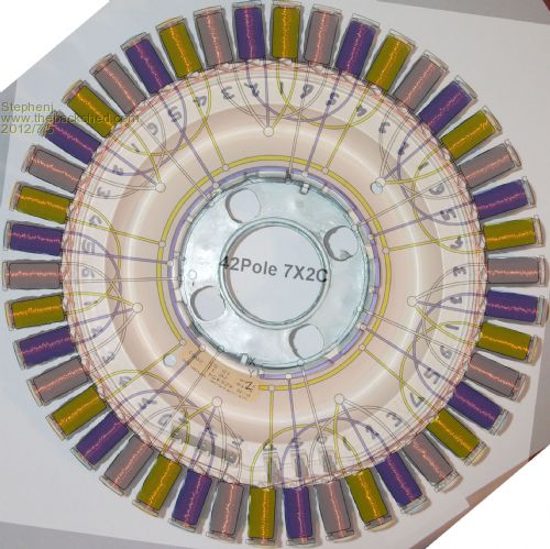

Hi guys,
I'm new to the forum and pretty green with electronics in general but Ive been keen
to build a turbine for years and just managed to score what I'm pretty sure is a 60
series 42 poles smart drive (P/N:426454)
I wouldn't have been able to attempt this without the rewiring diagrams so thank you.
Id just like to be 100% sure though before I start cutting wires so I layered the 42
Pole 7x2C star diagram on my stator image.
would someone be so kind as to tell me if I've got things around the right way?
If so I think I might be able to give it a go

Yup, worked a treat, cheers...
