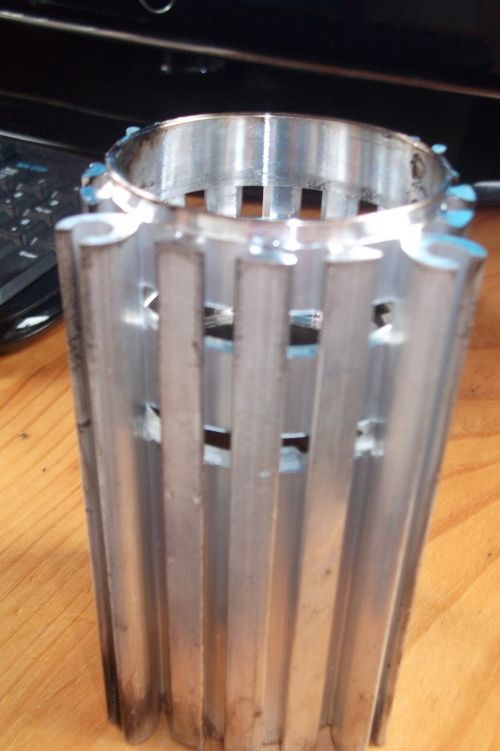

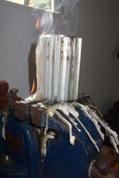

I was thinking about how to remove the the plastic from the shaft then I did something stupid and probably lost a few brain cells in the process.

Actually Steve, that came out pretty nice and clean .. Can you describe what you did,pls.

Yeah you should do that outside, the gasses of that would be nasty.
I took it off using a 1mm thick cutting disc in the grinder to get the bulk off them used a old screw driver to punch the wedge shaped bits out.
I am not sure but maybe a hot oven would do the job.

Well, looking at the first picture my guess would be a blowtorch
While the result looks nice and clean now it certainly would not be as strong as it was when at least some plastic was in between the alu ribs. Pressing in the bearings might seriously distort the alignment of the two bearings unless the lot is somehow carefully fitted into a new housing first - RHS tubing perhaps.
Leaving the plastic in situ and only shaping it either square or round, depending into what it is going to fit, is a better idea and that is what most F&P windmill builders appear to do.

I have done this a few times, the bearings are not a very tight fit so there is no problems refitting them. Once the whole lot is in RHS tube and filled with resin it is very solid, probably much more than the original plastic. The aluminium must be an alloy as it is quite strong on it's own too.

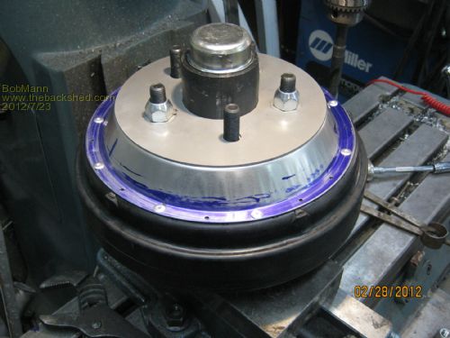

BobMann
Joined: 30/06/2011
Posts: 134
Posted: 06:12am 23 Jul 2012
  Stephenj said   I see Bob has used a hub of some kind for his rotor, this looks like the bees knees to me (but I know nothing about these things).
it looks pretty fool proof / bullet proof, I'm sure it performs well too..? is it just a matter of glueing the ?Neo? magnets inside the hub..?
Im gonna pop down to pick a part and have a peruse at hubs and stubs anyway :)
Hello what do,s (bees knees to me) mean??

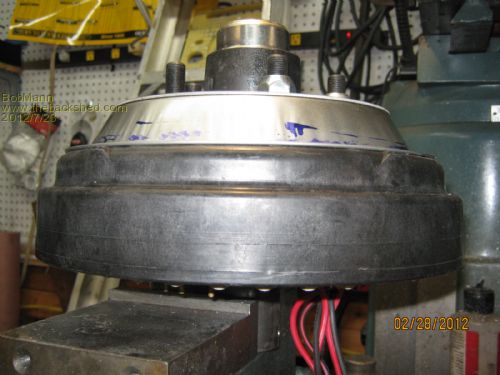

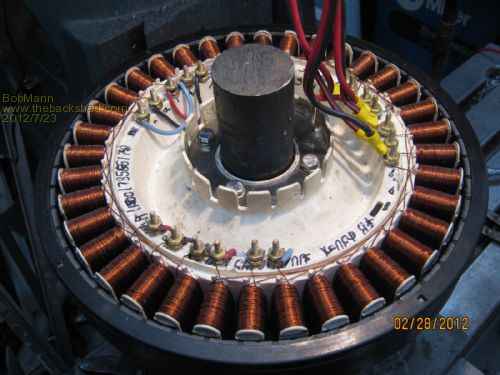

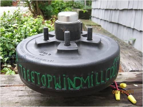

The drum is from a trailer setup you will need to have the drum turned at the auto shop like.050 ths.
But I think you would do better to us this stock Smart Drive setup I build.
Here it is from the side
Here it is from the top
I use the trailer hub with out a brake drum its drag from the bearing is 1/2 the drag of the stock F&P bearings and can be adjusted and regreased over time.
Doing it this way there is like zero cogging with the 60 stator.
Building this way you can swap out stator on the fly with out taking the hub apart.
Here is steve testing one of my Mann Smart Drives with the news MPPT
MPPT Testing
It has been a long and hard road for Steve and me on this project but I think it will work for all.
Bob Mann

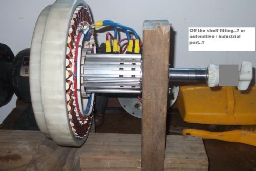

Thanks guys, and thanks Bob for your photos its the bees knees and totally bullet proof :) I had fun over the break, I was powering bulbs and the radio just by spinning the rotor by hand. I was getting 14-18v DC 1-2amps.I made some blades out of PVC too thanks to the online blade calculator.
I thought Id ask another question instead of clogging up the forum with Newbie questions..
I have no access to CAM or CNC / metal band saws at present, although I like the idea of sourcing stuff on the cheap to see how cheaply I can put together a wind turbine
so my question is, does anyone know of a female fitting (industrial/automotive, whatever) to fit over the end of the shaft?
I had a look at a few of my sockets, they didn't fit properly of course but something along those lines.. or is there anything off the shelf that might fit over it??
BTW whats the correct terminology for the machining at the end of the shaft..?

The end of the shaft has spline on it, a simpler and cheaper way to fit a hub is to use the 25 mm round part of the shaft just behind the spline. You could either use a pulley off the shelf or get a hub machined out of steel. Drilling a hole straight threw the hub and shaft and putting a bolt in the hole and a nut on the other side will stop it going anywhere.
I have used my 1/2 inch drill in low gear to drive shaft directly for testing the generator. Although I found just 1 phase at a time is all the drill could comfortably handle.
BTW you can cut off the end of the aluminium housing where the seal was fitted, this will give you more shaft to work with.Edited by Madness 2012-07-27

Somewhere in this section is a female spline that fits the F&P shaft. From memory(haha,what memory), it's a toyota corolla or something like that .The end of the clutch housing , I beleive.. I once spent 2hours rat ing through a small car wrecker at brookvale on the north shore -he had hundreds of clutches, gearboxes, tailshafts,uni joints --all those have spline drive --go take a look ,but do a search here first.
