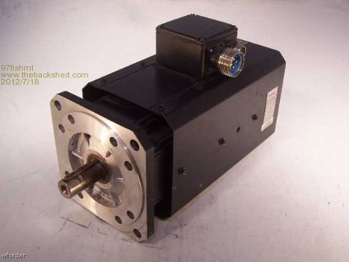

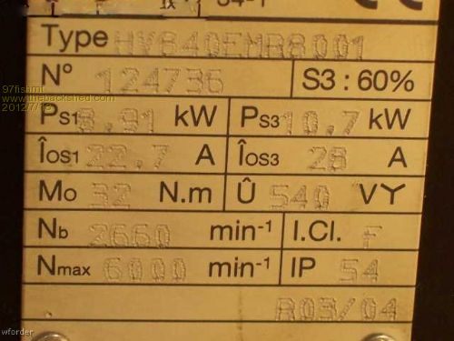

Here is my latest one I'm going to put up on my 65' tower next week.
This one will give the really big one a break. I saw over 1500 watts
out of the big one a couple weeks ago but it just needs a bigger rotor
to get the power out of it.
This one will probably be pushing the limit for a 13' rotor but I'm
game. My furling system works like a charm and easily tunable.
I'll shoot for 30 volts and 50 amps for 1500 watts to start but I'm sure
I can push it to almost 3000 watts. It's line to line resistance is 1 Ohm.
I power an off grid home this way and have for many years.
MikeEdited by 97fishmt 2012-07-19
