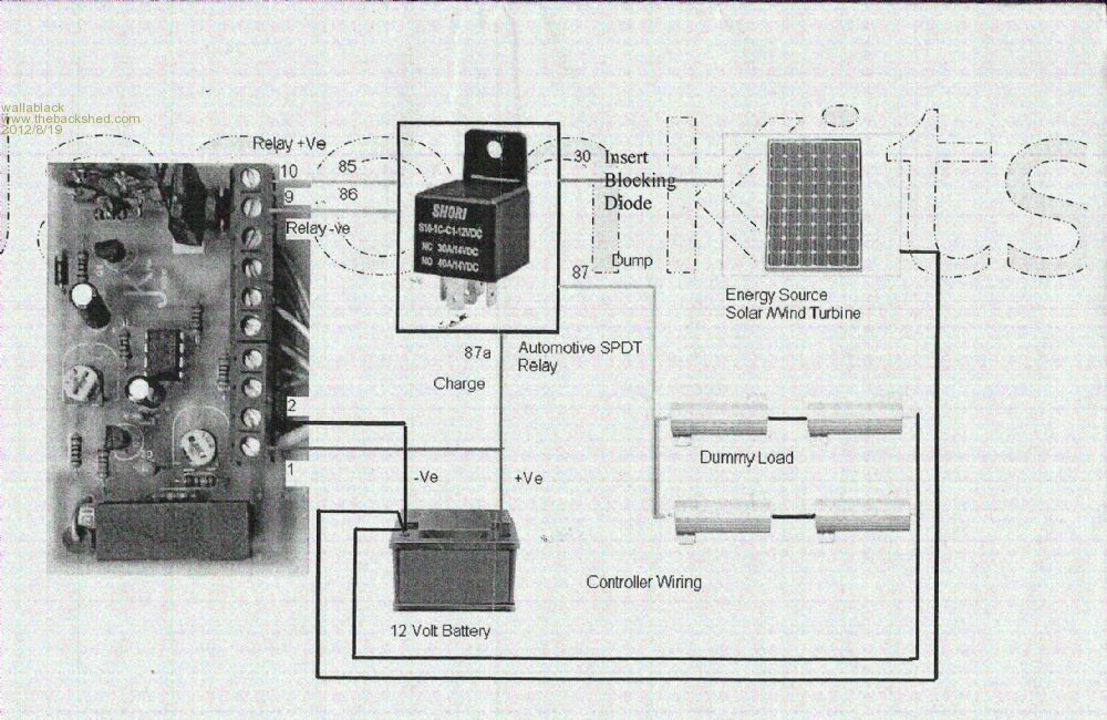

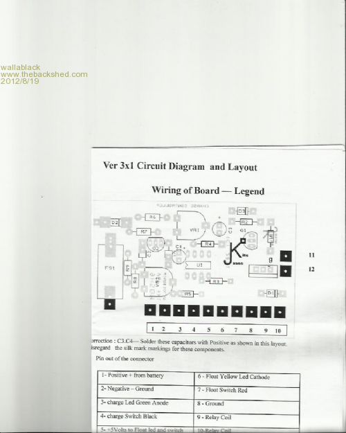

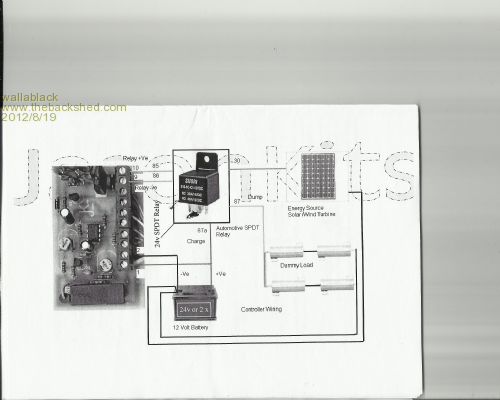

I got a great little charge controller from Jason Markham yonks ago and want to change the 40A Relay to a 100A Continuous Cycle Solenoid/Relay. I have tried to do the rewire in different configurations but none seem to work. It seems such a simple conversion but why am I having so much greif with it. It's not the controller as it has been working perfectly with the 40amp.

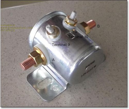

Does anyone have any input that could help me with this? What wire goes where? I've confused myself. My source is the + and - from my rectifier of course and my dump load are just resistors as in the diagram but 4 @ 300W which are in one string.
Terminals 9 & 10 (at the top of the picture go to the relay coil, 9 being positive)go to the two small terminal on the front of the solenoid to operate the coil.
The terminal execution.
The diagram of the 30/40 realays use.
The Solenoid.
Help is hugely appreciated.Edited by wallablack 2012-08-20

Hi Wallablack,
if you need us to read the diagrams posting as a gif file will help, the size limit is a lot bigger.
your old relay is listed as spdt (single pole double throw) so the power is always going somewhere, battery OR diversion. The 100 amp contactor is just on or off. the controller is designed to switch power output from terminal 87 to 87a on the old relay.
Is it 12 or 24 volt? I cant tell. The simplest solution is to find a SPDT relay, I do know where you can buy some good ones but the memory has deserted me.

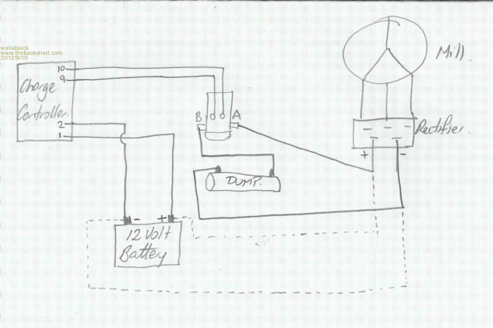

A to supply V+
B to dump load resistors
9 to controller terminal
10 to controller terminal
Supply V- to other connection on the dump load resistors.
Take note of Yahoo2 comment about the solenoid requiring much greater power to drive the coil than the relay, it might overload the circuit of the controller trying to drive it, so you may be best to use the 40 amp relay to drive the solenoid.
Then you have the problem of powering the solenoid coil and if you use the power from the rectifer it is likely to switch off the solenoid when the dump load is on, hence disconnecting the dump load........not good.
Pete.

  Downwind said   A to supply V+
Pete.
Soooooooooo....yay or nay?
An IRF540 drives the relay coil so it should be right, it is mounted to a good heat sink too. The regulator will get a heat sink too. I have no doubt at all that the circuitry will be okay.
Foolproof systems do not take into account the ingenuity of fools.

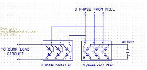

Yes that should work, EXCEPT! the circuit design will dump power from the windmill and the battery, i see this as a poor design because why do you need to dump power from the battery when you have taken all that time to put it there in the first place.
All that is required is to dump the power the mill generates (not the battery as well) you could use a blocking diode between the mill and battery to prevent the battery being dumped, but i dont like this method as it adds a 0.6v drop to the battery.
The best method is to use 2 x 3 phase rectifiers, one rectifier supplies the battery, the second rectifier supplies the dump load, this way there is no added diode loss to the battery system and also prevents battery discharge during activation of the dump load.
This is the system i use and it operates faultlessly, also the dump load runs much cooler because when the mill is dumping its like hitting the brakes and the load pulls the mill rpm down effectively stalling the mill in lighter winds, once stalled it just spins slowly making very little power till the dump load is switched off again.

  Downwind said   The best method is to use 2 x 3 phase rectifiers, one rectifier supplies the battery, the second rectifier supplies the dump load, this way there is no added diode loss to the battery system and also prevents battery discharge during activation of the dump load.
Pete.
Do you have a link to a wiring diagram/pic, im interested and curious to see this.

I thought is was rather simple and didnt need a schematic.
Doing it this way you might not need that thumping contactor and the 40 mamp relay might do, it depends on the size of your mill and will it produce over 40 amp???
You say your mill is shut down because of no dump load.........WHY????
If your battery is full then it should be shut down otherwise you could have it charging and manually shut it down when the battery is charged.

Thanks downwind for the schematic. As I am easily confused and do not have a black belt in electrickery I need to ask you if it is worthwhile to switch on the dump load with three relays on the three-phase side or one relay on the DC side?
In other words, is there a loss in the connected rectifiers (to dump load) despite the fact that the dump load is switched off on the DC side? Should not be BUT connected transformers with no load get warm from memory?

No there is no losses with switching on the DC side with a relay.
Much cheaper switching the DC side.
Its best to use a Solid State relay, as they have no mechanical parts inside and should your system switch the relay repetitively then the SS relay wont cause problems.
I use 80 amp DC, SS relays for my dumpload, about $25-30.00 from China.
With using SS relays its best to use larger rated relays then needed (IE-60-80amp for 40amp resistive loads) this helps keep their temperature down.
The SS relay MUST be a DC,DC relay as there is AC SS relays that are often listed DC,AC which refers to DC to turn the relay on, and AC through the relay switching. (the AC relays will not work with a windmill even on the AC side)
