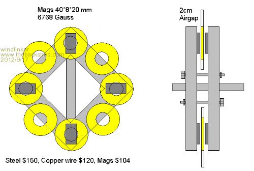

The mill is going to be a hawt, using the 1.55m blades from ecoinvations? , below is the idea

Is this a 2 phase generator with 4 magnet pairs or wired as single phase?
Your post here is like a cat on hot bricks, its all over the place, no one can get a grip on what you want to do.
Slow down a little and tell us what you intend to do, pulsed DC and other great ideas in your head is doing our head in.
There is no magic formula to answer your questions outside a tested and proven design, other than what is involved of how to design a system to work effectively to the required needs.
Its all a balancing act of blades, rpm, cutin voltage, power out, magnets used, coil turns, wire size, Etc, etc, etc, etc, etc,.................................
I could scratch around in my underpants and pull out some figures for you, but they will be of little use.(and smell bad)
The forum has a search facility you can use to view past threads on AXFX design, and after some time you will realize only a few prove effective, and the methods involved to achieve that. many here have taken the time to post their full development from start to finish with honest results, and you should do the research to understand the science behind how to design an alternator.
We will help you where we can, but a dog in a bone yard approach will not help you move forward and wont get answers from those in the know.

i find the diagram confusing .
if you want low voltage and high amperage build a single phase stator.
one coil per mag.
run the coils in parallel rather than series.
