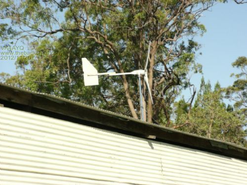

Hi all,
You may or may not have followed my entries on the OEM mill I set up more than 12 months ago it has been chugging away in low winds until yesterday, we had the storm cell that hit Brisbane and did so much damage, the wind gusts on my little wind recorder showed 60 MS with a wind component average of 41 MS during the event which lasted for one hour or so.
The OEM mill survived the wind and furled reasonably well but the mast a 2 inch OD steel pipe was bent back around 20 degrees from the force of the wind on the furled mill. there are no shorting devices on the mill so it relied on furling for survival.
In the gentle breeze today the mill was spinning with no apparent damage either mechanically or electrically, but due to the bent mast it didnt track the wind. so next project is to pull it down and inspect for internal damage not expecting any as it is still spinning and generating.
Fun and games with wind power.

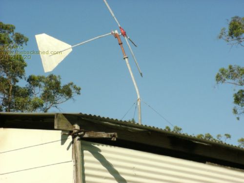

Hi All
Here is some pics of the OEM with bent mast and the old mill still running.
The old mill is still up and running, it uses a slightly larger pipe for the top of the mast.
All the best
Bob

Hi Bob,
Good to see it survived the wind event relatively unscathed, by the looks you have the guy wires attached to the top tower flange. My advise to all who have bought one of these and have done the mods, especially with extending the blades is to weld on guy wire anchor points as close as possible to the blade dia arc. As you have said it is only 50mm and it needs all the support it can get .
I would think a man of your ability will have it all fixed and upright in no time.
As you have said "Fun and Games" with wind power , Mother Nature will always find the weak point.

High Phill
The attach points are just outside the blade radius and about a foot up from the original joiner flange, which was cut off and the pipe was slipped inside the two inch mast pipe.
I think I will make a hinge joint there when I take it down as it would be easier to work on if I can lay it down, also it would make the top pipe stronger.
I think if it had standard blades it wouldn't have bent as the extended blades give double the swept area of the original. Like all things modified it finds another problem to deal with.
