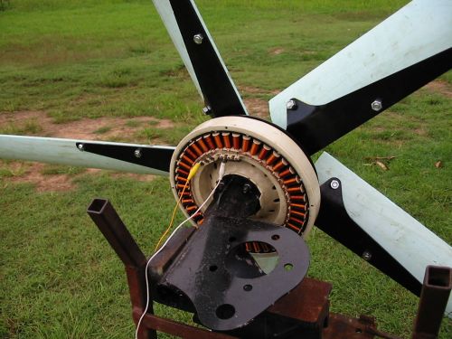

I have to mount a rotor on the back of a trailer stub axle wheel plate, and I'm trying to work out the best way to do it.
The main issue is, the rotor's surface is sloped away from the wheel plate in the center, possibly making the use of nuts and bolts difficult.
The rest of the turbine is Here
Any ideas?

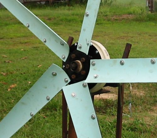

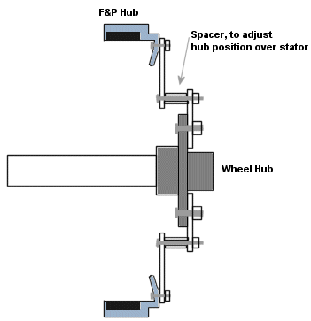

Posted: 11:50am 02 Apr 2007
Very good work Nigel. Had a look at your link and you have been busy
Your design is very similar to my first F&P windmill. These photos are not the best, but they may give you an idea how I did it.
I cut the center out of the magnet hub, except for a rim of about 1 inch. This was then bolted, using the existing drain holes drilled out to suit 1/4inch bolts, to a 2mm steel plate, which in turn bolted to another steel plate with holes to suit the studs on the wheel hub.
I could adjust the spacers to align the hub over the stator. It worked ok, but I remember I had problems with the hub not centered correctly.

Hello Nigel,, very good work you have done there.
What you have done with the trailer stub axle and hub is a very strong set-up ,but from what I can see you are going to have trouble getting the Rotor's magnets fully positioned. That thick hub plate will prevent the Rotor from being positioned.
The one idea I have is for you to build a steel sleeve that could be fibreglassed to the cut away ring of magnets and this sleeve then having a end plate that bolts to the hub--fairly complicated job ,,and it has to be very accurate.
From previous experience, these plastic rotor hubs are a bit too flexable to be supporting windmill blades.
Trev's cast blade holder hub seems to be the best idea that I've seen ,but you'd have to rethink your engineering set-up,as this hub uses the F&P splined shaft. I've got one of his hubs and his bearing holder casting which ,by the way ,can accomodate two F&P stators. I'd recommend these two items .

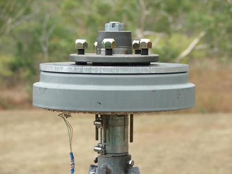

Hi Nigel,
I have posted this picture before and it shows how to support the plastic F&P rotor to keep it stable on a stub axle.
The rotor will still distort if it is not in operation, or left lying on its side or if not strongly supported.
In the picture it is screwed to a thick alloy plate which in turn is bolted to the wheel hub. Even then if it is not spun for a period of time occasionly then re- centering is needed.
Prof

I got my new rotor yesterday, and proceeded to chop the center out.
The differences between the rotors is quite obvious:
I sat the hub on the rotor, and marked out where I had to cut out:
Predrilled, checked, then drilled the rest
Then gently, with the jigsaw, knawed away at the remaining material.
Unfortunately, there's 6 studs on my wheel plate, and 10 reinforcing ribs on the F&P rotor, causing two ribs to sit up on the back of the studs.
So, out with the file, and put notches in two ribs(opposite sides for balance) to cater for the back of the studs.
Now, it sits nice and flush
Here's how it fits together at the moment - just need to fix the rotor to the wheel plate
See the hires images here
