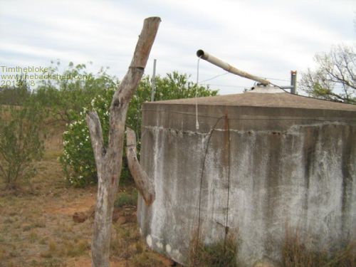

The storm damaged hundreds of trees on our farm, breaching fences in dozens of places. Cattle were scattered and mixed up with other herds. A lightning strike started a bushfire which burnt much pasture but was noticed, fought and put out by neighbours. Several nearby (couple of kilometers) buildings lost roof sheeting and or collapsed.
We got off lightly, with the windmill down, some water into the house and furniture blown off the verandah - still not found it all yet.

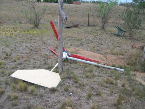

Anyway, the windmill was down:

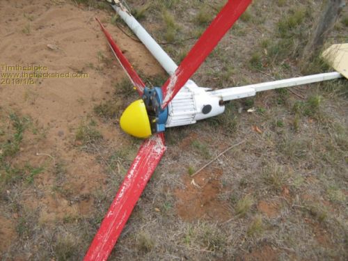

The blades were well and truly broken. White on the fibreglass blades shows where they have folded:

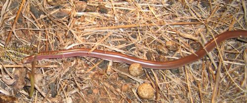

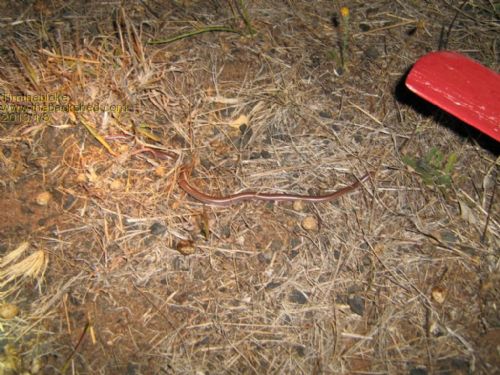

While I was looking I noticed a small (ten inches long) snake there at my feet:
I love seeing the wildlife on the farm.
Although mostly pink it was probably a baby brown snake. I would be interested if anyone can identify it for me:

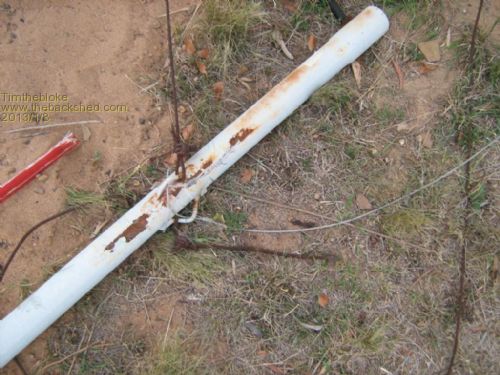

I was quite lucky in the way the tower failed. First to fail was the guy cable as per wind direction which was rusty.
This would have let the tower lean maybe 20 degrees until held by the gin pole and winch.
Then the gin cable snapped and the gin pole was twisted off the tower, letting the tower fall to 90 degrees to land on the y shaped post I have placed as a stand to hold the lowered mill for servicing. This broke to post but bounced the top tower section with the mill off the lower tower. The windmill then landed on the ground and left the lower tower above the water tank.
This staged series of failures means my tower did not mold itself to the shape of its landing and the the mill hit the ground from a final stage fall of approx 2 metres rather than approx 8 metres.
The blades are broken and unrepairable, as is the nosecone. The tower need new guy cables but otherwise is straight enough and the mill is OK except for a few dings on the cooling fins. I now have the mill back at home in my workshop and can turn it to generate voltage across each phase, so it is OK. I have a spare set of blades off an older mill which I expect I can convert to mount securely. I have a spare nosecone too. The electric wiring is OK because I have previously set it up with an in-line plug which just unplugged rather than pulling other wiring apart.
No high speed blades through our roof, no-one hurt, the watertank not damaged. So, not a total loss. This Chinese mill will have another life yet.

I will need to buy more steel cable for replacement guy cables. Does anyone out there have an opinion on galvanised versus stainless steel, besides price? Which is stronger?
Corrosion contributed to this failure. I am thinking of 4mm wire rope, attached with swages. Should I go for stainless steel over galvanised?

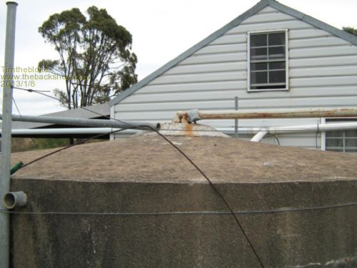

The tower was installed in 2006 and came with a Chinese windmill kit from Electus/Jaycar. The three cables which dame with the kit were galvanised wire rope but were Chinese poor quality. Other cables we used are from a roll of stainless steel balutrading rope we had available.
The cables are fixed to the lifting anchors at the base of the water tank. We installed on the water tank as a heavy anchor and to avoid the trip hazard of the guy cables. The diameter of the tank at approx 4m sets the angle of the guy cables.

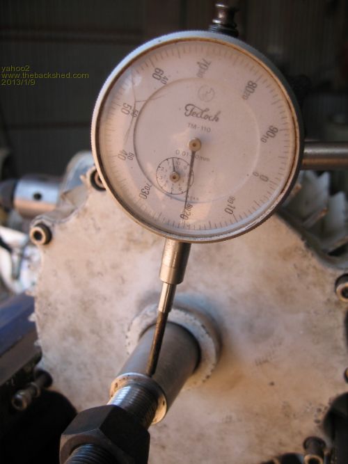

Did you get lucky and avoid a bent rotor shaft between the front bearing and the hub?
Best way to check for sure is borrow a dial gauge.

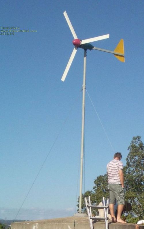

The tower is 4.5m tall and sits on top of the concrete water tank adding another 2m height. We added an acroprop inside the water tank to transfer load to the ground.
The angle of the guy ropes are approx 25 degrees from the tower so 65 degrees from the ground. Is this unusually steep?
Here is a photo of the original installation of the now dead Chinese windmill on the tower still in use.
Since this photo I have added a gin pole and secondary winching tower and extra guy ropes to control the tower during lowering and raising as it was too unstable when not vertical.

  yahoo2 said  Did you get lucky and avoid a bent rotor shaft between the front bearing and the hub? Best way to check for sure is borrow a dial gauge.
It does not seem bent but am uncertain of this. How do I test?

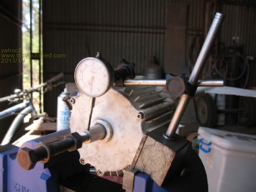

Give me a few minutes to get my boots on and I will wander down the shed and take a photo.
It will be a lot easier than explaining it.

Anyone with a lathe will have a dial gauge, best bet is to take the turbine to the dial gauge and let them do it, good dial gauges while not expensive, are treasured possessions and easily damaged.
If it is bent you can straighten it without pulling it to pieces. Mark the high side with a texta, put the hub and nut back on to protect the taper and thread and give it a swift whack with a length of hardwood. check run-out with dial gauge, repeat as necessary.

A picture is worth a thousand words, thanks. I see now how to test it. Now just to source a dial gauge with magnetic stand. I will try a friend.

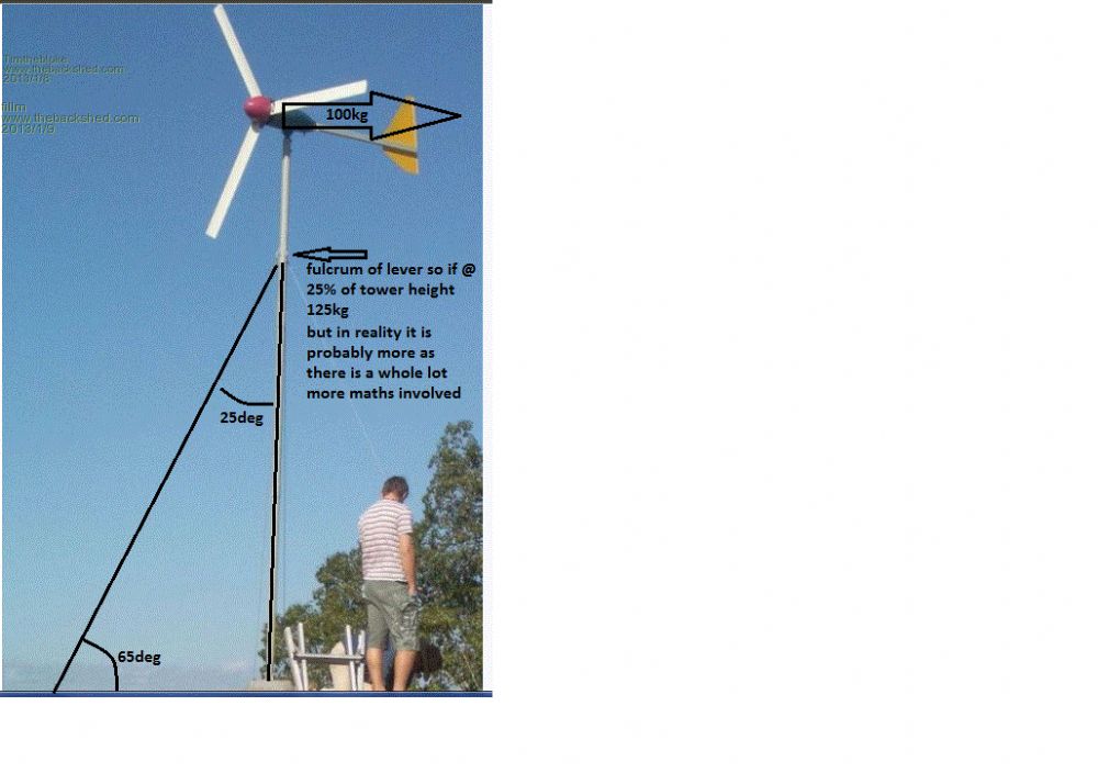

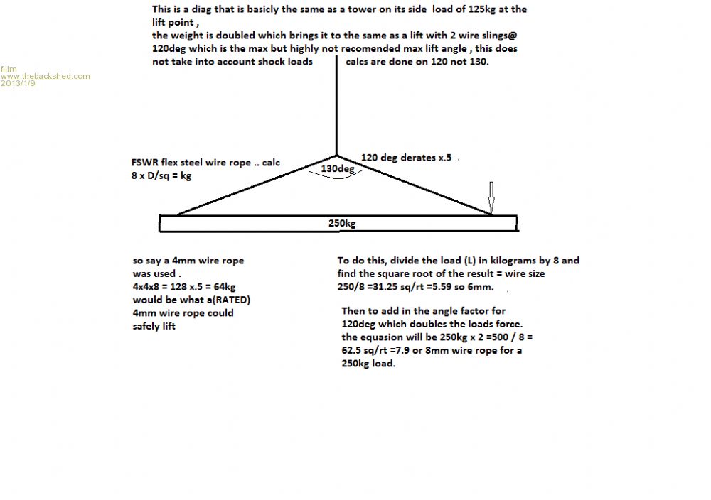

If the shaft was bent I would be surprised , anyway below is a couple of diag taken basicly from your Pic , and uses basic Doggman/Rigger maths to work out what size wire rope will be needed on a given load .
For the purpose of the calculation , I have put the windmill load at a 100Kg , as the tower is basically a big lever then at 1/2 way the load would be doubled but for this as I do not know I will guess at 125kg at the guy attachment , that might be a mistake and its 150kg .
Then this is no different that turning it on its side and lifting 250Kg with two wire slings
So if a 4mm rope was used then there's a high chance it will break , 8mm is required and that will have the safety factor .
Firstly though, a force in Kg needs to be known from blade Dia and w/s which can be worked out , you would leave furl factor completely out as it can not be relied on and it could be coming out of furl as the gust hits

Tim,
I did not say you need 8mm wire rope , I gave an example of how it can be worked out and why having your guy wires not at 30 ~ 40 deg increases the load they are trying to hold, there is a lot to lifting loads and sharp edges are not your friend , I always use thimbles and wire rope grips , at least it gives you flexibility if you need to adjust over time and stretch.
To work out thrust there is an equation HERE which is basically already done for a 2m turbine in 20m/s and gives a load of 66.6kg , but in 30ms it jumps up to 150kg . I don't know where you are and what type of wind strengths you see but 30m/s is aprox 108klm.
So then the equation would be 150 x 2 x 2 / 8 sq/rt = 8.66 , as I mentioned this will have a safety factor for safe lifting built in , from memory it is about 4 or 5x.
