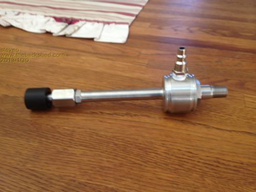

steve o
Posts: 9
Posted: 01:02pm 30 Jan 2013
Hi Guys,
The Vortex tube came in the mail today. For some reason I thought it was going to be bigger that it is. It's about 10" long and has an adjustable knob on the hot air end. Looking forward to getting out to the shop and giving it a try. Ill take some pics and let you know how it works and how much air it uses up.
Steve O

steve o
I, like Glen, am curious how well this works. I too thought it would be larger, judging from the pictures shown on the Web site you droped a link for in a previous post.
My bet is it "screams" just like the one I built back in the day. The knob on the end is nothing more than a threaded post that opens or closes the exhaust port and regulates the flow of air.
The way this thing works (I think) is, the incoming air is whirled into a vortex, which in turn re-compresses the air to make the long end hot (heat of compression) while the high-speed air at the center of the vortex forms somewhat of a vacuum. The air exiting at the center (whirling at light speed!) comes out very cold.
Were the working "fluid" a liquid (like refrigerant), the cold end would be similarly the result of expansion of a liquid in a partial vacuum. The "cold" would be derived from what is termed the "latent heat of vaporization" as a phase change from liquid to gas happens. The reaction is 'endothermic' (cold).
Whatever the reason, these things DO work well, but you might want to put your range ears (hearing protectors) on before you fire it up the first time.

steve o
Posts: 9
Posted: 08:24am 03 Feb 2013
Hi Guys,
The good side, the Vortex tube worked great The hot air comes out the side with the adjustment knob and the cold air comes out the other end. The less air you let flow out the hot end the hotter the air is. I ended up setting it in the middle of the adjustment and it worked perfectly.
I added a hose to the cold end and vented it outside only to find out that it kills the effectiveness on the hot end. Ended up putting the Vortex tube outside and pointing the hot end into the shop. This was a big help with the noise and worked out well.
The bad side, The noise is LOUD and it eats up the air much fasted then I had hoped. I started with my tank full at 175 psi. The Windcompressor was running in about 9 to 10 mph winds. After 35 minutes (forgot to check at the 30 min mark) the tank pressure was down to 105 psi. Once the tank pressure got down to about 75 psi I had to lower the amount of air coming out the hot end.
Went back out to the shop on Saturday and ran it again. Tank started at 175 psi and the wind speed was 16 to 20 mph and after an hour the tank pressure was down to 110 psi. I am amazed how fast the Vortex tube goes through air and didn't realize how loud it was until I shut it off. Over all it worked out ok for now but I'm sure there has to be a more efficient way of using the air to heat the shop.

MacGyver
Joined: 12/05/2009
Posts: 1330
Posted: 06:45pm 04 Feb 2013
steve o
The "Quote" code doesn't seem to be working, so:
Welcome to the world of inventing. The hard truth is, the amount of electricity you used to pump up all the air for use in your vortex tube (unless you actually used a wind turbine to pump things up), had it been run through a small electric heater, would likely put you way ahead on your efforts to heat your shop. I know that sucks, but that's just the way things work. I wish it were defferent, but them's the rules.
Unfortunately, in most circumstances, things are done the way they are for a good reason. The reason is, someone else has already found a better way to do things. That's not to say you should give up. Heck no; keep on tryin' mate. Every now and then someone comes up with something really cool, so don't give up.
The important thing most of the folks here on the 4m have discovered for themselves already is, even if you come up with something on your own that has already been invented back in the day, the important thing is for YOU it is an original invention. I think there's even a verse somewhere in the Bible that says, "There's nothing new under the sun" so don't dispair.
