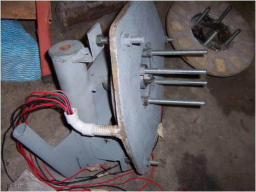

I just got some magnet discs laser cut yesterday and have started to build a piggot turbine Has any one tried one of these??? any hints or observations would be helpful. I already have a trailer hub and the magnets.This my first atempt at building a turbine so I will post progress and results as time allows.Thanks for any input Mick.

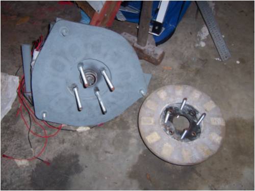

Have started the work, magnets are glued to the discs ready for casting in glass, have cut out the stator mould and made the gig for winding the coils next job is to buy the wire and wind the coils then I might do all the glass work at the same time

Just broke the stator out of the mould am very happy with the result after a bit of worry last night,did you make it from scratch as per the book any problems you had let me know,next step is to find the steel and start cutting and welding Mick

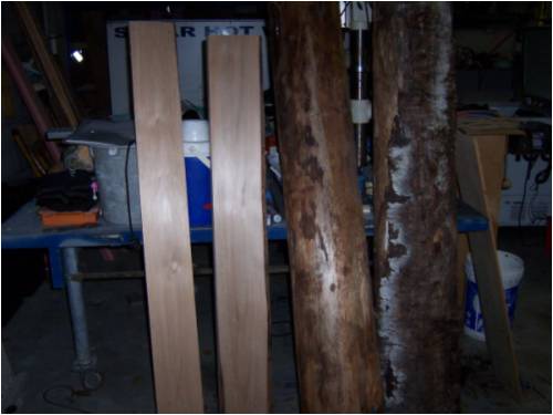

Posted: 08:48am 15 Jul 2008
OK so far the turbine is made except for the tail but thats no big deal the timber for the blades was bought from the australian timber traders in mossman Photo shows before and after all this timber is normally left to rot so I got 6 pieces for $20 I am more than happy with the end result after some processing buy me after work today. Wish I had more time to spend on this but like everyone work comes first.Next step is to carve the blades.should spend more time working on the progect instead of in the back shed but you know how it is ,more to come soon Mick
Every day the sun shines
& gravity sucks= free energy.

Great work Mick. Have fun with those blades. The timbers looks good. From the pic I'm guessing you've dressed two down from the rough, like those on the right. Stick with it, Rome wasn't built in a day either.
Cheers Gill _Cairns, FNQ

Put locktight or locking nuts on all points, particually the stator, when you do your final assembly. We came unstuck once when the stator nuts vibrated loose and the stator rubbed on one magnetic rotor.
We use two steel discs to sandwitch and mount the blades, then nuts either side, allows easy tracking.

I don't use split pins, but I do use Loktite removable thread lock compound. Or lately, I have found cheap lady's fingernail polish works just as well. You can buff off the remnants of it with a wire brush. Be sure to get the nuts snug against the fiberglass stator. Too tight might cause cracks, then filthy words.
Seven of my units have been based on Hugh's design. They are very sturdy and will perform well if made by the plans. However, if the blades become unbalanced, as with any generator, you will be glad you took the extra time to use thread locker or split pins.
