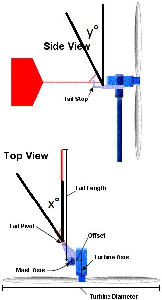

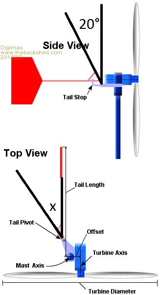

Posted: 05:36pm 01 Mar 2013
Here's an image illustrating my question. What is the angle x?
yahoo2
Joined: 05/04/2011
Posts: 1166
Posted: 08:22pm 01 Mar 2013
No, looking at the side view should be 45 degrees not 20 degrees.
The other angle would be looking from the back or front, the tail pivot post will be leaning away from the tower mast 20 degrees from vertical.

Posted: 07:44am 02 Mar 2013
Thanks Pete, I had looked at that post as well but was still confused by which angles Phil was referring to.
Just for clarity, could someone fill in the values for x and y in this image?

Posted: 03:29pm 02 Mar 2013
Y = layback angle (about 2 degrees)
X = side angle (about 12-15 degrees)
