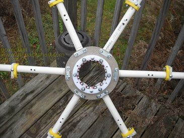

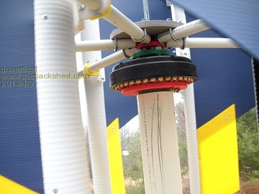

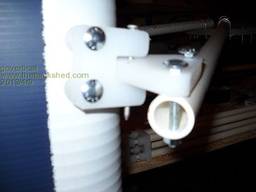

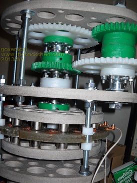

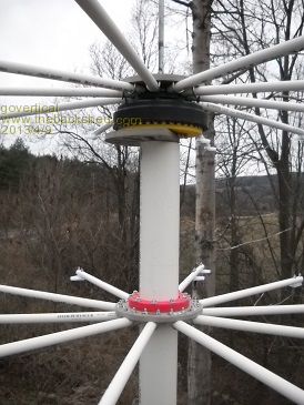

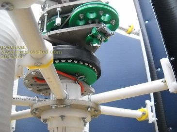

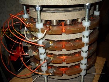

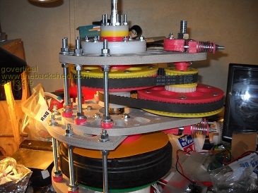

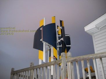

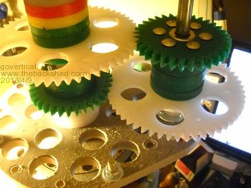

Hi, I am working on a similar project. Just some photos of my gear drive.
The link will tell you about how much power you can generate for a set size blades and at what windspeed. A 4x8 foot VAWT should produce about 5 amps at 10 MPH using a 12 volt battery as a test load.. You may need a power conversion circuit to prevent turbine stall. I have been testing with a modified F&P. I plan to operate more than one VAWT in parallel. I am working on the control circuitry now. I am still testing, good luck with your project and I hope to see some more photos.
just because your a GURU or forum administer does not mean your always correct :)

you have put allot of time into yours just form looking at the pictures nice work. and that link is awesome Mine is smaller its just meant to be a test to see what type of performance I can expect over a several month period before building something bigger but that link you provide will be a handy thing for estimating .
What thickness material are you using to cut those polymer gears out off and aren't you concerned with melting/heating up the teeth in a higher wind situation?
I see your using larger gears like warp mentioned earlier what did you end up with for a final drive ratio on yours?

Hi, does 10 amps at 12 MPH sound better? It depends on your average wind speed. I have been doing a lot of experimention over the past few years. Because I am using a modified F&P I am using a drag style blade; J shape; It is easy to fabricate and low cost. It took a while to find the design that would work with the F&P that I could fabricate. A air core axial flux PMA would work better with lift style blades, but the F&P is low cost and saves a lot of fabrication man hours. Lift or drag blades the amount of power that can be generated is still determined blade size and wind speed.
Lost power at the stator adds a lot confusion. Adding a power conversion circuit or MPPT makes a big differance.
MPPT Video
The names and hardware used is not important, the info at 1 min 20 sec is:)
I have tested V belts, timing belts, and gears drives. Gears are the easiest for me to fabricate that are low cost and over heating is not a problem. I make the gears from plastic kitchen cutting boards, again low cost. 1 to 3 is a good ratio. Starts spinning at 3 MPH. I am not able to fabricate a large diameter PMA.
Using a large diameter mast bearing allows for larger blades to be used and really helps provide stability.
I live in a low wind area, which is why I am planning to operate more than one VAWT in parallel.
There is a lot of misleading info about VAWTs. But the technology and information is changing. I did not intend to take over the thread and I hope my suggestions help.
