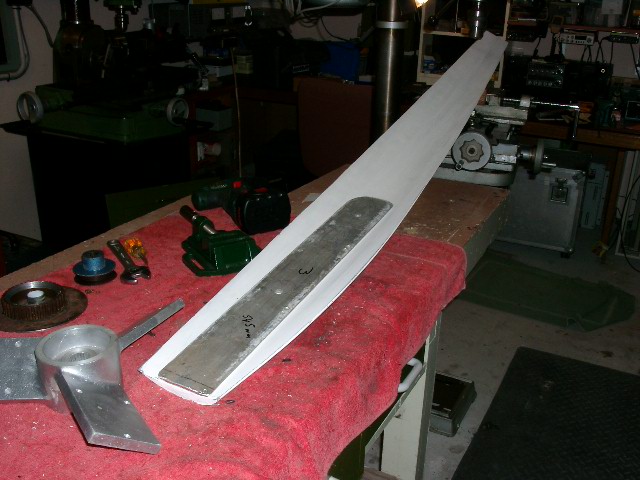

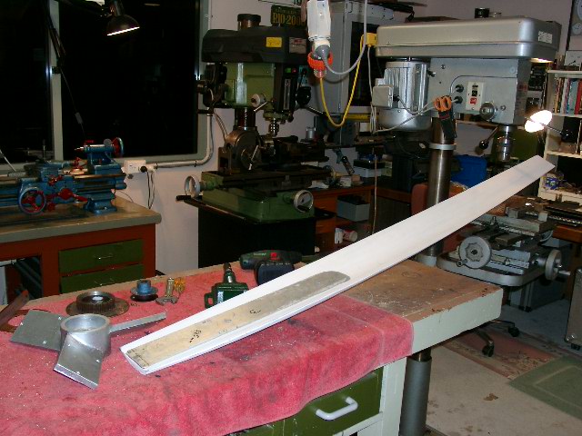

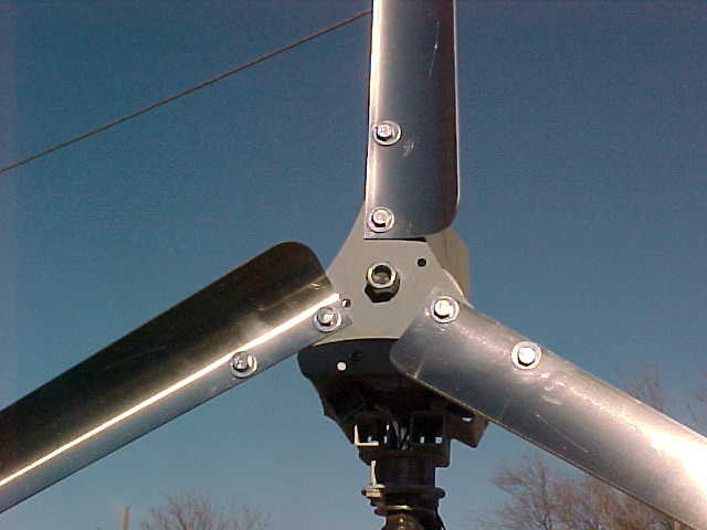

Well, I'm just about ready to align and attach these beauties to Trev's cast hub which slides onto the F&P shaft .
I've made up a profiled Aluminium 'stiffener" to rest along the front inside of the curve. Will ,maybe, fill this 'hollow' with foamfill and skim it with bog,
Thr blades are 1700mm and the stiffener is 500mm.
These are big blades and lots of hard work to get them perfect,have them within 20 gramms of each other,the raw abs blades,can get them perfect by shaving a little Aluminium off.
That carbide tipped 100mm angle grinder disc shaves Aluminium very easy. For those of you that don't have much experience with hand tools--these disc's are bloody dangerous,please be very careful. Wear all the protective clothing you can get.

G'Day Bruce
Great looking blades! Love the idea of the aluminium stiffeners.

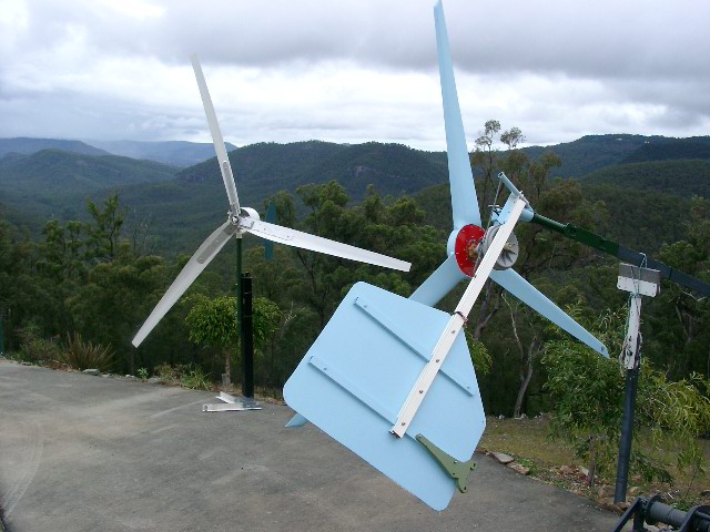

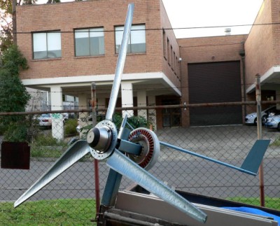

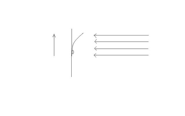

I finally finished the prototype - see attached - sorry about the confusing background. On this one, the blades are bolted to an old clutch plate that happens to have a splined centre that fits the FP shaft The second unit - also with UPVC blades is coming along nicely but it will have an alternative way of mounting the blades - details later.
I'm also making a third unit for my place south of Oberon - noted for being one of the coldest places in Australia - so instead of UPVC which becomes brittle at sub-zero temperatures, this one will have aluminium blades.
We are still experimenting with silicon controller/rectifiers. The objective is to run AC from the vane the 20 metres to where the batteries are located and put the rectifier/controller with the latter. This will largely eliminate the problem of voltage drop that would occur if the rectifier was at the vane end
Alan
Bushman
Joined: 24/04/2007
Posts: 41
Posted: 10:51pm 16 Jun 2007
Comments about the prototype in the picture above would be welcome. For example:
Does the tailfin look large enough? It would be simple to add a second fin underneath
Having seen Bruce's blade stiffeners, how about adding some shaped stiffeners to mine? - pop-riveted to the blades and to the clutch plate.
How about longer blades? these are 750 mm. meaning a total diameter of about 1800 mm

Posted: 12:03am 17 Jun 2007
Hi All
Three comments on the above blades.
First ,Is the total capture or working area in excess of .5 a square metre. If it is not it will not run a F @ P.
Second You have sharpened the front of the leading edge when it should be the back side.
Third If possible make your mounting so that the leading edge is aligned to the centre of the shaft. . This will make the blades run quieter smoother and more efficiently although it is harder to make.
Keep up the good work Regards Dennis L
Bushman
Joined: 24/04/2007
Posts: 41
Posted: 03:10am 17 Jun 2007
Thanks Dennis
Appreciate your comments but I'm not sure they are accurate. Actually, it IS the trailing edge that is "sharpened" - the leading edge has a pencil-round profile. Also, the leading edge IS the one aligned with the centre.
You may be saying that the blades are oriented the wrong way and you may be right. I could not find any useful information on this topic, but every illustration I saw had the leading edge the way mine is built, so looking from the front, the mill turns anticlockwise. Here are a couple of examples:
Gill
Joined: 11/11/2006
Posts: 669
Posted: 09:12am 17 Jun 2007
MMmmmm! Nice work Bushman.
Have to agree with the 3 points made by Dennis though. Sorry, yours and the 2 examples are clockwise rotation.
As for the Tail, I'm an advocate for a largish tail, I'd go at least 4 times your area.
My reasoning is that on a furling windmill the force on the blades must be counterbalanced by the force on the tail. This is expressed by anticlockwise moment (force * distance about the yaw bearing) equalling clockwise moment(ditto).
So in your case, to get a force on the tail large enough to counterbalance that on the prop, the tail will have to swing to at least 45deg (probably more) into the wind. That puts your prop at 45deg (or more) out of the wind, and this is not even furling yet.
Still after all that great work I'd increase the tail size and stuff the back-to-front blade shape, then give it a run anyway.
