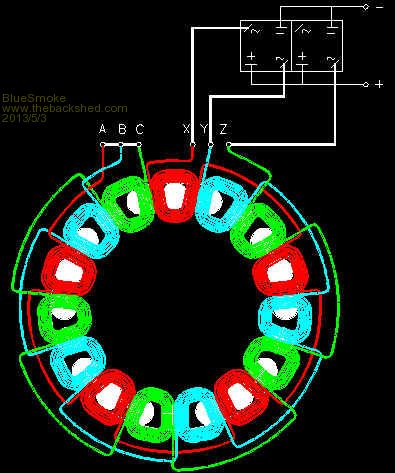

Each rotor will have 20 magnets (20 polls).
Rotor backing plates are go-kart sprockets (60 tooth) so are about 7.25" dia. This places the 20 neos centered on a ~6.5" circle on each rotor. Magnets epoxied to plate and resin ring cast around them to hold them in place.
Stator will have 15 coils (5 coils per each of 3 phases). Coils will be trapezoidal with an average I.D. of 3/4" and an O.D. of 1-1/2" (width and height), 20AWG @ 70 turns each. (That's the max. I have room for).
Coils will be cast in resin forming the stator (about 3/8" thick) which will be sandwiched between the two rotors. Stator will be approx. 9.25" diameter.
I've started winding the coils (10 of 15 so far) and, so far, have one rotor with magnets epoxied ... still a long way to go.
Hub and rotors will be held together using 6 bolts on a 3.25" bolt circle and the stator will be mounted to a piece of 1/4" thick plate steel using 3ea. threaded rods.
This will insure I can adjust the stator location relative to rotors and distance between rotors to control the air gap. Air gap will be as small as possible, probably about 1mm.
Rotors and hub will rotate with a 5/8" diameter shaft mounted to the plate steel with 2 bearings housed in pipe (welded) to the plate.
Blades will be some Air-X type blades (60" diameter windswept area). I'll try 3 blades first but have 3 more if I want to add them later to capture low winds.
Yaw bearing will be a piece of greased pipe over pipe pole.
Tail will be mounted with hinge, angled to allow furl.
Haven't tested a coil yet (only one rotor so far) but as I get things assembled I'll test one coil and extrapolate to see if I possibly have a chance to hit 14V or if I'm shootin' blanks.

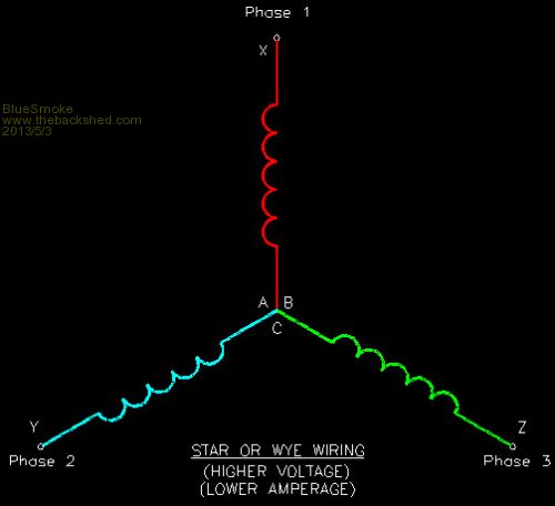

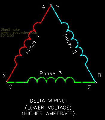

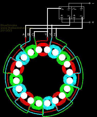

Below are diagrams of my stator wiring. (Star, Star Wiring Connections, Delta and Delta Wiring Connections)
I will have 6 connection points, each an end of 5 coils in series, per phase.
This will allow me to set up as Star or Delta configuration and test each phase for resistance, voltage amps etc.
Star - Phase1, Phase2 and Phase3 w/Connection Points
Delta - Phase1, Phase2 and Phase3 w/Connection Points
I guess if there were a question here, it would be:
Do you think I have a chance of producing enough voltage to charge a 12V battery with this setup?(100-150 RPM)
(Only testing will tell but I'm curious what others might guess).
Thanks for your interest.

I don't see why it wont work , I would not worry about the Trapezoid coils with round magnets ,and just use round former's , you are adding extra coil resistance for very little gain .
Best advice is to get it up to a stage where you can test coils , and all will be revealed then , I would drop the star / delta switch , star will give you the best performance for the least resistance .

As Phill said you are really going about this build backwards.
You need to setup the magnet rotors and test a coil before just winding wire to a turn count you pulled out of ..... Errr, thin air.
My guess is 70 turns will give over 40 volts (volts are easy to make) at 100-150 rpm, but its the Amp's you need to produce at the required voltage.
Volts come from the number of turns per coil, Amps come from the wire size used, so i would expect you could use around 3 times less turns per coil and 3 times the wire strands per turn, to give a lower voltage output to suit your 12v battery and 3 times the current.
Again that is just a guess and hence the need to test a coil to see, the idea is to get the turn count right to suit the mill voltage intended for a given cutin speed, then fill the room allowed for each coil with as much copper as you can fit in.
70 turns might give you a low cutin speed of 30-40 rpm for a 12v battery and i doubt the mill would ever get out of stall to actually make useful power with Air-X blades with such a low cutin speed.

For testing purposes, using Star wiring, to produce 14VDC, I need to figure the following: (I'll lose a little through rectification but hopefully this should get me in the ball park).
14VAC / 1.73 = 8.09 VAC per phase of EMF needed
8.09VAC / 5 coils per phase = 1.62 VAC per coil needed at desired RPM

Connecting the windings in closed loop delta will certainly work, but it is less than ideal.
One way to run in delta without the problems of harmonic circulating currents would be to bring out all six wires without any interconnections on the ac side.
Then connect each winding to it's own individual bridge rectifier.
You then parallel up the three bridge rectifier outputs on the dc side.
This works exactly like the traditional delta connection, and it gives the same output voltage and current. Only difference is, each winding works quite independently on the ac side, and any waveform distortion no longer matters.

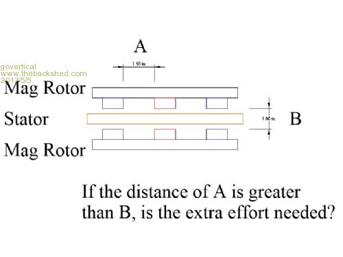

Hi, does having the magnets so tightly packed together cause a problem? Would it decrease the lines of flux passing through the coils? Edited by govertical 2013-05-06

BlueSmoke
Joined: 02/05/2013
Posts: 25
Posted: 01:26pm 05 May 2013
Hello GV,
My thought here is that more rapid polarity changes per revolution are a good thing here, (especially at lower RPMs which are generally my target with this mini mill).
Don't really know if flux paths will interfere with each other due to relatively close proximity, as in this configuration, but these are pretty small neo's so I would think it will not be a big problem.
Currently getting the rotors dialed-in and testing a few different coils is my goal.
I made a new blade hub plate today which seems to align well (concentrically) with the rotors. Now it's just a matter of getting a stable coil testing arm in place to see if I can reach my goals (re: 14VDC with usable amperage to trickle charge a 12V battery).
The question that you pose is not really something that I could ever test but I do know that others have made 20 pole rotors with a degree of success. I think having the coils well matched to the magnet array and taking the best advantage of the space available is what is important.
Not really sure what you mean by "is the extra effort needed?" ... which extra effort are you referring to?

govertical
Joined: 11/12/2008
Posts: 383
Posted: 12:15am 06 May 2013
Hi, if the distance between the magnets on the same rotor is less than the air gap between magnet rotors, is there a decrease of lines of flux passing through the coils?

BlueSmoke
Joined: 02/05/2013
Posts: 25
Posted: 07:32am 06 May 2013
Hi GV,
Ok, I see what you are saying ... what type of data or literature do you have supporting this relationship of distances? I've never read anything published regarding this particular relationship.
I would have to guess that it would depend on many factors (rather than just the two dimensions). (e.g. magnet size, overall shape, cross section profile, thickness, strength, backing plates used ... etc.). Since the magnets are polarized top & bottom (N&S) rather than side faces it would seem to me that these faces (N&S) would be dominant and interact more closely with (S&N) on the adjacent rotor as long as distance A and B do not differ a great deal. (On my setup, distances A & B look to be within a mm or two of each other) so I won't be losing any sleep over it here, but ...
... if the relationship of distances A & B is of great concern then I would wonder why Pie shaped magnets that actually touch side to side (where A = 0) are often used on axial flux rotors with great success.
It would be interesting to know more but with this humble build it's really a mute point for me since I already have two rotors mounted with magnets epoxied to their backing plates. I'll certainly be keeping my air gap as small as possible, however.

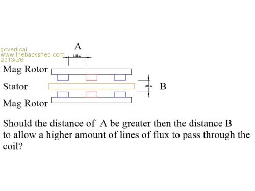

govertical
Joined: 11/12/2008
Posts: 383
Posted: 10:53am 06 May 2013
http://www.femm.info/wiki/HomePage
Finite Element Method Magnetics allows you run simulations by spacing magnets and changing air gap.
On my own project I increased distance "A" to be greater than distance "B" and noticed a improvement.
I understand it is mute point now that you have fabricated your rotors, but I was curious if anyone had a similar experience. I look forward to your results.
