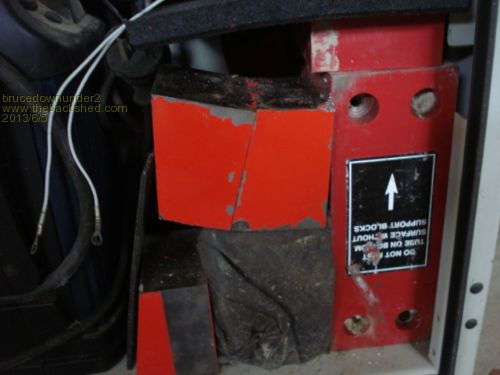

I think I've visited this subject years ago ,,but here goes , anyhow.
I have around 8 of these very powerful magnets ,,they are a shiny bright steel looking composition ,they seem to resist any rust over the last 10 years..
They are about the size of half a house brick -very powerful and may I add dangerous to handle ,,I use Two sets of long sleeve leather gloves and safety glasses.
I would like to cut them into say matchbox or cigarette box size.
Anybody out there with this sort of experience or know of a specialists factory that would do the cutting .. Do you think they may be magnetized AFTER the steel composition is machined?. and therefore, now impossible to re-machine,(cut).
These are very powerful magnets ,,no way can you pull them apart,,I have to slide them away from each other with lots of care ..
have thought about cutting discs, they won't look at them and the attactraction of swaft would block up the cutting disc.

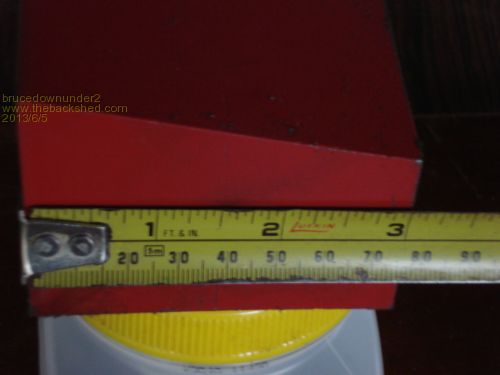

I took some Pics yesterday ,.
I was thinking I could have these cut into fairly large square magnets ,,say, around 75mm square by 25mm thick -I'd get round 36 magnets ..
The holes in the magnets are fairly rough sort of as if they were put in during the mould filling process,,not a smooth drilled hole that a drilling operation would achieve. The two magnetic faces are very smooth "chrome" like surfaces.. If you attach one of these surfaces to a steel surface ,you CANNOT pull them apart by hand.
