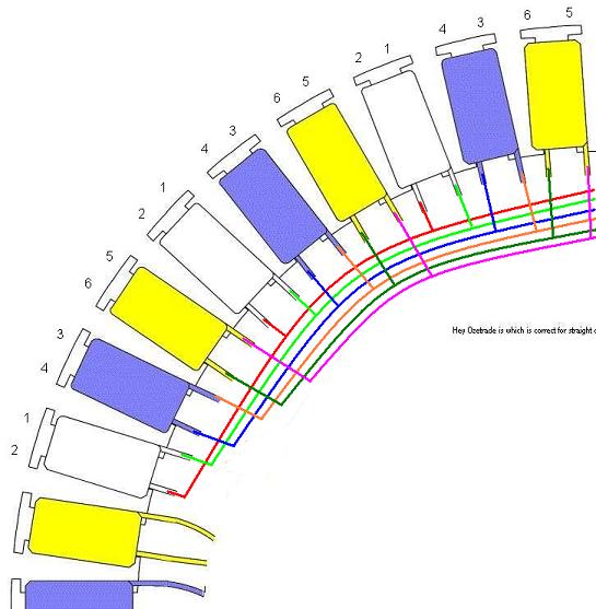

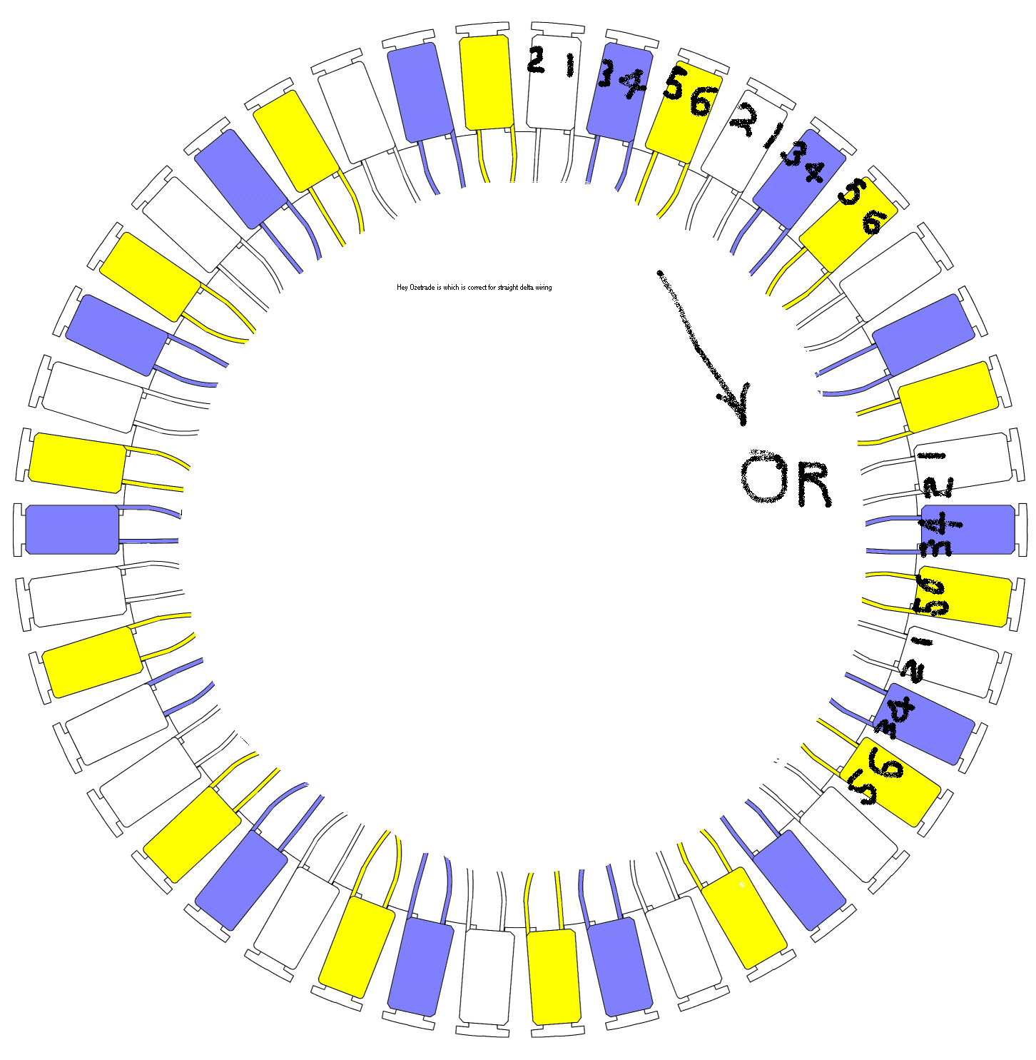

Recently you replied on this forum re delta wiring of an F & P i have just done a scetch of what i think you said, but not sure which wiring is correct top or bottom
Bob
Bob from Murray Bridge, SA

Not quiet right - try this
Greg

Greg, that looks to me like each phase is 14 coils in parallel, does that produce a useful volage at moderate revs?
I understood the practical configuration was each phase wired to be seven paralled pairs of series connected coils?

  KiwiJohn said
Greg, that looks to me like each phase is 14 coils in parallel, does that produce a useful voltage at moderate revs?
I understood the practical configuration was each phase wired to be seven paralleled pairs of series connected coils?
Actually Bob, John is right. What I have described is a parallel circuit - but the term "delta" is referring to a parallel circuit, there are several ways to configure a parallel circuit. The method I described starts producing current at around 450rpm, 600+rpm before you start getting a useful current - 600W @ 800rpm for and 80series.
Another method is much simpler and starts giving a useful voltage at around 300rpm up to around 500W @ 1000rpm.
The method is:
  • Free all six wires at the termination points.
  • label each wire 1 - 6 in a clockwise direction.
  • connect wires 1 & 5
  • connect wires 2 & 6
  • connect wires 3 & 4
However, the method that Glenn gives for rewiring star/delta is probably the most practical and versatile an efficient. His method can take adavantage of a star/delta switch that switches between the to modes. This way you can take advantage of low rpm to produce power in star mode, then auto switch to delta for high rpm efficeincy.
Basically, if your expect to operate at low rpm most of the time, you should choose a star circuit. If you expect to have high rpm available to you most of the time, choose a delta/parallel circuit.

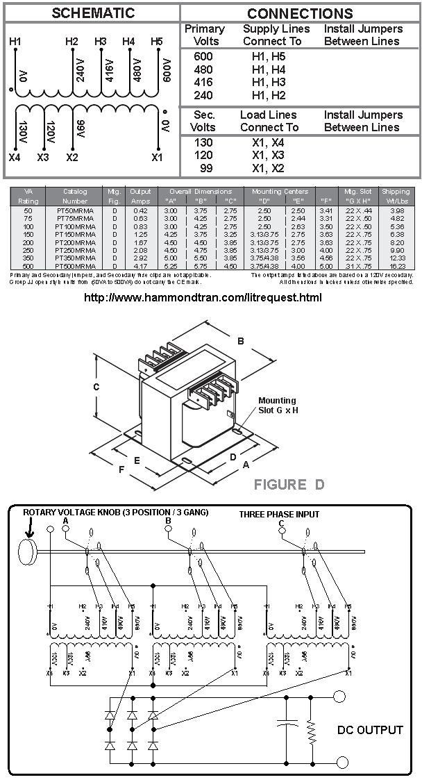

Bob, of course you can rectify 500 volts but you are getting deep into the realms of sudden death for the unwary!  I say this because any practical rectification scheme involves the use of capacitors and capacitors are stored energy.
If you could bring the three wires down from the alternator to ground level it may be practical to use transformers to drop that to a useful voltage.  Whatever ratio you divide the volts by the amps, potentially, go up by the same ratio.
Using high voltage AC leads from the tower saves you in resistance losses too as resistence loss is related to current (i.e. amps).
I dont know what RPM you would be dealing with to get your 500 volts but pretty high I expect.  High RPM means high frequency (i.e. Hertz, cycles per second).  Most mains transformers you will come across are designed for 50Hz except US and other countries which are designed for 60Hz.   As a general rule low frequency is very bad for transformers because they get hot instead of doing their job.  So although an increase in frequency may be a good thing increasing it as much as you would may be too much for 'standard' transformers, something I dont really know.
My only F&P rig is on a bicycle which produces 100 volts rectified DC from an un-modified stator wired in star configuration.  This is with two stages of chain gearing and spinning at 430 RPM.   I worked out the speed by measuring the frequency, which is 200Hertz and counting the magnet poles in the rotor (28 pairs).
If I remove the rectifier and put a 230/32 volt transformer across one phase I can light two 50 watts 12 volt  light bulbs.  100 watts at 12 or so volts!
From my experiments I tend to believe that the modification of the stator is not necessary and may even be counter productive if suitable transformers are available.  For a full system you need three transformers.
I would have to think some more on the subject before I could positively recommend transformers rather then stator modifications but I do think it is at least worth considering especially if the leads from the generator to the battery charging position are long.

KiwiJohn is right about the problems with using a unmodified stator and step down transformers, its not very efficient, and there is a safety risk with those high voltages. Just adding my little bit, the F&P can generate over 800 volts if spun fast enough. Normal 240v wire insulation is rated to 1000 volts, but a tiny pin hole or crack in the insulation will cause a flash over. These voltages are lethal, a F&P can produce enough power to easily kill you. Also the insulation in most 240v transformers is rated at 500v max, so these will quickly fail.
So for these reasons its best to rewire the stator to a safe working voltage. I would rather have a couple of expensive thick wires running from the windmill to the shed, feeding a harmless 14+ volts, than a thin 240v lead feeding 500+ volts. Especially with the way I tend to run over these things with the mower!

You could use three small high voltage stepdown transformers that have multiple voltage taps and connect them up to a rotary position three gang switch and rectifiy their output through a six diode bridge and filter it with a capacitor and a 47K ohm discharge resistor. This will allow you to experiment with various voltages.
Cation: if you select the low voltage position There will be a lethal voltage on the higher input taps. Be very carful.
