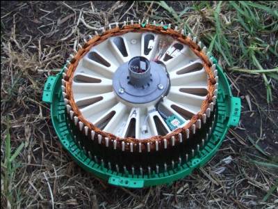

Dennis phoned this afternoon, he's found a new type of motor from a domestic appliance that looks like it may give the F&P a run for its money. He sent these photos throught tonight.
Dennis has found heaps of these motors, the 500 watt model, but they are due to be crushed in the next day or two. However they can be bought for $20 to $25 each, so Dennis is after expressions of interrest. He said he can get the motors put aside hopefully, but anyone who wants one needs to contact him. His home number is 08 838 21658 ( SA, Australia callers only, take into account the time difference ). Or email dlatham@chariot.net.au
The motor looks like a air core design, no lamination poles, and therefore no cogging. The stator is 100mm high ( 4 inch ), each magnet seen in the hub is 58 * 42 * 10mm.
If your interrested in buying a few, give Dennis a call before Lunch time tomorrow ( Friday 18th May ). I dont know anything about this motor, but it looks real good, might make a great windmill alternator.

Hi Glenn Please use this dialog on your site as you see fit. Apart from F and P and L.G. stepper motors that are suited to conversion are not commonly available. The Seeley Stepper motors are a big step up from what we are already doing being available with seven different output options. They should be tops for high torque slower moving blades. They will be absolutely useless with lightweight faster moving blades
Working on a building sites and playing around a bit I put a screwdriver against many motors ( Mostly Wrecks ) why they were stationary to see if I could scrounge magnets as I was interested in them.( The Magnets) The Seeley Air conditioner had these and I thought no more about it. About 3 years ago I revisited my memory of this as I had become involved in the F and P thing.
Of course the GURUS would have known about this for many years but never put it out. (AS IF) The Seeley Assembly plant is only 10 minutes away so a visit
was in order This happened at the above time and I tried a few times and then got an appointment to look at there facility. It was all protective gear with no cameras and no you cannot handle one or see inside it. (The Motor) It was very Hush Hush .They also said you need to know you will never see them at other places as they are all returned to this factory for rebuilding. DAMM DAMM.
Keeping my nose on the job I got wind on Wednesday (No pun Intended) that there was 4 of the above at a machinery ware house some hour away and they said $20 to $25 each. I nearly needed a police escort to get there. On buying them today (Thursday morning) I was told that they had another 100 or so coming in later in the day. (BINGO BIG TIME) They also said they would be
put through the metal crusher almost straight away as they needed the room. I have delayed them a little but I will have act quickly to stop this happening. With a little sweet talk I hope to allow time for people to
contact me ASAP to let them get some of these Stepper Motors too.

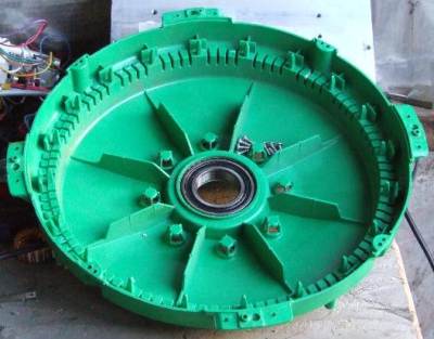

Apart from the information with the photos you will need to have strong tower with as mentioned above plenty of torque at low speed. They mount on a round 40mm (aprox) pipe which goes right thru the unit and will be excellent for the tail and fixing to your tower.
They have an overall diameter of 370mm by 160mm thick and weigh in at 10 kg. The F and Ps weigh 7kg.
They have 2 outer plastic sides which are easily
pulled apart. They are not waterproof. All models look the same from the outside.
The magnets are loose as the as they are held in place by the dividing posts. They would be dead simple to change.

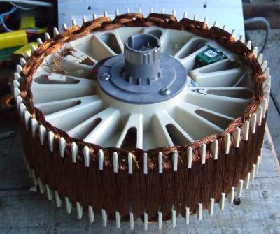

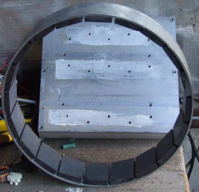

The 20 magnets are 58mm high by 42 mm wide and 10mm thick being north and south facing side by side. The removable outer steel ring is heavy duty and much better than F and P. This set up nearly falls together.
The 60 coils are 100mm long and overlap adjacent coils not unlike a regular motor. (Not like F and P) There is twice as much wire used with it being the same wire diameter as the 80 series. They are 3 phase Star with the delta ends being easily accessed. They obviously can be reconfigured but it is very early days for this.
At this very early stage I have not run one. When turning a Model 500 manually there is no cogging (NO COGGING). It feels like a slightly tight bearing but is as smooth as. Yet to see how it fluxes?
They state they are extremely quiet. Have not heard them yet. The larger output units have NEOS.
IN CLOSING ALTHOUGH NOT TESTED and considering the price the SEELEY STEPPER MOTORS LOOK EXTREMELY PROMISING. A Regular F and P as a Washing Machine uses
165 watts and the smaller Seeleys use 500 watts as Air Conditioners.
This may be our only opportunity to get into this one. It of course opens up another can of worms but that is what this project is all about. I will be into this up to my armpits. Postage may cost as much or more than the cost of these units. IT IS NOW UP TO YOU.
REGARDS DENNIS LATHAM

Great looking machine - do the connecting cables feed down the shaft? Do I take it that some coils span 3 pegs and other coils span only 2? See the Seeley home pages for some pics of these motors inside the fans they drive.

Hi All Some more info. Since I am stripping ,cleaning, rebuilding and checking the electrics I have found. The first 6 completed all had there cover plates busted and one had a broken wire from a loose magnet. Apart from the above and being dirty they were fine.
Here is a bit more technical stuff.The units are described as being a Brushless DC Motor. As an electric motor the 500 watt unit draws 3.5 amps which in theory should produce 840 watts as a generator with a blade capacity of about 1 HP. ( Speed / Torque ? )
The big 1500 watt draws 9.8 amps with an output of 2280 watts with a blade capacity of about 3 HP.At this stage it is still very speculative however they are serious machines and as said before will require big gutsy blades.
Some other answers. The green covers which have the magnets between them rotate around the fixed centre pipe ( not shown in photos).This long pipe will be about 43 mm with the 3 output wires going into it and out past the covers and into your rectifiers. Each of the 20 magnets spans 6 legs of 6 coils but I have not properly researched this.

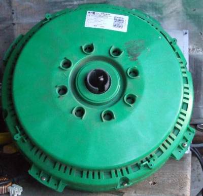

Good morning ,, was thinking about these motors last night..Something just didn't sit right,!!, anyhow I finally understand ,. They are the motors that are in thousands of those ugly brown boxes on top of house roof's--We don't see them here in Qld ,so that's why i was confused.
They are purely for driving a cylinder fan that cools the water that cools the air,(I think). ahhh, Evaporative cooling system...
No wonder there are hundreds of them in South Aust., thats the major user and manufacturing plant .
Now I know why the shaft is not available--it's also a major part of the fan ,so,if a motor needs replacing ,then the shaft stays and just the motor slides off and the new motor slides back on the existing shaft..(I think).

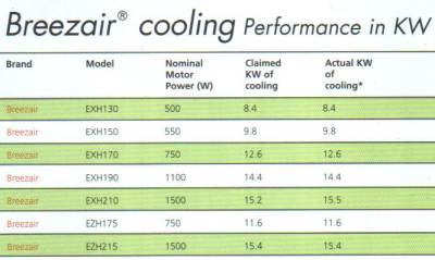

Hey guys, just found this picture, looks like the motor inside
"The incredible electronic technology and revolutionary HushPower motor mean that the Breezair Icon series can cool a whole house from as little as the cost of running a light bulb"
