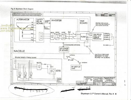

Hello to all you mill heads. I think I have a good one for you guys. About three years ago I helped my neighbor install a Southwest Wind Power Skystream 3.7m mill which sits a top of a 75 foot tower.
The mill has been down about eight months or so, fact is I know of two Skystreams that are have not turned a single rpm for some time now.
The Skystream has an on board dynamic braking system and a grid tie inverter as well, that’s right all the electronics are sitting atop the tower not the best idea I am sure! It’s a down wind design mill.
Southwest Wind Power is gone and out of business so going to them for help is out of the question
My neighbor says he’s had enough and just wants to rid of it.
When it was in operation I watched the mill operate and I believe the basic design is a good one, it’s quiet, well balanced, and is a thing of beauty.
Here is where you guys come in. I can’t help thinking that the sweet 2.2 kw slot less neo pma is got to be good for a build of some kind. My knowledge of electronics is limited so to help some of you tech savy guys I have included an schematic so you can take a look at the internal workings etc. Sorry about the quality of the picture.
I know that the mill is still a good mill and the problem falls in the electronics area. I am not concern about fixing the unit what I want (or thinking about doing) to do is by pass the electronics and just bring down the 3 phase electrons and go from there. I am hoping for some info from you guys to see if this is something that’s possible before investing and time into it?
Being that it's a down wind mill one of my biggest concerns would be braking or over speed control.
Thanks a bunch.

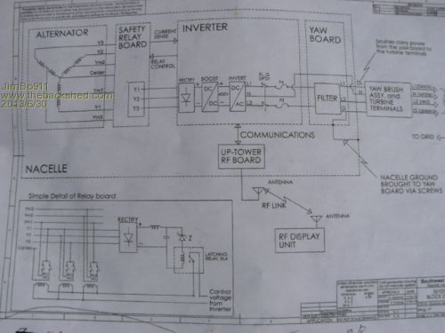

Skystream 3.7
Hoping this image is better.
Thanks again.

Are you planning to use it as a grid tie or to charge DC batteries?
I would be setting it up on a bench so you can turn it by hand. It should start to produce enough voltage to be able to see where the fault is. The fault may be in the safety relay board it may be burnt out relay contracts. If it is in the inverter it would be harder to repair. Also getting it on the bench and turn it you can get an idea of what voltages it produces from the alternator. You may be able to use it with a third party MPPT inverter or charge controller depending on how you plan to use it.

There might be nothing wrong with the mills, and just how the skystream works, i dont know what the mills are you have, but some skystreams use a system that dumps power with heaters (120 or 240VAC)and there is a built in safety in the mill head that triggers a electronic latch under certain conditions that shuts the mill down to protect it, the only way to release the latch is to lower the mill and manually reset it.(most likely the "Safety relay board")
Its been a while and i dont remember all the details now, although will find out more information, as i know someone who built a retrofit circuit to bring the heaters on earlier to stop the mill from latching up early in certain conditions.

I found out a bit more information, and the first question to ask is ...when the cover of the narcell is removed is there any burnt smell, as they have a habit of burning up the circuit.
If no burnt smell... then it might be still all working.
The relay latch is there to protect the mill and once latched it holds a dead short across the 3 phases, skystreams answer was to supply a new relay board, but the relays can be unlatched with applying 48vdc to a pair of pins, although polarity must be correct.
Its a crap design needing the mill to be lowered and the narcell opened to reset the relays.
To change the mill and remove the inverter and controls from the top of the mill is not so easy as they are designed to put grid voltage down from the mill, and things like slip rings wont handle DCV at high amps or 3 phase AC, as im told they are only a carbon track type slip ring.
The skystream is a noisy mill and they howl or whine something terrible .
Gordon is the person who has worked on these mills not me, so information is only what i remember from his experience with them, i know he developed a circuit that allowed the relays to be reset from the ground by disconnecting the mains power to the mill and reconnecting it again would activate the circuit to reset the relays, without disabling the relay latch protection.
If the mill is not burnt out in the circuit then perhaps i can put you in direct contact with Gordon for better advice, i can only ask for you
Pete.

By the sounds of it needing a crane to lower the mill, could well indicate the mill is latched in protect mode, and appears to be a dead mill, because there is noway to reset it from the ground.
If it was burnt out then you would expect to see it flogging around in the wind and making no power, where as latched its brakes full on and it might move slowly in light winds only.
