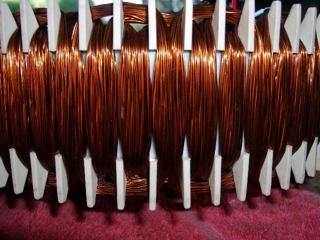

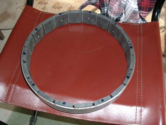

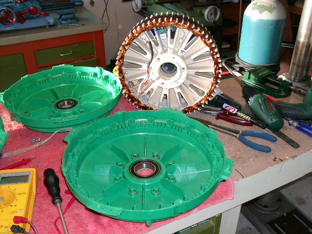

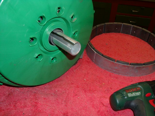

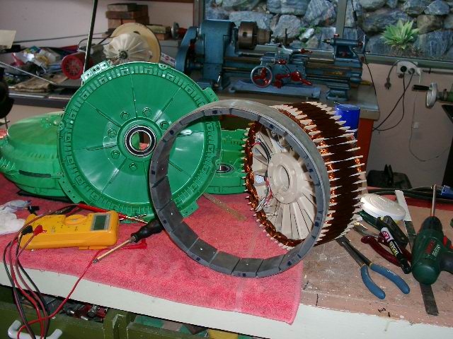

Anyhow,,,pulled one 500 watter apart and from first impressions,wow.
the magnets are huge, the windings are around the F&P .8mm size. the bearing are huge --will last our lifetime,70mmm od -42id. but one observation from experience--I'm going to remove the dust seals,as I really don't think these are needed at 50 feet and did you know they increase the friction by "heaps"..but that's my opinion..
these motors are much bigger than Fisher & paykel washing machine motors ,so be aware that you are going to need (in my opinion) much bigger blades for start-up but once they get going ,,,,well,,, who know's yet,,????
Anyhow ,, a few pic's of what I saw 1 hour after the courier delivered them ---

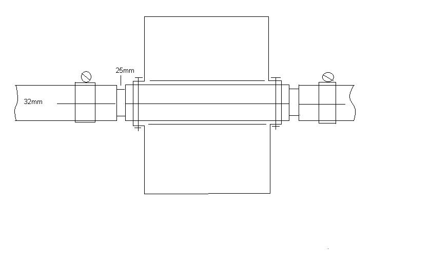

Hoping I might find a common shaft to suit the Seeley, not so, the diameter is 31mm! I checked the new steel sizes (metric and imperial) and aluminium the closest size tube I found was 32mmx3mm aluminium which I bought a short length of, I can cut it down the length then compress it with hose clamps to reduce the outside diameter to 31mm, I also bought a length of 25mm OD tube as this will fit the inside reduced 31mm tube to join it all like this
Other options I considered were;
lathing 32mm to 31 mm then adapting to a larger tube.
Lathing 31.74, 1 1/14 solid rod to 31mm with the wires onnthe outside,
Shimming 27mm steel tube using 2mm strapping,
Lastly and not sure if it's available, using 31.75 steel tubing cut down its length the same as the aluminium tube I bought then welding it or slipping something inside it depending on its thickness.

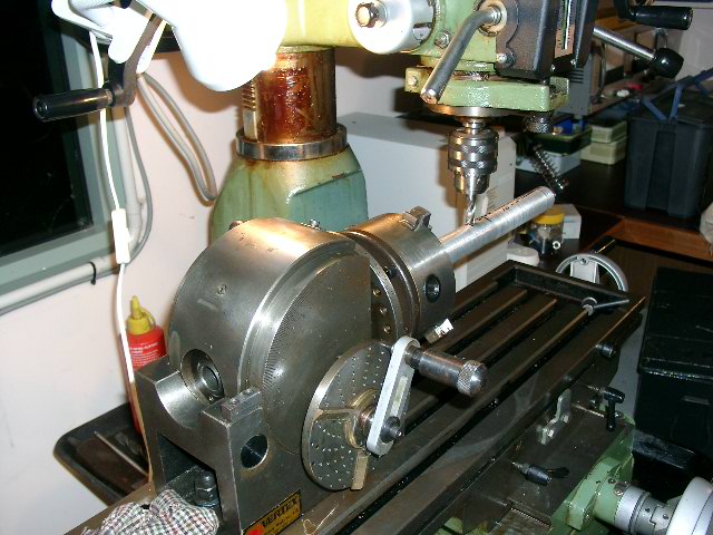

how about that ,,just came in from the workshop milling a shaft to fit the "Seeley"---
Used a piece of thick walled 32mm Aluminium ,put it in the lathe and dressed it down to a snug fit of 31mm ..
Took it across to the milling machine and am in the process of milling a slot of 10mm length-wise for the "stops' internally moulded into the flange bosses.

finished milling the shaft this morning --fitted nice and firm ..
removed the plastic seals from the 4 sides of the 2 bearings --wow , what a difference--would recommend it to u all ,,,as from my experience, you can get these bearings easy ,, and , anyhow ,, they (un-sealed) ., are going to last you many years --in my opinion.

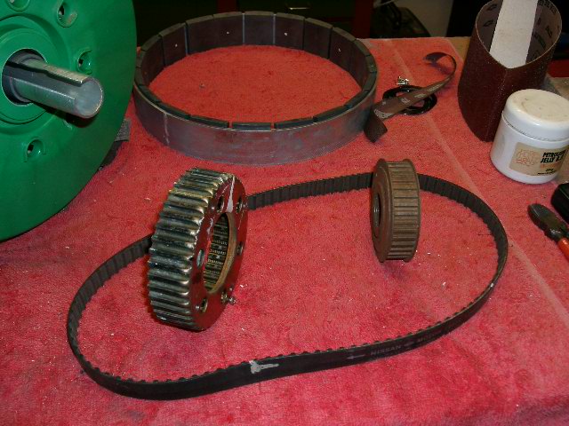

This is a pic of the timing belt and pulleys I might install.
1:1 at this stage , but could be changed..

Bruce, Is there a steel band hidden under the copper coils in the plastic ?
brucedownunder2
Joined: 14/09/2005
Posts: 1548
Posted: 07:31pm 30 May 2007
H Feral,,
Yes there is -it's fairly typical for these big diameter stators to have ,what this has, a wide binding of hard drawn steel wire coiled tightly just inside the coils to felect the power towards the magnets(I think).
This particular wire is a polished steel,very hard ,very springy not electrically connected .
Also for anybody's interest ,there appears to be some sort of speed control/sensing "thingo" (can't see it ) , that is installed between the back steel banding coils and the back of the copper coils(in between)- this terminates on a pcb that is rj45 jacked out via a cat 5 (think) cable .(this cable was just cut off when I received the motors.

Hullo All In reply to the above. From my understanding all the motors are returned to Seeleys under warrantee. Therefore you will not find them at your local tip.
As to what goes wrong with them and why are they scrapped. The green covers although strong are quiet brittle so if they are broken they get returned.
Currently I have rebuilt about 30 of the 54 I started with.
They all had busted green covers which seems to be a deliberate act to make them unservicable Aprox half of these had magnet problems. The galvanised steel ring which surrounds these magnets had welding dags which caused magnet rocking. Small pieces of magnet was also to be found amongst the larger magnets. It is realitevly easy to fix.
A more sinister problem is finding shorts between the phases. They the 7 so far cannot be seen but show up on my ohm meter during testing. They are eliminated
