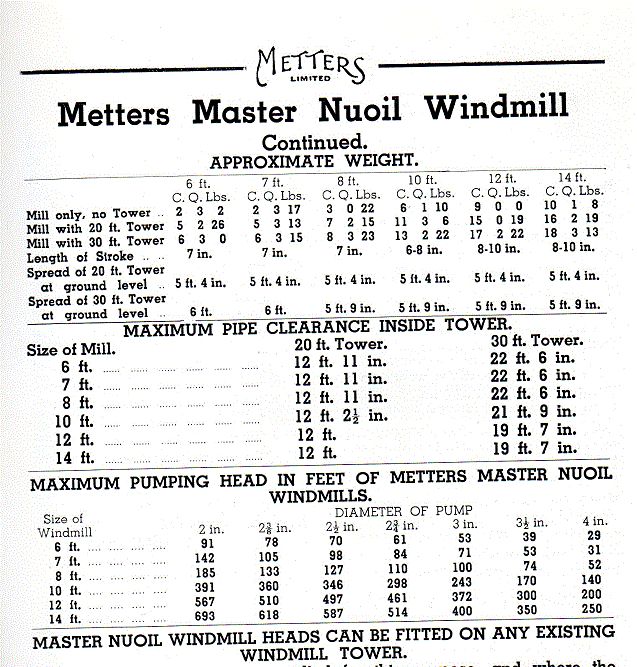

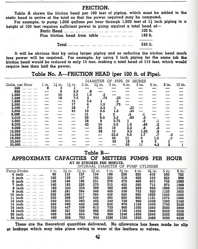

yahoo2
Joined: 05/04/2011
Posts: 1166
Posted: 08:52pm 02 Oct 2013
should be enough info here to get you close, you need to know the stroke length that the pump rod travels as a starting point.
30 strokes a minute is no far off, most windmill have the furling set at the factory around that speed or a little faster.
edit: obviously non return valves, accumulators, and getting the pump as close in height to the waters surface (if you are pumping from a dam) and a well set up float and foot valve make a lot of difference to the amount of water pumped and the height and distance you can pump it.Edited by yahoo2 2013-10-04
raymond thomson
Joined: 19/09/2013
Posts: 36
Posted: 09:49pm 02 Oct 2013
Thanks for the table. Lots of interesting stuff there, appreciate your help

Downwind
Joined: 09/09/2009
Posts: 2333
Posted: 03:57am 03 Oct 2013
Personally i think the table is next to useless for the mill at hand, as where do it show the crank travel or the gearing used for the data presented.
Well and fine to post data sheets but it needs to relate to the mill in use.
Its a bit like posting data for a brand of wind turbine and expecting it to cover all mills.
I worked for a water windmill company about 20 years prior to Mobi owning the same business, and the simple math still applies of pump diameter in relation to stroke length and strokes pre minute = displacement in volume/time.
Count the strokes and calculate the volume displaced.
Pete.

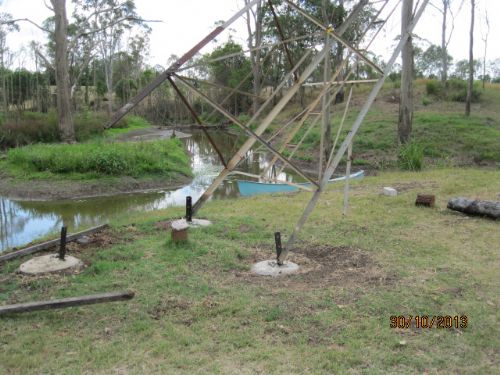

raymond thomson
Joined: 19/09/2013
Posts: 36
Posted: 07:56pm 18 Oct 2013
Now we are getting to the serious stuff with the Southern Cross windmill!
The con-rods are slack in the bearings, (yet to be removed and examined), but there are two other what appear to be white-metalled bearing positions available for the con-rods in the gear wheels. Is this a correct assumption? Are these there in readiness and will they need to be reamed; and will the con-rods probably need re-grinding anyway? It looks like a fairly easy process but I haven't been game to get down and dirty yet without some idea of where I am going, and a map of the potholes.
Maybe there is someone out there who has been down this track?
My model is a ZC serial Number 13116. My only drawing references are the 'parts list' generated by some companies.
Any inputs will be gratefully received
Raymond

raymond thomson
Joined: 19/09/2013
Posts: 36
Posted: 09:47pm 22 Oct 2013
Thanks Gary. Yes the alternate positions are for the stroke length so problem solved-well this one anyway. The pump stroke is now 170mm up from 125mm, 5" to 6.5" and I can only see this as an advantage.
With those other inputs I think that I have enough drawings now to complete the project, thanks everyone.

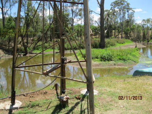

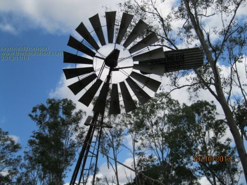

raymond thomson
Joined: 19/09/2013
Posts: 36
Posted: 09:02pm 18 Nov 2013
We finally made it! The windmill is up and running thanks to all who contributed information.
The raising process was a bit hairy requiring both truck and tractor in tandem because of damp grass. But the legs were exactly on target and all was well.
Climbing up to put the oil in was an interesting exercise and not to be repeated too often.
The old bore did not perform so the plumbing was re-arranged to suck from the nearby dam. We are in drought conditions and drawing from just a few cm of water but it is working well. I might get the bore attended to when the water table returns to normal but it is very old and a blast of water down it produced a heap of rust so we might stick with the dam water.
It has been a great experience and satisfied the objectives of aesthetic appearance, preservation of an Australian icon and of course the practicality of pumping water.
