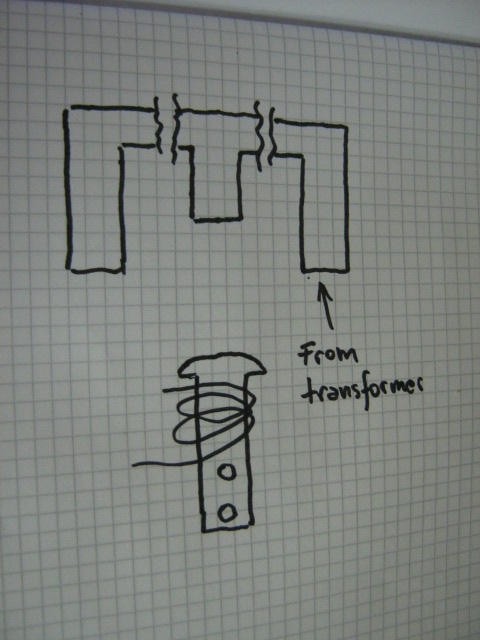

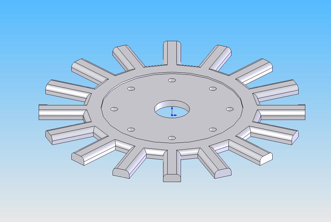

Before, I wanted to make one from scratch.
My first ideea about laminations:

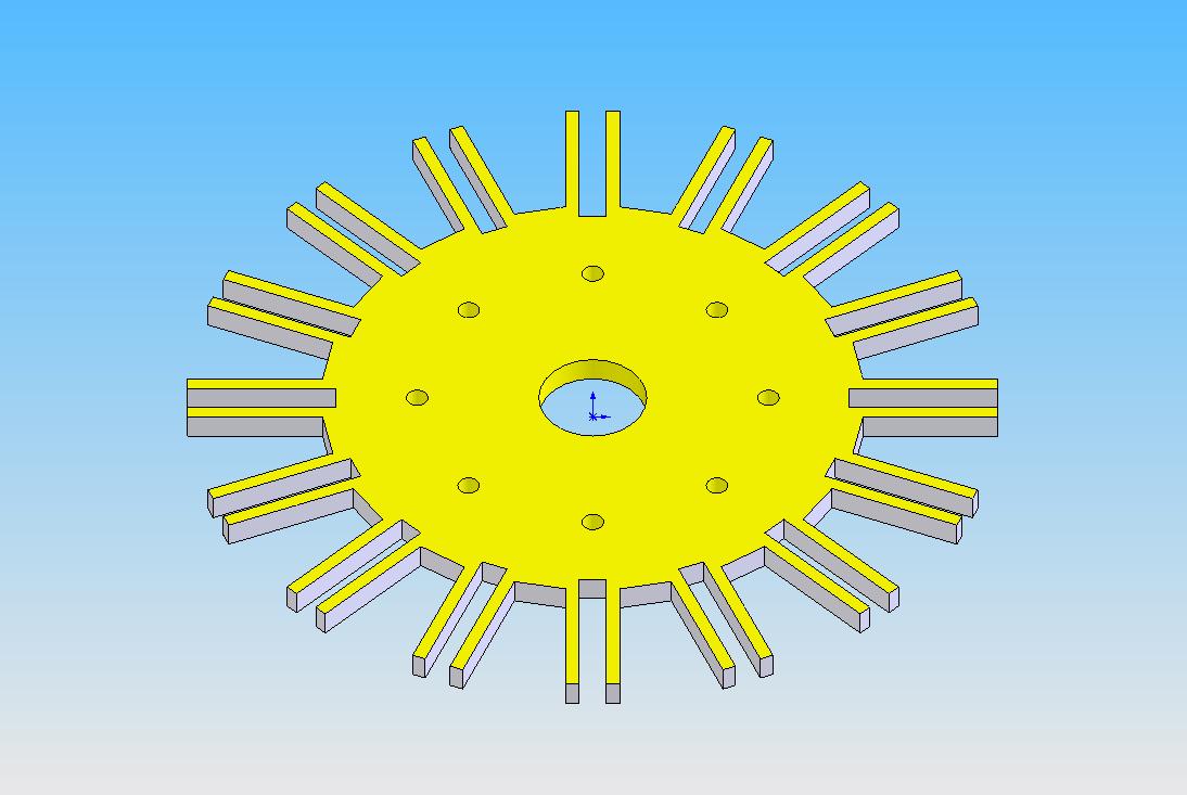

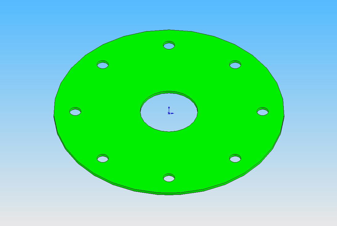

Posted: 11:34am 07 Jun 2007
And I think this is good for rotor.

Or maybe not an entire F&P because anybody can make the coils and glue the magnets (ferrite or Neo). The rest can be parts to put together.

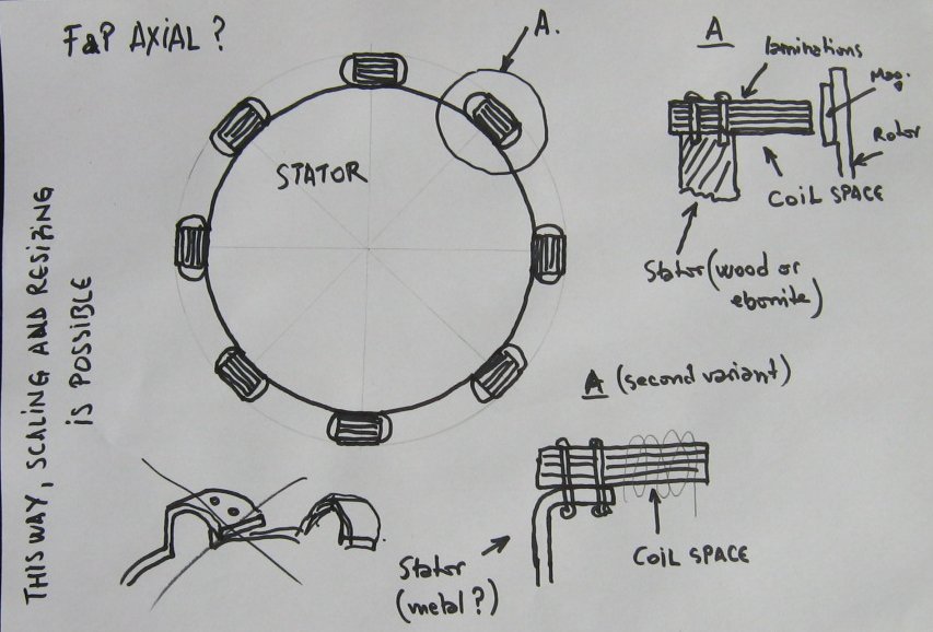

KiwiJohn, axial flux desig is excellent (easy to build) but have a BIG problem: the stator. You can't test different combinations or reuse it. But something combined ...
Axial flux design but only one rotor and stator like F&P but with coils oriented for axial flux. Problem is "sticking" to support the laminations of coils. You need a translator . Yes, the stator MUST be like F&P, reoriented, and I think it can be done.

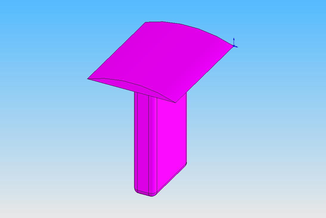

Posted: 02:46pm 10 Jun 2007
Thanks Storm, very informative page. This is a "must read" when do a Neo conversion.

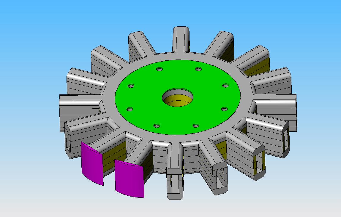

I designed this...
Few coils for easy reading. Thanks KiwiJohn, I think this is a good design for testing and experiments, but if we can find a better solution for mounting laminations on stator.Edited by vasi 2007-06-12

I think for HerbNZ design is very good that but is hard to find (and make) an axle for rotor without a lathe. Also making an F&P rotor is still hard. But a axial rotor is easy. I think is good to have a poured stator like in my scketch. Easy to make coils, easy to change coils if are burned or if we want different outputs, easy to make another rotor with different magnets. This can be a good "Windmill Kits & Parts" from TheBackShed Team, like electricfield.com or ecoinn.co.nz .
