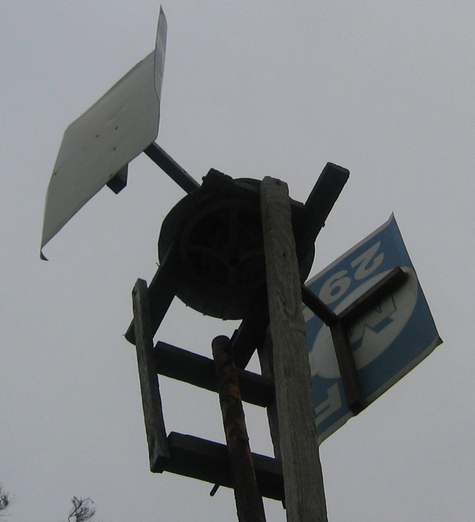

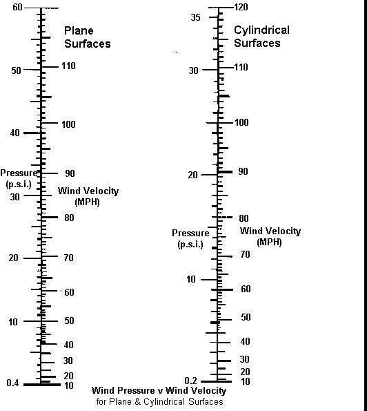

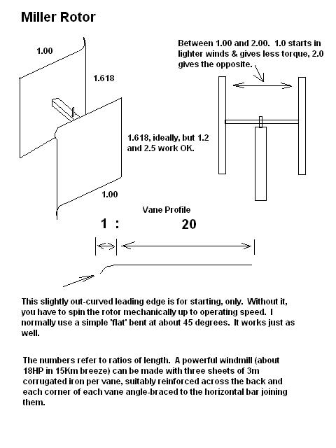

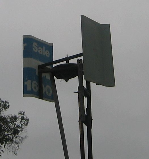

Some few years ago I was involved in helping people understand 'Miller Rotor' windmills which are a very powerful, 'torquey', non-aerodynamic way of extracting power from the wind. (Think: Holding a sheet of roofing iron and a wind blows up suddenly.)
I was surprised to learn that no one on your forum had ever mentioned them. Miller was an elderly gent with an inventive bent who wanted to leave something to posterity of his own devising. He developed the Miller Rotor in conjunction with (I think) the Ballarat Tech, School some dedades ago, but died before he could complete all his research. The Tech published his incomplete work afterwards.
I did a lot of models and few larger ones to determine what the optimum ratio of dimensions for the blades should be. People around here got used to 'that funny fella' driving around with outlandish contraptions strapped on the back of his ute when I was testing different ideas. What I came up with, finally, was a ratio of about 1:1.6. A sudden flash of inspiration made me realise that it should probably be the 'Golden Mean' of 1.618. I tried it and it WAS the optimum! Anyway, attached are a few pictures that should help you get started on this uniquely Australian invention.
Yell out if you need help. Words of Warning ... These rotors are unbelievably powerful and will quite happily take off an arm, a head, etc. They have one saving grace, however, they always turn a quarter-turn backwards before they take off reaching full torque in one revolution or less. The bad news is, they start in very light airs (less than 1M/S)

More on the Miller Rotor ... First, it will only work with two blades. It is not a variation on the Lenz design, predating it by a couple of decades or so. The Miller Rotor is NON-aerodynamic in that it does not rely on venturi effects nor any other aerodynamic device. The Miller Rotor converts static pressure generated by the wind to torque.
Best results are obtained if you use the proportions I gave (1 : 1.618), however, there seems to be some leeway available in this regard. This will impact on performance parameters negatively to the point of becoming a wind-vane, in some cases.
With each blade comprising of three 3 metre sheets of corrugated roofing iron, suitably braced, a shaft power of 18HP was generated in a ten MPH breeze. (Roughly 13Kw at 4 m/sec). This was measured with the thing mounted on my ute which I couldn't get to accelerate beyond about twenty Km/Hr, even in first gear. The side forces during gusts on such a blade are frighteningly high so the tower has to be massively built for use in hilly areas where 'gully winds' may be present.

Vawtman ... The blades are 3 metres (not 9, as you stated). For the uninitiated 3 metres translates as 'about ten feet'. A standard sheet of corrugated roofing iron covers 762 mm (for you, two foot six, roughly) this gives a blade dimension, over-all, of about ten feet by seven foot six which is way outside the recommended ratio of dimensions but works all the same. If you want to go all pedantic, you might overlap the sheets a little more to better approximate 1:1.618. As for "static pressure into torque', try holding a sheet of something light but large, say a sheet of 8ft by 4ft plywood, at an angle to a stiff breeze. You will shortly appreciate what that means. As for a picture, have a look at the first post in this topic. I'll agree the tower asthetics leave something to be desired, but the basic thing is there to see, albeit in the form of a small demo version. This one is mounted on a small washing machine gear box which originally drove a small electric motor as a generator to light up an automotive light. (Dimly, I must admit!)

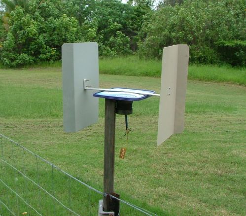

Wish I could help. I still have the little Miller rotor I built a couple of years ago, its still running. I agree, it has a lot of torgue and I suspect its TSR is over 1, making it a lift based VAWT.
I agree the Miller rotor needs more research. I have a feeling it would be easier to make a Miller from some roof sheeting iron, than a Savinous from a cut up 44 gallon drum. And the Miller would give more power.
Posted: 12:38am 28 Jan 2010
I just took this picture of my little Miller. Its driving a stepper motor, which powers a few LED's. The plastic icecream lid is to keep water off the stepper motor.
