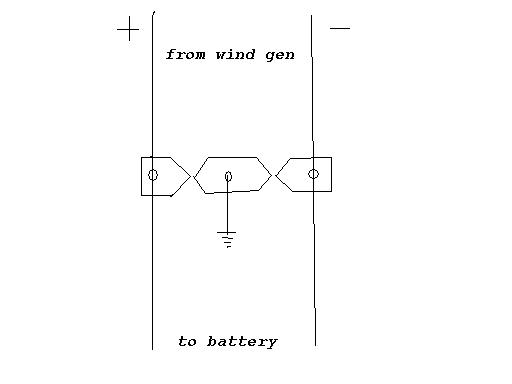

Gill
Joined: 11/11/2006
Posts: 669
Posted: 12:57pm 26 Jun 2007
Sorry slick, don't know that wind gen, let alone how to get inside.
Maybe someone else knows it's secrets.
Seems like your in a lighting hot spot. Don't think I'd be relying on a fuse for static protection, that's not it's job.
If you are not always around to disconnect(best), here's a device that may offer some static discharge for protection. Make out of heavy copper. Points don't actually touch but are very close. If 12V, set to car distriutor point gap or just a little less, never more, say 20thou' (0.020"). Rain & weather protection essential.
Alternatively, try a 'Gas Discharge Surge Arrester'.
Altronics cat_RS-5424 . DSE once stocked them as cat R1804 but can't find them listed now.
For the 3 lead type, the two outside leads go to Pos and neg, whilst the middle one goes to your tower earthing stake.
The gas arrestors are not suited for 240v. Mostly used for protection of low voltage telephone and radio gear.
Hope that's helped.

Highlander
Joined: 03/10/2006
Posts: 266
Posted: 08:55pm 26 Jun 2007
G'day Slick, that sounds like the ones that are on egay and jaycar. If that's the one your talking about ecoinnovation has a couple of pdf's you can download.
http://www.ecoinnovation.co.nz/links.php?code=8
Scroll down to the wind section
Good Luck

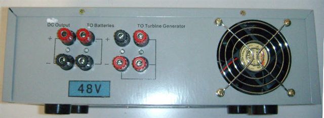

Highlander
Joined: 03/10/2006
Posts: 266
Posted: 08:11am 07 Jul 2007
Hey Gill your probably right.
I d/loaded that manual, here's a portion
"Once running, the head unit delivers AC voltage to the control box, which then changes this to DC
current for the batteries. At about 25 to 27 volt AC per phase for 24 volt systems, (13 to 14 for 12
volt), the control box will commence action and decide whether to charge the batteries or dump off
power into the inbuilt load resistance"
"The power generated will be absorbed by the internal heater and driven out by the fans."
May make a bit of noise, don't think it will wake you up though.
Found a pic of a 48v one
Is this what you have Slick?
Central Victorian highlands

Joined: 23/06/2007
Posts: 11
Posted: 11:04am 07 Jul 2007
Yeah Highlander exactly the same they say theyre no good any idea? So the balancing of the hub and blades how? On the ecoinovations site they have one pulled apart and it shows sliprings so im hoping mine is the same mk1or mk2? If i have sliprings the wires will not twist is this right? so ecoinovations fitting a rectafier is this instead of using the charge controller box? Tried doing this in list form but no idea**&&## Thanks paragraphs didnt work either. Gill this is the ones jaycar are selling next to the cows idea Edited by slick 2007-07-08

Joined: 03/10/2006
Posts: 266
Posted: 12:07pm 07 Jul 2007
Arranging text in paragraph form, just hit enter, easy
I have heard the controllers are a bit crappy, but no one has ever said why.
I think I remember they overcharged batteries.
But you should be able to adjust that, possibly there may be trimpots in there to play with.
Anyway one step at a time, get it up and you can sort it out later.
The rectifiers only change the alternating current to direct current.
It doesn't replace the controller, you still need to feed the batteries with charge current untill they are full.
Then the controller will switch the charge off the batteries, BUT the power from the mill still has to go somewhere or it will overspeed and self distruct.
So it goes into a "dump" mode where it dumps the excess power into something like a heater element or a powerfull light etc.
Don't try using a "solar only" controller as it won't have a dump feature.
Just put it all up and see if it works before replacing it.

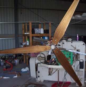

OK balancing the blades. you can do it a few ways but this is how I did mine.
mount them so there is no resistence on the shaft, with a f&P you just take the magnet rotor off, but you may have to put a big bolt in the wall for the hub to spin in.
Basically if one blade is heavier it will drop to the bottom, so you add weight to the one next to it, depending how far out they are, you may need to saw some length off even.
Have you seen the page Glenn did on the chinese blades?
Here

Joined: 23/06/2007
Posts: 11
Posted: 09:51am 08 Jul 2007
Thanks again Highlander,i reckon i can sort the blades out,balancing and customizing.
