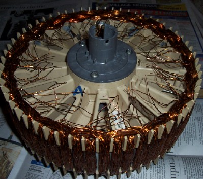

Pic of the first stage of re-configuring the windings --more to come,,,

Ok,, over that bout of computa stress-- now ,,down to business.
I unwound the 1st and 2nd coil windings completly--u could keep the wire or discard it -I discarded it ,,as all the crinkels and bends will add bulk to the final windings..
I will cut and "tail-out" starts and finishes of the coils I want to connect to bussbars for series-parallel connections-- same as F&P re-windings...
You will have to purchase some appropriate enammeled wire to re-wind the second and third phase winding coils --- or re-use the recovered stuff , straightening it out carefully ...
So, that's about it ,, a time consuming job ,but quite simple , every coil has 38 turns , so that means the frig door should be opened ,,Oh ,, what the heck !!!

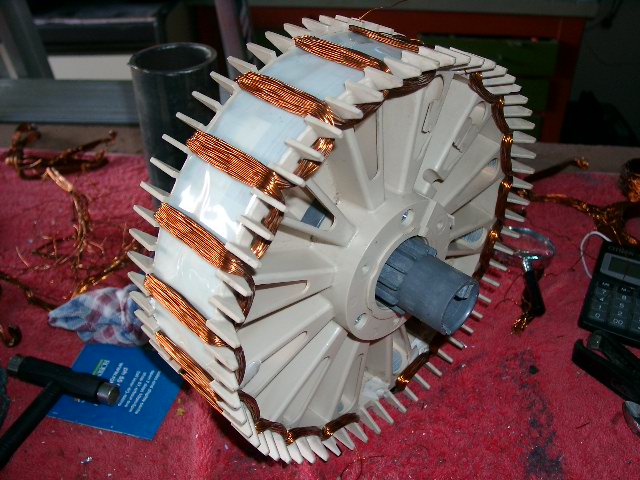

Hey Bruce,
well that was a pain in the ass.
Here it is finised, hooray
prepare yourself for sore fingers. There is a little trick that all rowers will know leukoplast your fingers first.
Pity I can't drive it
Ever thought about selling those seeley shafts Bruce?

The reason I pulled the coils off was the stator was faulty,short in some wiring,,had to find it ..
The other reason I started was to find out how difficult it would be to re-configure ,,similar to what we do with the F&P .
I've a re-winding friend who gave me heaps of new wire so I may try different sizes or "two-in-hand" wiring .
I've not continued with the winding yest as I've lots of other things to be done around here,,But if anyone has results from these Seeley's ,like rpm/output watts Etc , please post your results. This will save a lot of unnecessary work .

Hi Gill, 20 coils in series by three phases.
20 magnets
each coil has almost the same length of copper as fp, 60 coils on seeley 42 on fp, so roughly 50% more copper.
Magnets Don't seem as strong, stuff em anyway I'm going neo.

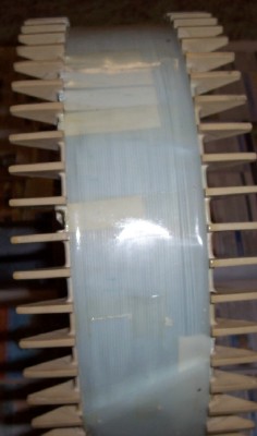

Hi Bruce, just one point that I wish I had told you about before your rewire...
I found that increasing my magnet bulk on the seely resulted in higher output, but substantially greater iron loss which may cause stall problems with much stronger Neo's (mine were bigger ferrites and made a unusually large difference to the iron loss.
On closer inspection, the wire wraps under the coils are NOT insulated from each other, so you can expect enourmous (comparatively) eddy losses AND iron losses.
Sorry I could not get to you sooner with this info (when you had an empty stator), so you could remedy this strange manufacturing oversight (seeley should have known we were going to use this motor as a genny :) ). With the original mag config, it was not very apparent. As a motor it may not have been an issue (just like cogging isn't when F&P runs as a motor), but as a genny with limited starting torque, the Neo's may hold it in stall until a reasonable wind gets up to overcome eddy and iron loss, and if you do get going , overheating from the wire band may (and maybe not ) cause extra thermal problems for us. Thus far at 1.4kw@ 540rpm the stator has not warmed the coils up much at all. (HV load 450W/phase)

Now , if that silver wire is a nuisance in our applictaion , and needs removing ,then I think we may be able to cut a strand or two within the internal perimeter and gently pull them out ,eventually removing the lot ?. Maybe.

We will need iron of some form inside the copper to draw the flux through the coils.
The magnets on the seely are close packed, and so without something to attract some flux through the coils, a good deal would leak to the magnet beside it rather than doing our bidding.
So we should have steel inside the coils, but it needs to be insulated to stop the high eddy currents.
Vawtman's idea of the rusty wire is probably the ticket here. Zubbly feels the same way.... He feels that throwing the wire in the barbeque, and pulling it out after it's cooked, will burn off the zinc coating for us.
If we then place it in water and then air dry it, we should end up with a wire finely coated with rust.... a very good insulator.... (now if this doesn't work, you can re-stoke the fire and have a barby anyway..... so not all is lost.)
As I said earlier, the original mags are weak enough that their eddy and iron loss does not appear all that challenging to startup, but if you (or someone else) decide to go neo,(or you stack a heap of ferrite's like I did), it will be a totally different story in this regard.
