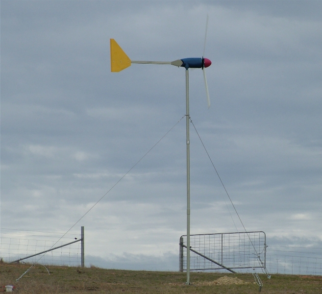

We observed that mill ONE tended to hunt around with the wind, to be expected at only 4.5m above ground and so low on the hill.
But it also seemed to start furling early and not maintain output in strong winds.
The basic geometry of the tail is wrong, in moderate winds the thrust on the blades allow the mill to turn slightly away from the wind (as if starting to furl)
The tail is not holding the mill into the wind.
Now reading the guru of small wind turbines, Hugh Piggott he suggests the tail should have a positive offset so that under moderate winds the mill is held into the wind slightly to the opposite side of furling.
Mod 1. - Bend the tail arm 10 degrees away from the axis of the wind mill.
While mill ONE was down we checked the geometry.
The rack angle on the tail pivot is only 3 degrees, too small to allow the tail weight to control the furling of the mill.
Mod 2. – Added %50 more weight to the tail. Changed metal tail for a piece of ply wood twice the area and heavier. (at present we are only 0.5 kg heavier than the orignal vane but could do with more weight)
RESULTS, mill ONE is more stable in moderate winds and is holding a higher output in gusty winds during furling operations.

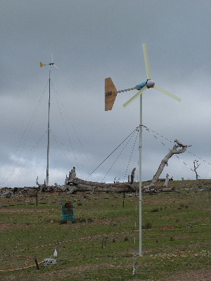

Picture of mill ONE, before tail mods
Sorry about the changes, trying to get the pic size rightEdited by KTee 2007-07-15

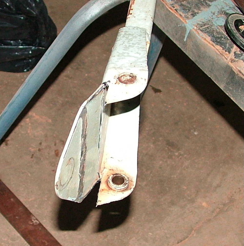

Checking the tail angle.
hold the tail arm against the stop on the housing and sight along the axis of the generator. The tail should move away from the axis by appoximately 10 degrees
I've got a few pic's for you, they say 'a pictures worth a thousand words'
you can see how Dave (my brother) cut the tail arm to get the added 10 degrees. just weld a filler in the slot and a splash of paint if you are so inclined.

Pic of the 2 mills, mill ONE is in the fore ground.
