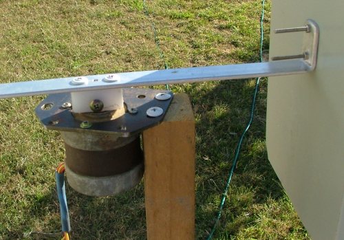

I wanted to play with the Miller turbine again, there is something about this design that has got me interested. I made a adapter from HDPE ( same stuff those kitchen chopping boards are made from, easy to work and cheap ) to fit a stepper motor.

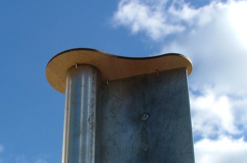

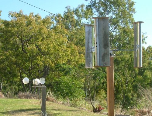

The little miller runs well, makes about 3 volts. I've been watching this thing all weekend and I'm sure its a lift windmill, once started it keeps speeding up like a Darius windmill.
I've attached a little video of it running.
