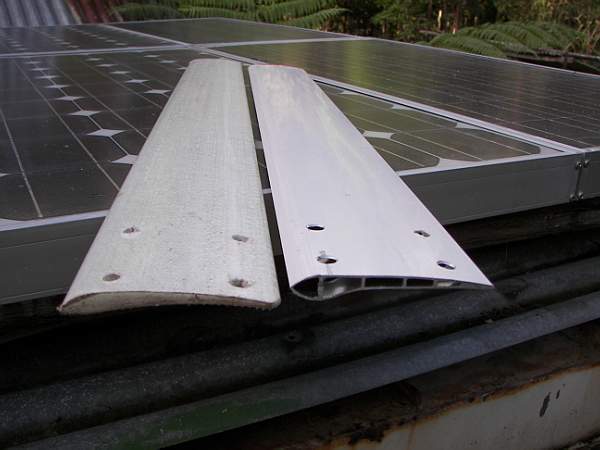

Blades arrived.

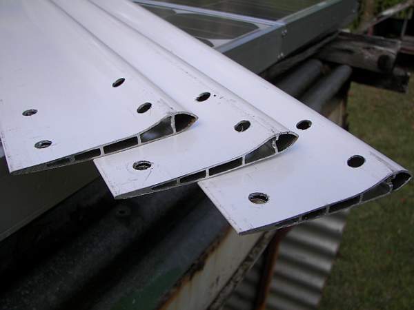

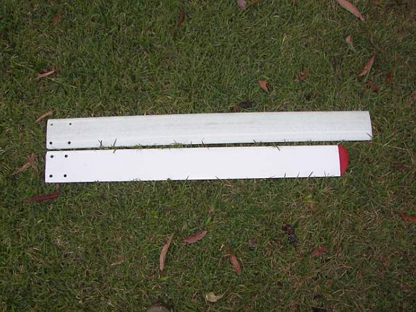

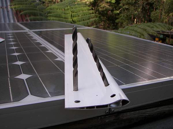

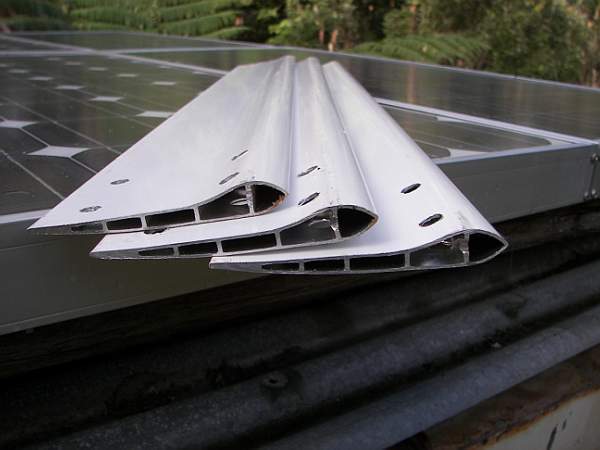

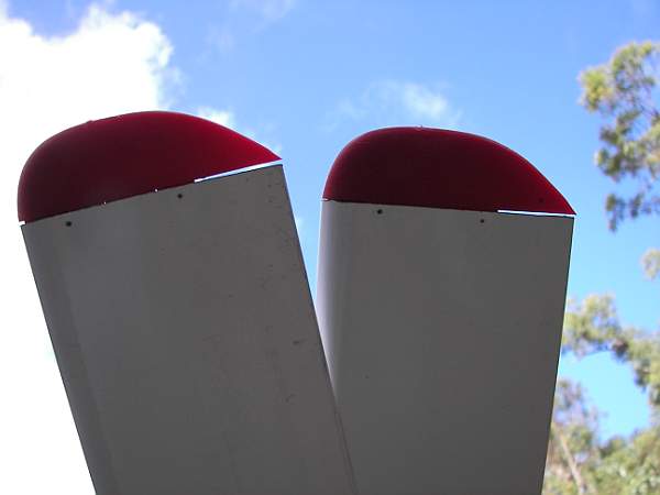

Pleasant surprise to find they are not solid but are extruded. I would rate the extrusion as quite good. Very light with a good finish though 95mm shorter than the old glass blades. weight 700g ea (glass 1,300g ea)
Comparison:

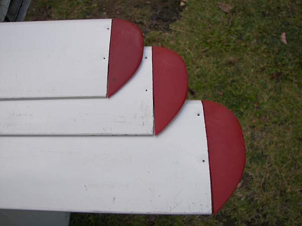

It's what they do to this quality extrusion that tells you it's Chinese. The tip (red) is a plastic moulding that is inserted into the extrusion. It is held in place by centre punching the aluminium, 2 on top n 2 below. God knows how these dimples stop the tip from flying off in a good spin cause I don't. Oh yes, a big gap on each is where the tip doesn't fit properly, but on the bright side, it gives the native bees and wasps somewhere to build nests.

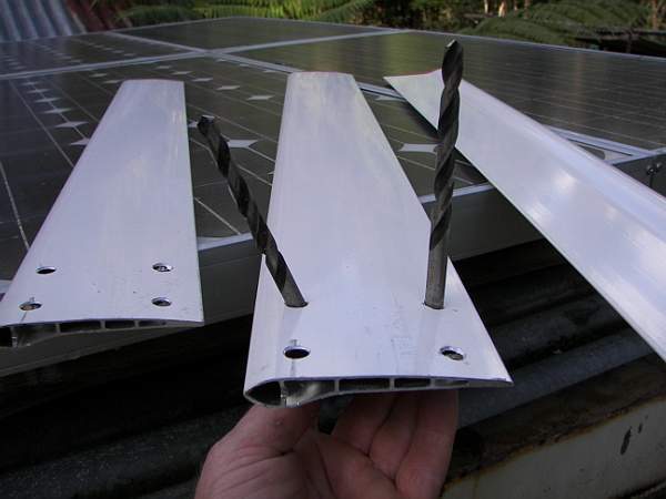

now the mounting holes have a few issues too.
First, the holes are not the same dimensions. Old holes were 60mm wide x 60mm long CtoC, new holes are 60 x 45. Holes may have been drilled or chewed, not sure which. ("Grandfather Chan bought drill bit.. and looky... still workey.")
Axis of drill is vastly different for leading and trailing holes. See Pic.
no added support in hole area, and bolt clamping may crush extrusion or bolt may pull sideways through the thin wall thickness as blade spin loads the root.
Still I would cope with all these faults "IF" I can get a twist in it.
As I said the extrusion seems OK and I feel potential for a twist looks Vgood.

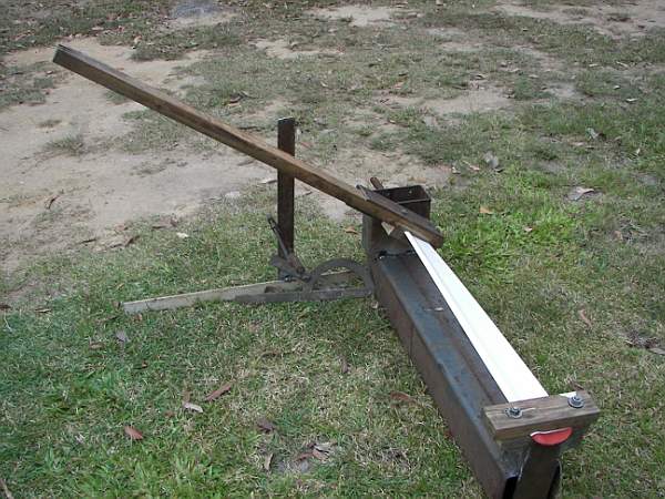

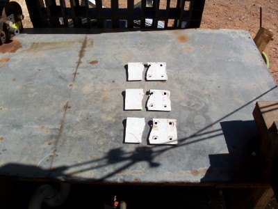

Will need to carve/shape 2 x clamps and devise a setup to twist yet maintain axis of blade and ensure consistency of the 3 blade twists.
Stay tuned..... Will post to forum when bent or busted.

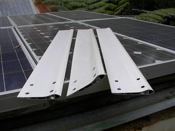

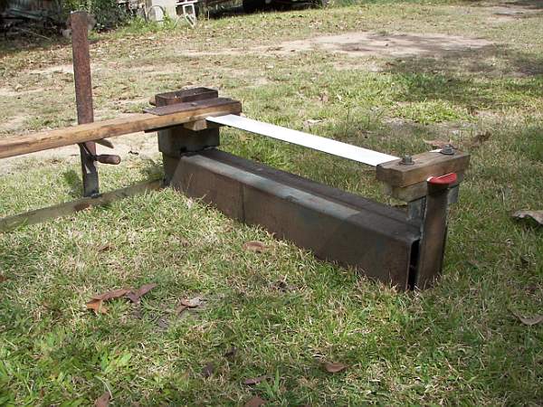

It works!
I've twisted the Chinese blades to 30deg.
I felt that was a far as I was game enough to try. To get 30deg, the blade has to be twisted to about 70deg then it spring back when released.
Finished product:
"The TWISTER":
30deg:
I'm prepared to twist blades for any forum member for free, provided you accept my no liability, and you pay all potage, conditions. Edited by Gill 2007-08-09

G'day kumtarest,
Red tip parallel with HUB?
Yes almost.
The chord at the red tip will be just off perpendicular to the axis (maybe 3 or 4 deg blade angle) and the blade root chord will have a blade angle of 33/34deg off perpendicular.
You are right also in deducing a better speed and startup. All due to the more efficient blade angles at the various stations along it's length.
In the unmodified factory state the blade root will always be in a state of stall no matter what the prop speed and whilst large angles of attack are unavoidable and tolerated(without variable pitch), this greatly exceeds reasonable levels. Hence the modifying twist .

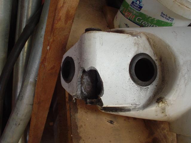

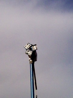

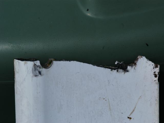

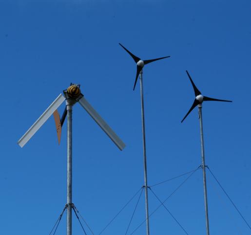

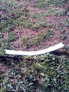

Hi everyone, i thought i would share my experiences with the chinese turbines. First turbine from Jaycar, hub was machined off centre and led to vibrations that ultimatley led to the tail plane to fail and the fiberglass blades to start to fail.
Second turbine from envirowind was a newer design, smaller and with aluminium blades. We didn't use either of the supplied towers as they are s**t and too low anyway.
After 4 weeks the aluminium blades failed at the hub, these were replaced by envirowind and the second pair lasted 6 weeks when they too failed at the hub, on taking down the turbine the cast housing had fractured around the tail mounting and is now goin to be used on a VAWT.
The original turbine now runs a set of blades from the states on their own hub ($125 oz inc s&h) and a ss tail which seems to be quite satisfactory.

I am in the process of making a 6 blader using the Chinese aluminum blades. Some precautions I'll be taking will be to strengthen the blade roots by part filling the extrusion cavities with a two pack filler, by bedding the blades to the hub with sikaflex, and securing the plastic tips better.
I feel if a tip comes off or the root walls are crushed a little, or not tightened enough, the resultant looseness will cause vibrations that will metal fatigue the aluminum in quick time. Loose a blade and the massive out of balance will flick the tail around causing it to break off, The yaw bearing and any other weak point is also prone to fail.
I think your experience is a good warning to me(and others) to take extreme care when preparing and securing these blades or any blades for that matter.

Bit of a wind farm you've got there. What's the output in peak conditions?

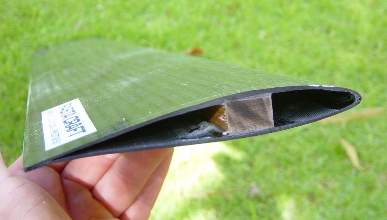

Those who are not happy with the strength of their blades could use the carbon foils produced by Fasta Craft.
