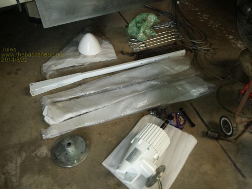

Posted: 11:30am 22 Aug 2014
Yea I have dump load but dont have a way of switching manually to slow turbine. Generator is only a few moths old and has already shed its blades. Installed a weather station so I knew when the wind speed was getting to high to avoid this and now have a burt out unit. Feeling frustrated. Here is a photo of the unit out of i
nterest.

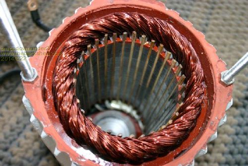

Posted: 11:47am 22 Aug 2014
Thats an image of the windings on the 2-3Kw one I've got , the wire would be probably 1mm dia, so she would be able to take a belting in the wind.
When you short your windings,I'd suppose being far lighter windings ,she'd burn out real quick.
I also have the instructions in my Exmork manual about throwing the "shorting" switch at high speed--it's a no-no ,in black and white.
My supplied dump load is 1kw resitive coiled resistors,I guess they would be able to take a lot more than that ,they are fairly big and chunky.
