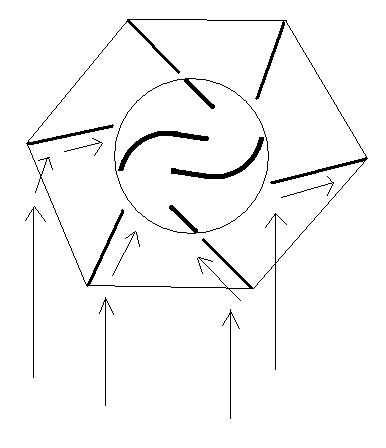

I am working on this principle... 5 feet tall, 2 feet diameter... wind deflectors to minimize drag and maximize pull... geared 6:1 on a treadmill motor... I will be done in the spring... good luck...
Lar.
Gill
Joined: 11/11/2006
Posts: 669
Posted: 02:32am 09 Dec 2007
G'day Larry,
I see what you are trying to do and like your inventiveness, however feel that your design may not work as well as you hope for the following:
You have increased the capture area by adding vanes to intensify the power to a smaller central savonious. you seem to understand it is the more efficient profile hence the heart of the design. Perhaps with some further consideration you will see that a savonious of the same size as your total size would therefor be more efficient than a boosted smaller one. Both have the same wind capture area.
For a more even torque, stack a second savonious on top of the first but offset by 90deg. (Two @ 2ft 6in high.)
Your dimensions reflect a design style popular with some Poms at the moment, however the more efficient savonious are the opposite, ie. short and fat not tall and thin.
I understand this design is convenient for use of PVC piping however performance is abysmal considering it's capture area.
I don't mean to deter you from making your design, just make you aware of it's design characteristics.

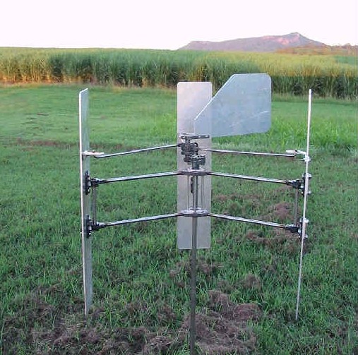

Posted: 09:16pm 18 Dec 2007
I've built a few VAWT's and HAWT's over the last couple of years. The VAWT's have been mostly drag type machines, the biggest was a Lenz2 on a F&P at 1.2 meters high and 1.3 wide. It worked, made 20 to 40 watts. I really needed to double its height to say it was a successfull windmill, be never got round to it.
What I find is HAWT's are much easier to make, lighter and need less materials. In my local clean summer winds they work great.
In my turbulent winter winds, I found my Lenz2 windmill worked better.
I think its a matter of location. Honestly, if a VAWT needs a tail to find the wind direction, then it would be cheaper and easier to build a HAWT, other than the fun factor of building something different of course.
The big advantage of a VAWT is it can take wind gusts from any direction and instantly turn that into power, where a HAWT needs to find the wind.
I think there is a place for both machines, I like VAWT's, but have always been limited to making small one's due to the extra materials and complexity of the design. I found the little Miller rotor I made worked great, and would like to scale it up, but when I worked out the cost of sheeting those big wings, I gave it a miss and went back to working on the HAWT windmill.

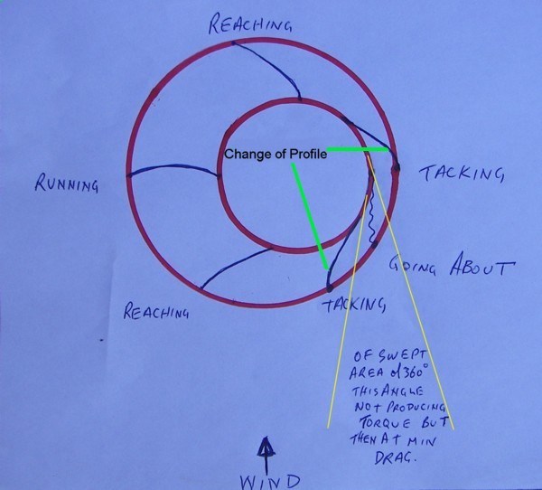

Gill
Joined: 11/11/2006
Posts: 669
Posted: 04:26am 20 Dec 2007
This is my idea of changing profile. Applied to Glenn's early HAWT
Edit: Ooops! topmost sail/vane is back-to-front.
If you've ever done any sailing you'll immediately understand the terms and aerodynamic profiles. In basic theory this should produce torque for most of the 360deg.
In reality there are considerations of relative wind flow as well as changing flow through the turbine itself. Still I feel a turbine with an adaptive flexible profile such as this will cope with these without the need for the DIY experimenter to have a degree in aerodynamics and a wind tunnel.
And before you say it, I agree, All those working parts are a minus.
But any comments on the principal idea? Edited by Gill 2007-12-21
