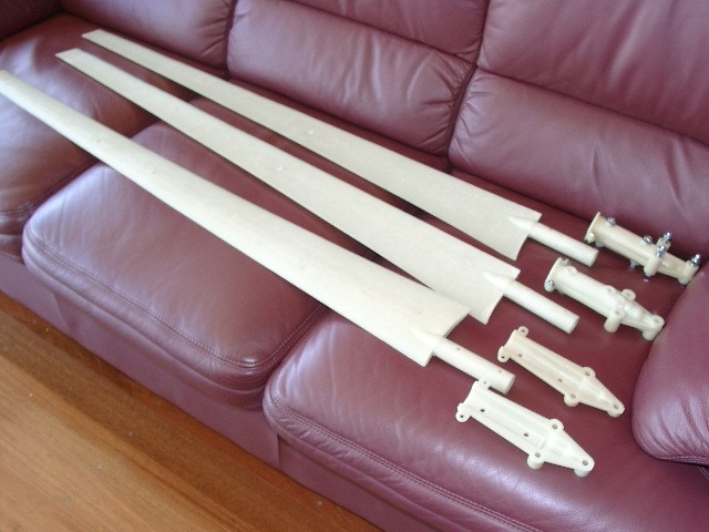

I bought similar blades (6.8Ft)from ebay seller "magnet4less". The parcel arrived today from the USA. They are a piece of junk, not worth even making a hub for it.

Hello Harold, sorry to hear of your disappointment. They look ok in the photograph,but !!.
Tell you what,, I got a set of Trev's fibreglass blades-why don't you come down here to Mt. Tamborine and have a look at them ?. You'll be impressed.

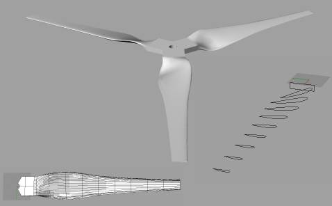

Trev and I are finally starting to make some progress on a set of blades to suit the single rotor F&P windmills. Its been my fault, tied up with other projects. But the cad work is almost done, and the CNC router is all cleaned up ready to start machining.
Its 2.4 meters diameter, with a TSR of 6, profile NACA 2410.
Still some time away, I need to rout out the blank, then Trev can make some moulds to make the blades in fibreglass.

hi all, well i am in the US of A, my blades were delivered to the hotel today, and i am very happy with the one I unwrapped. It wants a file over a couple of small dags stuck to the fiberglass, maybe 2 minutes work.
I will be putting these together soon as I can after I get back to OZ, and will report back. If they live up to my expectations i will be buying one of the larger sets, maybe 3 m to gear up a F&P

Hi Robert ,, I purchased a set of fibreglass blades from "Art" over that way a couple years back. I had to finish them off and paint etc. They are a bit on the slender side for the F&P --but I'll try them again one day on the non-cogging F&P .

hi Bruce well they look pretty diferent to mine. i put mine up about a month ago on my chinese mill. They produce miniscule noise and are at least as good as the chinese blades. The windmill has been sitting on 6 to 10 amps into the 24v batteries for 5 days now with the southerly. i am looking forward to putting them on one of the F&Ps

Hello out there,, well Harald sent me those chinese blades he spoke about at the top of this topic...
What junk ,,,, I reckon they were put together by a mob of 3 year old kids , they are as rough as you could ever imagine .
How someone or worse still a company could send these to a customer ,, I don't know.
The edges are absolutely shocking,no sanding,no filling and the rounded tips are a joke,so rough. the profile is reasonable ,but the things seem to have been pulled out of the mould early and there are depressions along the length.Lots of bog required to fair these blades out ,I'm telling you.
Harald and I talked about these yesterday, I thank Harald for sending them to me and I can assure everyone out there never to buy these .
I will one day bog them and do some serious sanding and grinding of the edges ,they are 1 metre long ,maybe be fairly good for a small gennie. But serious work has to be done to bring these up to good looking blades.
