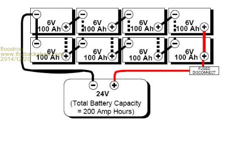

Heya,
My battery bank is 645 amp hours, about 3.5 years old wet flooded batteries. I have 3 strings of 6v batteries.
The batteries connected on the Positive side seem to get the most abuse, as all the corrosion forms there, and those batteries have acid drip stains, as opposed to the negative side which are all clean.
So I found some info about cross-tying the batteries to equal out charge and discharge. SO I went ahead and cross-tied all 12 batteries. No issues thus-far.
My question is: On the diagrams, cross tied banks show the positive lead going to one battery on one end, and the negative going to the opposite end. But on my setup, the Positive and Negative leads connect more like Buss-Bar style.
With a cross-tied bank, is it OK to connect pos and neg leads to a common bus bar, or must they connect to 2 individual battery terminals?

Posted: 05:46pm 19 Dec 2014
Sure..
The dotted lines is the cross-tie. Exact same as my setup, but mine has 1 more row of batteries.
Notice the battery feeds go to 2 battery terminals. If my parallel connections at the end battery rows go to a buss bar, I assume I can just hookup to the Buss?

what they try to do is give each battery the same total cable resistance. So if you trace a path through the circuit past each battery the total length of cable and number of connections should be the same for each cell.

The interlacing of the battery bank like this equalizes any small differences between pairs but is best done from a new set that the standing voltage of each pair is matched, without matching the slight differences can result in cross current in each pair, resulting in losses by self discharge, this is more of a problem in stand by banks, that are just floating most of the time, on a working bank the constant load charge cycles make it less of a problem, the only time I have had problems with it was when a farmer fitter a new set of batteries next to an older set, some 10 years difference, so the internal resistances due to longer term sulphation, natural degradation of the plates was different, it reduced the capacity of the newer cells and required more charging, indicating an internal self discharge current was flowing.
The other case was different SG of some of the coupled batteries, caused by either more sulphation in some or perhaps a slight difference in the SG of the electrolyte when the batteries where initially flooded, in both cases a long treatment with a desulphator helped and a little bit of acid to balance the SG of the batteries on the second set.
