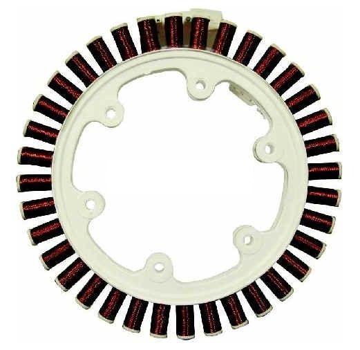

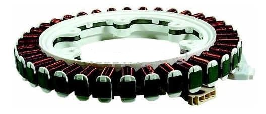

Nice photos Gill where did you manage to get them from?, the only available web site's over here have copyright on them The site that I posted is part of a group called "connect-distribution" who have sewn the market up in the domestic appliance spares industry , their web sites usually start www.4******.

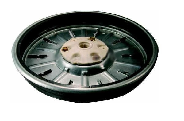

Posted: 10:22am 27 Sep 2007
Can't recall where, just Googled around a bit.
I recommend a programme called HyperSnap but there are many others.
Should you come across one(or several) of these LG washers, take note of the stator as it appears as if there may be two types. That spare parts mob you talk about seemed to refer to one stator as no longer available and another that is.
Our F&P stator can be found in 4 types with the hub or rotor in 2 basic types.
The 3 early stator changes were in the wire gauge and number of turns per coil. The last change was a total redesign brought on by a different magnet shape, that for us, overcomes the dreaded cogging resistance.
Only one type of LG hub sorry 'Rotor' was indicated so I'm guessing that any stator differences will be in wire gauge and turns per coil.
Hope you can acquire a few. The potential is there.

Interesting stuff,, I think the magnetic rotor hub is pressed steel ?? I'm finding the F&P plastic rotor is a bit flexable and also I'm finding after meny install/removal operations the threaded bit is wearing .
If anyone in Australia can get pic's or know of particular dryers/washing machines that have these ,please let me know and I'll go hunt one down ,thanks

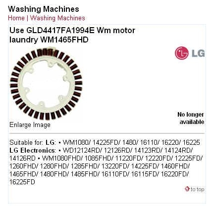

  roganjosh said   Nice photos Gill where did you manage to get them from?, the only available web site's over here have copyright on them The site that I posted is part of a group called "connect-distribution" who have sewn the market up in the domestic appliance spares industry , their web sites usually start www.4******.
I found smoething similar here
and no copyright on first page, you can take a screenshot if you don't want to take the pics. Anyway, Gill wanted to help as ... Thank you Gill for pictures (I saw big interest here - Bruce ).
Man, I wanted this pictures so much (I used the text title form first pic for google search)!!!
P.S. Now, with this link, we are ok in the copyright terms :) . We not charge them for free advertising and they give us the right to use their pictures. I am wrong?

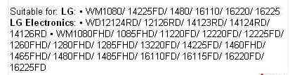

G'day dwyer,
Did you check the model numbers against those in the 1st image of my post?
Here they are again:
I imagine LG produce other types of washers as well so do check first.
Also I'd stay clear of driers.
What I thought I said was that many of the above models of washers also have a drier function in them as well.
That is a washer and drier as one machine. (maybe only in the UK???)
I have no idea of what models have been imported and sold into Australia. Let the buyer beware!
I'm keen to hear of any successful find.
Good luck
