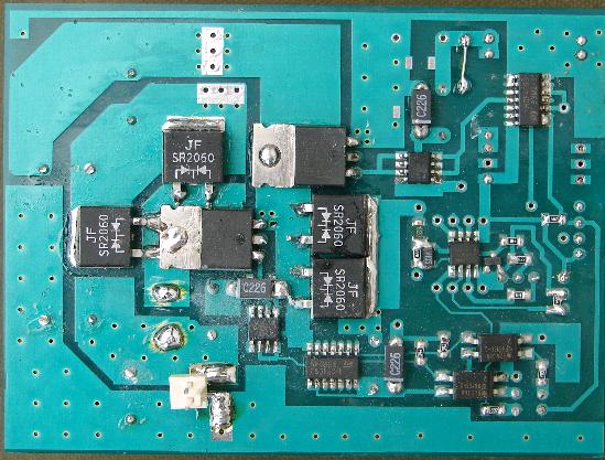

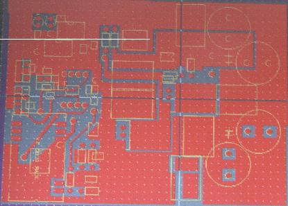

Hi Gizmo,
I have my own cct design that I have installed on my custom ironless design. [obviously no cogging here!]
peter has had the luxury of viewing the MPPT.
From my experience the main hurdle to overcome is the cubic relationship between wind speed and wind energy. My early designs were similar to the design you posted. I had a lot of problems trying to use feedback to control the system. Instability can let the smoke out of most semiconductors.
My MPPT allows the generator to start producing current in a 24 battery from a generator voltage of 6V at 1.5W to a maximum recorded 455W at 28.8V. My generator has 3 blades with a swept diameter of 2.1m.
Passive generator tail side furling starts protecting the generator electronics at wind velocities above 15 knots.
A Wind MPPT has an additional rapidly changing variable compared to a Solar MPPT. Ideally the generator RPM should track the wind speed to enable the rotor blades to operate at their optimum. Any blade has a sweet spot at which it perfoms the best. An Iron design may use the frequency relationship of the laminations. As the torque increases with increasing wind speed, the rpm increases as the iron begins to saturate. There is a danger that with too large a blade area, the rotor cannot be stopped above a certain wind speed, [even with the output shorted].
A MPPT should alow the blade to operate at this sweet spot most of the time. A MPPT machine will have a power output that follows the power of the wind gusts.
My measurements have shown that the wind is a fickle beast. The gusty nature of wind does not make it an easy task for a MPPT. I had little success with a micro controller.
I have found that a combination of constant current control at the bottom of the power spectrum and changing over to voltage controlled current limiting has given the best results.
A simple fixed resistance current shunt in combination with a voltage controlled current shunt to control a simple PWM cct like an LM 3524.
The cct is powered from the generator and hence does not contribute to battery consumption. [ < 50 mA ] The shunt has a 200mV maximum voltage requirement. The design uses a simple pot core inductor which is easy to wind. The design has no heatsinks and uses SMD components.
My cct has been in operation now for over a year. I have not been a fan of high generator voltage unless the generator is noisy and has to be located a long way from the battery where wiring losses would be an issue.
I charge a 24V battery and use the wind generated power and that from some solar panels to run domestic appliances with a standard 240VAC inverter.
I spent the better part of a year, with probably a dozen individual prototypes that were modified, until I took a different approach that needed only 1 mod.
I think you will find that designs will work at the bottom end or at the top end of the power curve. My initial design worked poorly and I could not replicate them. I have increased the generator power from 180-200W from the early designs to the 455W now recorded. The power envelope extends from 3 knots to 20 knots. above 20 knots the output plateaus.
I have had to employ radio design type measures to reduce RFI and EMI with these designs. The rapidly changing high voltage modulated square waves will radiate and get into most TV or radio's. Electrical screening is essential.
I will not offer any ccts here as my cct cannot be breadboarded.
I look forward to your solutions to this problem.
