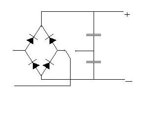

We have a lot of very knowledgable people posting on this site but maybe there is still room for this simple idea!
Here is a simple circuit that will double your voltage (or halve your current) with just a single relay change over.
The AC from the alternator comes in from the left and with the relay contact to the left (as shown in the diagram) we have 'normal' full wave rectification for charging our battery via the two connection on the right.
Switch the relay contact to the right however and the circuit converts to half wave, voltage doubling rectification. One half cycle charges one of the capacitors and the other half cycle charges the other. The total voltage of the two capacitors is available to charge our battery.
I suggest the way to use this would be to configure our F&P for a low voltage by putting more coils in parallel. This will decrease series resistance and increase the available current but the voltage at low generator RPM may be too low to charge the battery, that is when to use voltage doubling mode.
When the wind picks up the circuit is switched to 'normal' mode to avoid excessive voltage.
I think the circuit could be made fully automatic by wiring the relay coil across the AC input with necessary series resistance to cause the relay to switch at the desired voltage level.
I guess we could also use the voltage doubling mode to increase the voltage and reduce transmission losses when the alternator must be a long way from the battery.

Hi John
Yea this is as you say a well known cct used extensively in pc supplies to change 230 v to 110 v input.
It could be used in FP need one per phase parallel outputs a simple switch/relay will double volts for low volts
another simple technic use three indepentant for low volts then short one AC side bridges to change star only needs two normally open contacts.
Good to keep feeding in ideas even if no immedite response brain storming stirs our brains along.
Even ideas that are not right are good I once worked for FP one director there would always throw in studid ideas to get team going ie elements in heaters to costly lets leave them out sell as separate item.
Not that your idea's wrong
Herb

G'day John, that's a nice trick!
This looks good too, however a little more complex.
here
Dunno how you would scale it up though. Edited by Highlander 2007-10-14
