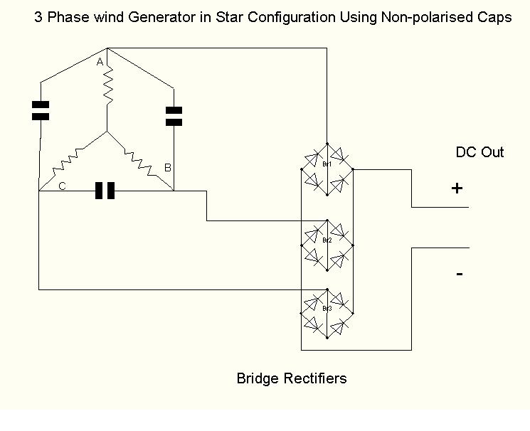

Bryan1
Joined: 22/02/2006
Posts: 2297
Posted: 07:44am 18 Oct 2007
Hiya Guy's,
Heres the schematic of the way to hookup the caps.
Cheers Bryan

Thank you Bryan for your Schematic
The three non polorized caps we use are between 50MFD at 400 VDC and 145 MFD at 240 VDC. It appears the higher voltage affects the way they operate or perhaps its there large size. The 145 MFD seems to work a little better than the 50 MFD . MFD is the same as uf You will double your output on a 80SP in Star with capaciters. This a 100% guarantee with $100 being available to anyone who proves it wrong.
There are many other ways of wiring caps in but the above schematic shows the best method. I have now put my money where my mouth is so give it a try. Our 5 blade Piggott easily turns 6 Amps at 26.2 Volts into 12 amps at 27.5 We continually have to use our dump load . That is in a moderate wind Regards Dennis L

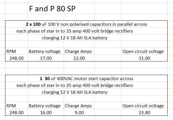

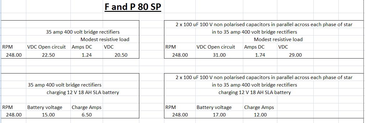

Posted: 12:03pm 18 Oct 2007
Hi Folks,
I first tried 2 100uF non polarised capacitors in parallel (total of 200 uF) across each phase and was impressed with the results.
But I then put a meter set on AC current in series with one of the capacitors (2 x 100 uf) and was surprised with a reading of 5.8 AC amps. I think that current at this level could cause over heating of the capacitors such as the cross over capacitors that I have used.
So I then tried 30uF 400VAC motor start capacitors across each phase and the AC current was measured as .7 AC amps which is a significant drop. But unfortunately there was also a drop in output volatage and current. See attached image for a comparison.
p.s. I only charged the battery for a few seconds to get the voltage and current readings.
Cheers,
9c12m

The F&P stator I'm using is only a 80 SP 3 phase star and I chose the 100 uF non polarised crossover capacitors from Jaycar simply because they were $5.05 each and therefore a lot cheaper than motorstart capacitors that are $12.95 each. But I did use 2 of the 100 uF capacitors in parallel which then provides 200 uF across each phase. The only reason I chose 2 in parallel was because I had read some where that heat build up could be a problem my thinking (????) was that 2 caps would have a better chance of disipating any heat. Also these caps are only 100 volt working and Dennis has suggested that perhaps a higher working voltage would be wiser.
But from my comparsion with 30uF capacitors and measuring the AC current circulating through the phase capacitors it might be that the bigger capacitance then the more chance of heat build up. But the heat buildup could also be a factor of frequency, capacitance, and inductance. ??????????????????
Clearly the reasons why this works and how to select a capacitance for a particular application is way beyond me. I will do another comparsion tomorrow using just 100 uF and see what happens.
The other interesting thing I have observed is that the higher the current produced heading towards the max current capability of the stator (without capacitors) then the AC circulating current in the caps reduces.
Cheers,

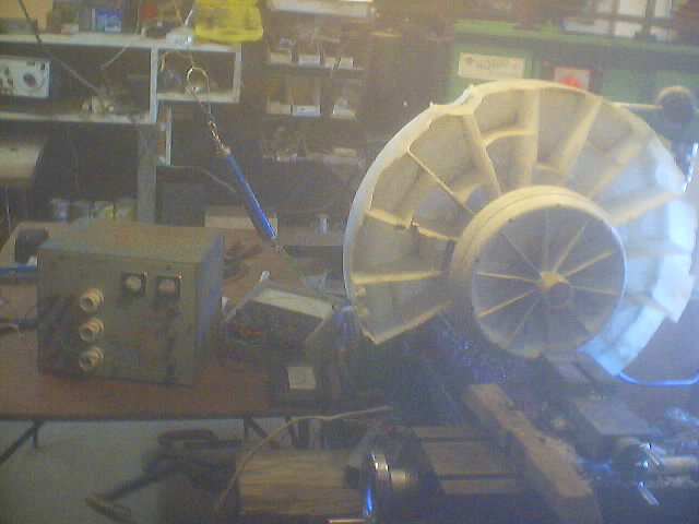

Glen My lathe is all set up with variable speed drive (electric drill and variac ) And can support a smart drive in chuck I then stop the stator turning with balance measuring torgue speed is measured by hand tacho also I store output on stoage scope as I take measurements to check speed. I feed out put into my shed battery bank that is also suppling the Lathe so battery volts stays resonably constant also a small hydro and windmill is feeding in to make up losses. I have found it is necessary to test into a battery as resistive loads use all waveform, batteries only use peaks . along with capacitor tests I see its about time we got a relationship of number turns producing to output along with current limits when stator flux cancels out rotor flux about 240 ampere turns I believe.
As regards the caps I have from my teaching days a cap bank that is three phase alowwing cap values up to 210 mfd's in 10 MFD steps.
What I lack is time I have retired And find more work than ever. It amazes me how people on here can get so much done and still spend time here.
