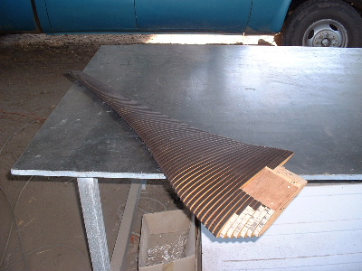

The start of these blades is in Glenns diary (My Diary) 19th Nov, Another way to make blades?

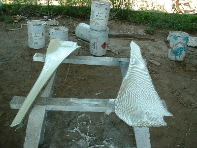

Stuart, it is now in progress, hang in and I will add these new blades to the White Pointer for you.

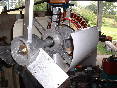

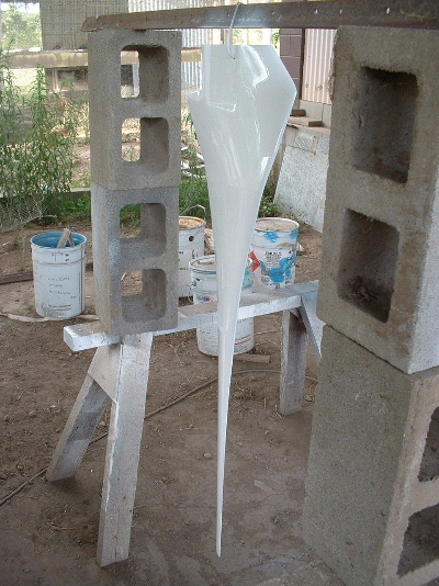

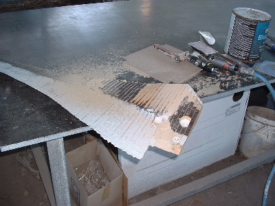

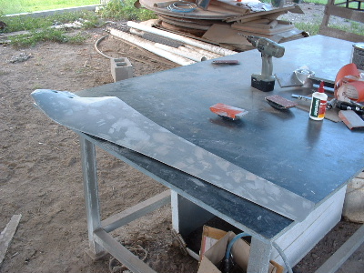

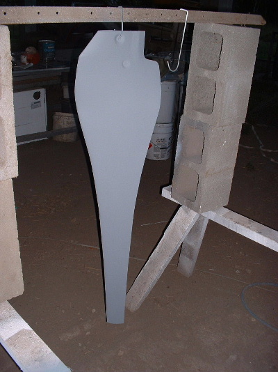

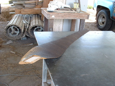

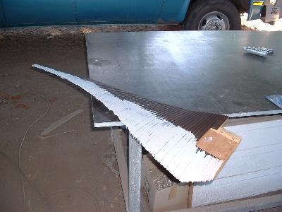

Drilled a hole in the end of the stainless steel and had it hang on a piece of wire to eliminate any side pressure. This is to ensure that the angles are correct.
Each rib was glued individually, one at a time, and the stainless steel lifted off the wire to slide the rib on. A long tedious job. Left for a day for glue to dry.

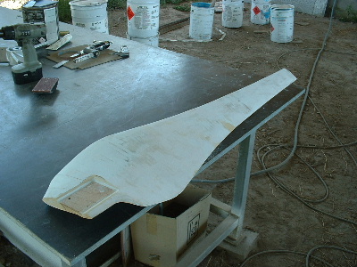

Modified the hub mount end to fit in with the cone. And then to get this on I needed to remove the stainless steel and cut it. In the process ended up with 4 peices of the blade. It is vey soft and flexible. Anyhow cut the stainless steel and fitted back in and glued up all the breaks again.
Puttied where needs to be and started sanding off.

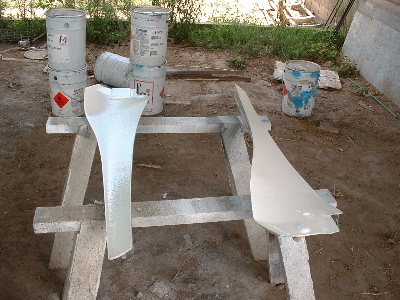

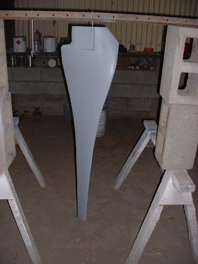

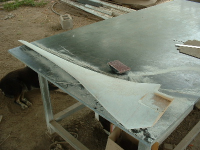

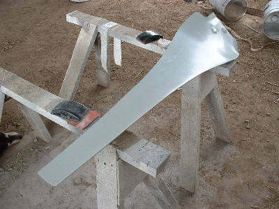

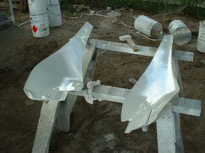

- Sanded off the MDF.
- A light smear of filler over the entire surface. Sanded off.
- Spray putty and sanded.
- More filler and sanded.
- Final spray putty and sanded.
- Sprayed white 2 pack.
Just the usual stuff in pattern making! And all takes time. Time to do the work and time to let it dry!Pictures may not be in any particular order.

Posted: 11:24am 25 Nov 2007
Trev,
I like the long cord near the root. That's got to improve efficiency and make for easier startup.
Most impressive.

Posted: 09:25am 01 Dec 2007

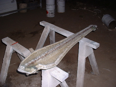

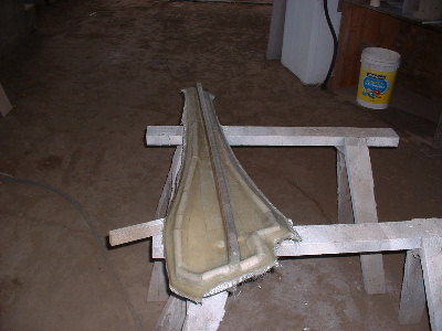

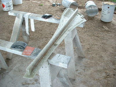

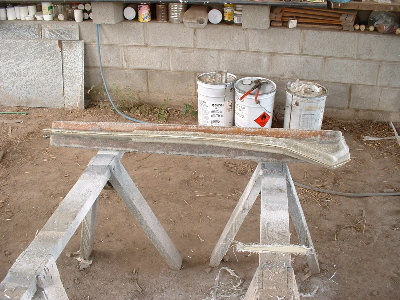

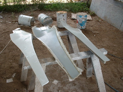

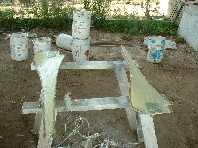

First mould half is made and cleaned up. Second half is glassed, due off the blade tomorrow.
Trev @ drivebynature.com

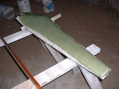

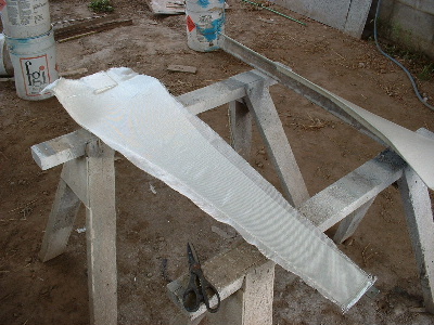

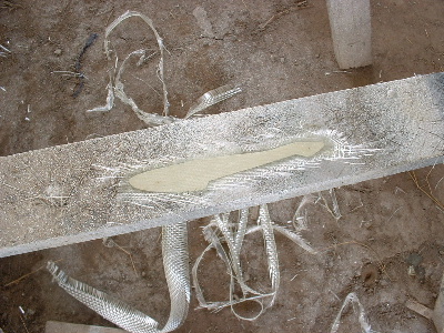

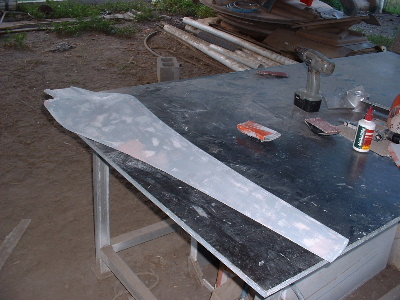

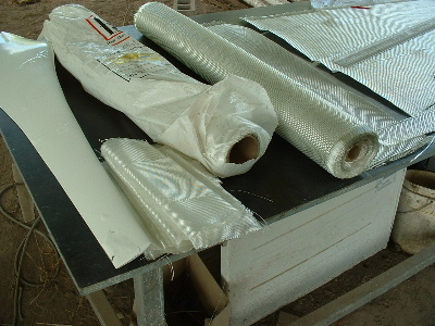

2nd half of the mould removed and cleaned up.
The plug blade didn't fair quite as good. paint blistered and peeled and cracked the blade again in 3 places. Not to worry, it has done it's job.
Both halves of the mould rubbed out with 1200 grit wet/dry paper and polished.

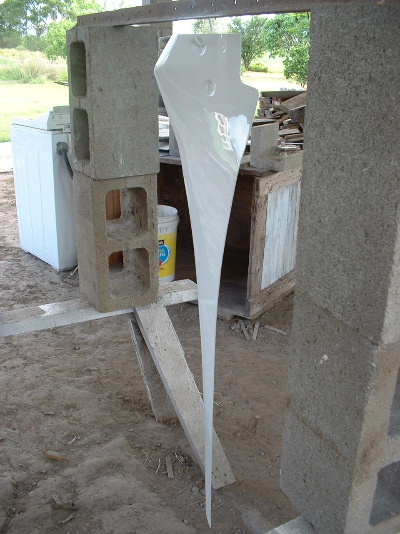

Locators fitted.
Release waxed, polished off, PVA released & gelcoated, cut glass, lay fine (200gsm)woven glass and green trim, lay 630gsm woven and green trim, lay glass on end cap mould, lay 4 layers each mould half of 630gsm for hub mounting, mix glue, wipe on, join together and remove the blade.
So there you have it, the whole process to make one blade in one paragraph.
Unfortunately it's not that simple. It does take time.
And the first White Pointer to get these new blades. There are 2 of these on the go at the moment. Both sold. Price for the blades only, I am yet to work it out.

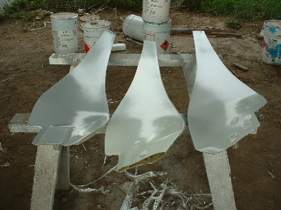

Here is a pic of the blades all assembled.

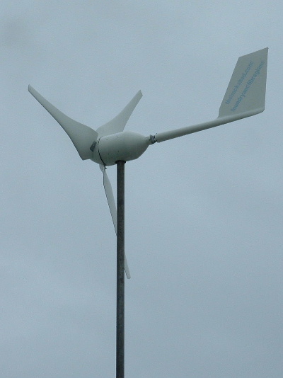

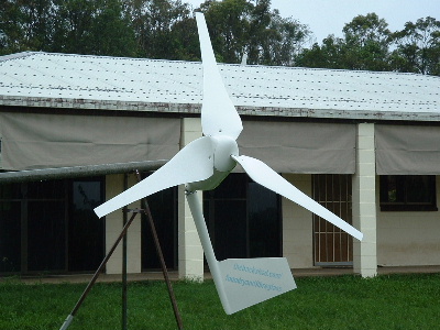

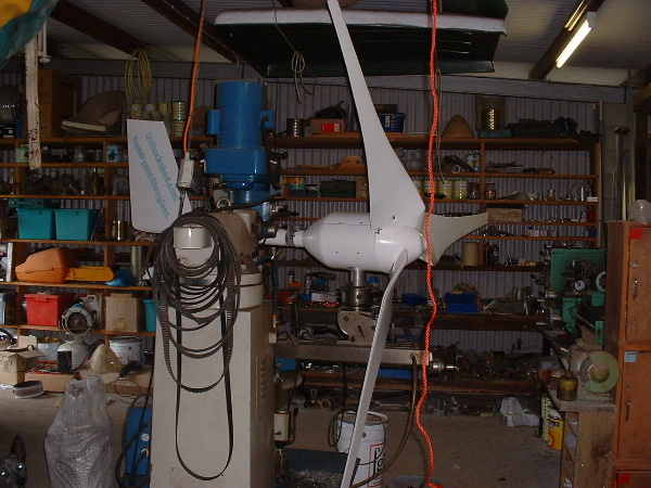

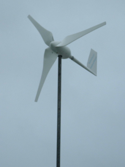

Finally got one of these machines in the air for myself. Here is Glenn's Testing. Thanks Glenn.
Some observations
Performance is good. Starts up in light winds. Gets up to speed fairly quickly. Some noise, mostly at higher RPM or in wind speed changes or wind direction changes.
Unfortunately my wind speed guage has died and so don't know any corelation between wind speed and amps. I have seen as high as 18amps into my 12v battery bank. I have never seen my 1m f/glass composite blades get this high! They are definately and improvement for power production.
The White Pointer 2.5 was put up in the rain, hence pictures are taken in the rain.
