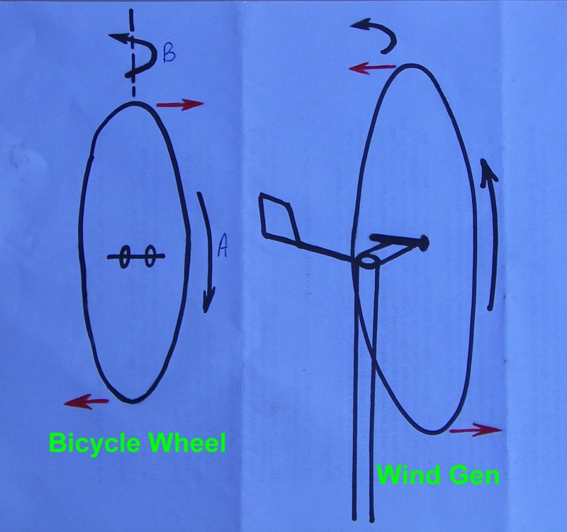

Hello Designers,
Picked up this hint on FL and thought it significant enough to share here.
Now get the kids to verify this for you:
  • Take a bicycle wheel and spin it very fast say in direction 'A'.
  • Now rotate it about a vertical axis in direction 'B'.
RESULT:- Bottom will suck in, and Top will push out.
Recommendation:- Design your wind generators with a rotational direction that, with correct sided offset, causes the bottom to push out on entering furl. This could be a blade saver if you use close blade to mast spacing or flexible blades such as PVC.
Summary:
Clockwise rotating (looking from front) prop = left hand offset.
and conversely,
Anticlockwise rotating prop = right hand offset.
A good general rule to follow for all designs me-thinks.
Glenn, perhaps worth a line or two in the main site pages???
Cheers Gill _Cairns, FNQ

Sorry martin, you've missed the understanding of the process. Speed of rotation does not induce any forces that can be used for furling, quite the contrary, the faster the rotation the greater the gyroscopic resistance to furling.
What this little experiment shows is by it's gyroscopic resistance to yawing, perpendicular (pitching) forces are evident. These forces can be to our advantage or disadvantage depending on the rotational direction and yaw direction of the furl. We can use these forces at the time when most flex is on the blades due to high speed and furling.
There is no advantages for a pitching furl as the forces induce roll which has of no advantage for a lay back furl design.

How much gyroscopic force is there on a mill rotor, considering most of the inertial mass is located towards the centre of the spinning disk? This is unlike a bicycle wheel, where nearly all the mass is located at the perimeter and contributes significantly to the gyroscopic effect.

ok gill i see the concept, clockwise direction lh offset tend to push blades in closer to pole, therefor posability of a strike. anticlockwise direction & rh offset should tend to push blades away.GWatPE statement is true, probably only advantageouse to those using pvc blades, mine i carved from lamminated beams so there very rigid.
