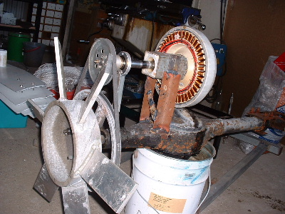

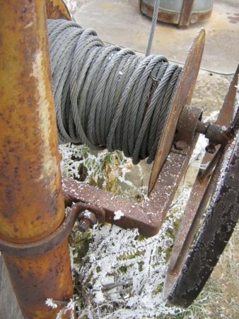

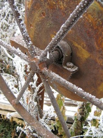

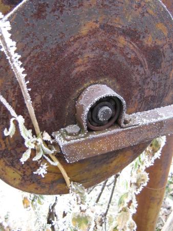

I think I will use this "procedure" to hold my bearings in position (for windmill). What do you think, guys?

Hiya Vasi,
Eh mate thats a good idea for holding the bearings and there's only one thing that worries me with it, the bearings are open and any dirt can enter the bearings etc. Much better if you can get hold of some sealed bearings then you should see a long life out of them.

Hi Bryan,
I searched around (all markets from my town) for hubs like ones from Glenn web page but no success. So, I don't have other choices. I hope this will work.

Hiya Vasi,
A simple work around would be to make some shields on both sides of the bearing mount. Simply push some grease thru 1 side untill you see it come out the other side all even then put the covers on to stop any grit or dirt getting in and it should work for years.

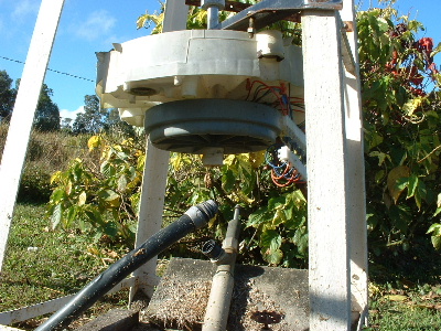

I will use sealed bearings from KiwiJohn. But we can find sealed bearings, hubs are the big problem. Here I get stuck . I saw you used the hub from washing machine, how it works? You can trust it will resist?Edited by vasi 2008-01-01

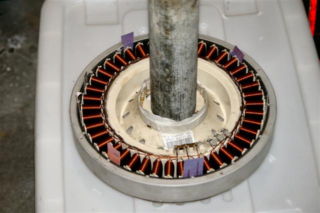

Hi Vasi
I fear that your scheme would make it difficult to accurately mount the stator concentric with the shaft.
I made a hub in a piece of water pipe and described what I did at http://www.thebackshed.com/windmill/forum1/forum_posts.asp?T ID=77&KW=resinEdited by KiwiJohn 2008-01-01

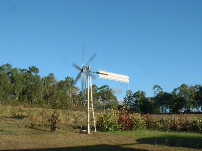

Bloody Hell it's 43 celcius here.

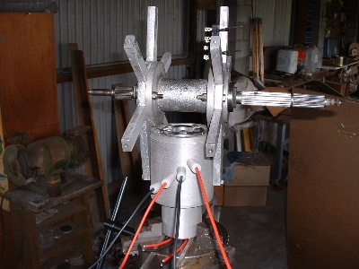

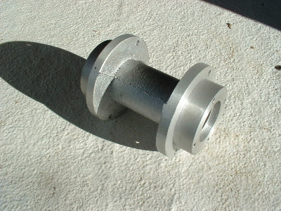

Hey Vasi you could use these
I'm looking forward to your progress

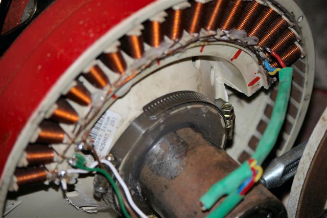

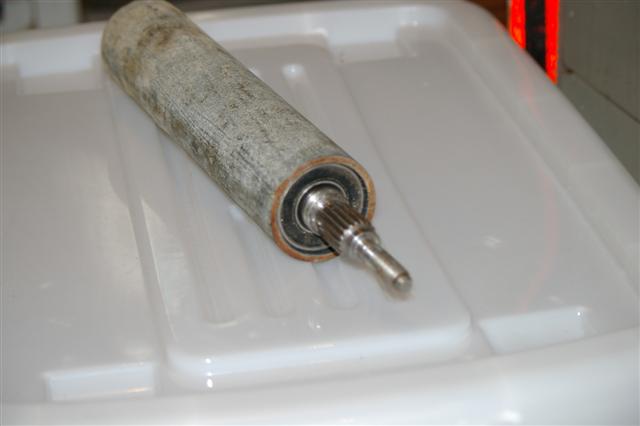

OK, I went downstairs and took some pictures!

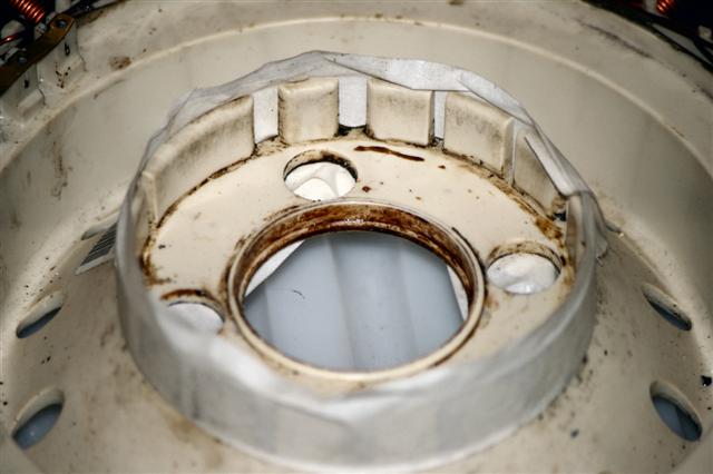

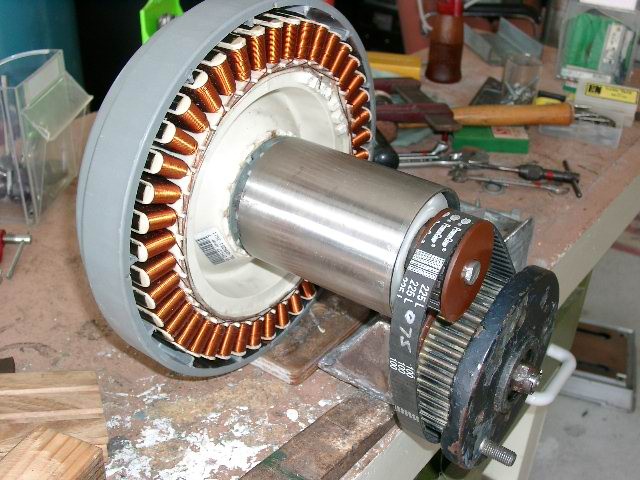

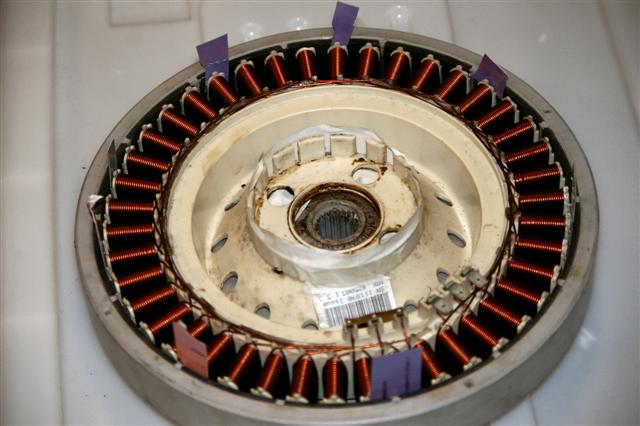

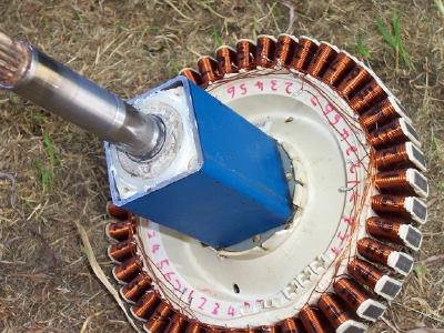

I found a piece of thick wall steel water pipe that the bearings are a close fit, in this case I had to wrap one layer cut from a tin can to make a tight fit but it is pretty snug in there and note I push it in about 3 mm below the end of the pipe.
Now the stator, I should have cleaned it up a bit more but I was born lazy. I have used masking tape to block the holes in the stator and wrap around the lugs on this side of the stator.
Next step is to place stator in the rotor and to push pieces of plastic or card in the pole gaps to ensure the stator is accurately centred.
Then I put the shaft with its bearing in the tube into position on top of the stator. Because I pushed the bearing in that extra little bit the tube fits over the small ridge on the stator. The shaft is pushed through and into the rotor. In theory everything is now centred!
Next comes the interesting bit where I should mix up some resin and pour it into the gap around the end of the bearing pipe and up to the top of the little dam made by that masking tape.
Here is what it should look like when finished! Notice that I have used hose clips around the lugs of the stator as the resin does not stick to the stator which I think is a good thing as it enables me to change the stator easily. (Dont be distracted by the cut-away stator, thats part of another story!

Why are we not recommending the use of the FP hub or bearing holder I use them all time.
I looked back and see one was sent.
Herb
Highlander
Joined: 03/10/2006
Posts: 266
Posted: 10:26pm 31 Dec 2007

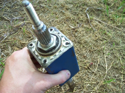

That's right we did.

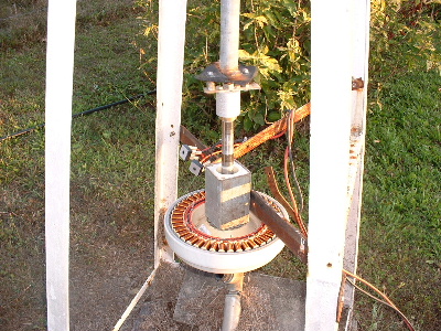

Vasi the white plastic thing the shaft went through that came with the box is the centre of the washing machine, inside it has an aluminium area which is quite strong.
If you use a power file (or an angle grinder carefully) you can shape it to fit in some rhs steel then just weld it to whatever you want.
be carefull with the end which has the 4 threaded holes when you're reshaping, don't forget to use the metal disc's on each side of the stator.

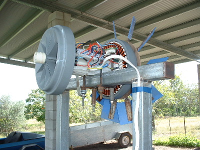

brucedownunder2
Joined: 14/09/2005
Posts: 1548
Posted: 10:50pm 31 Dec 2007
Happy New Year ,friends,,
I used the nylon F&P hub ,rough cut with a sabre saw, then fine trim with a sharp spokeshave. fits perfectly in, ( I think ), 3 inch or 75mm pipe,have to drift it in with a soft hammer. Then a few pop rivets to stop it wandering . The steel pipe can first have little pieces of angle or lugs welded to it ,,so you can bolt the whole hub down on your platform-pic of it somewhere in my irc album.
Hope this helps

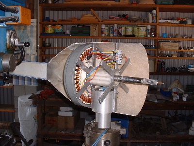

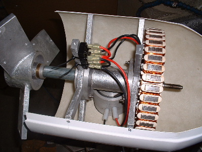

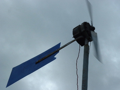

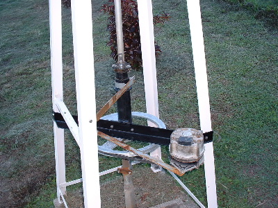

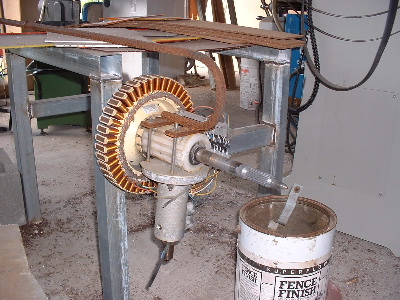

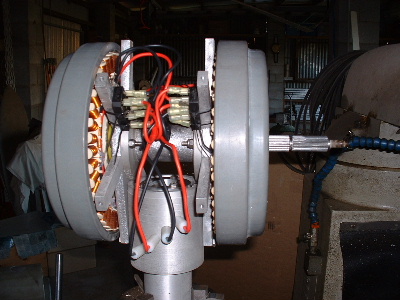

Yes, I asked for solutions and also asked Bryan about using washing machine hub (I saw his work but I wanted more details about how he mounted that hub on the mast):
[quote=vasi]I saw you used the hub from washing machine, how it works? You can trust it will resist?
[/quote]
And is about this picture:
The second picture is used to show that Bryan used the nylon hub in final montage.
I wanted also something different because I not trusted that nylon hub and had no good solutions for masthead (I have now ).

Posted: 05:28am 01 Jan 2008
G'day Vasi, the bit of square steel is 60mm across inside, when you reshape the plastic you'll need to take of a little aluminium as well. Make it a tight fit and belt it on with a hammer.
Just be really carefull not to damage the 4 screw mounts otherwise the stator won't go on square.
