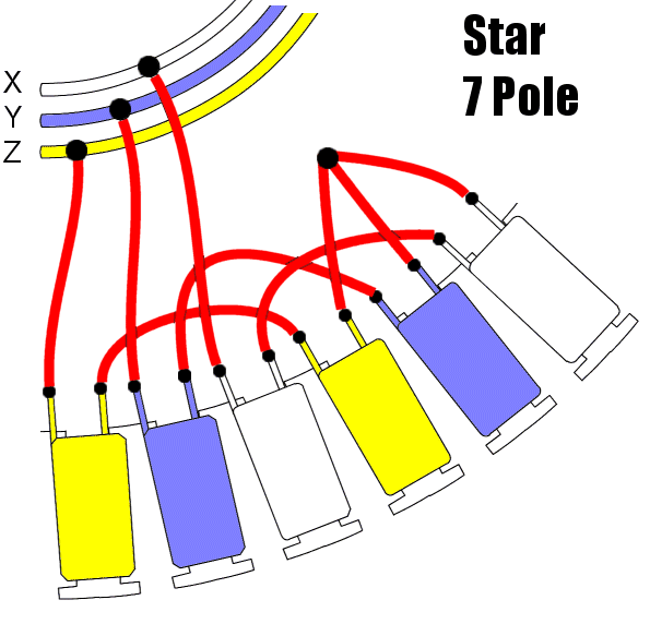

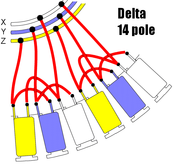

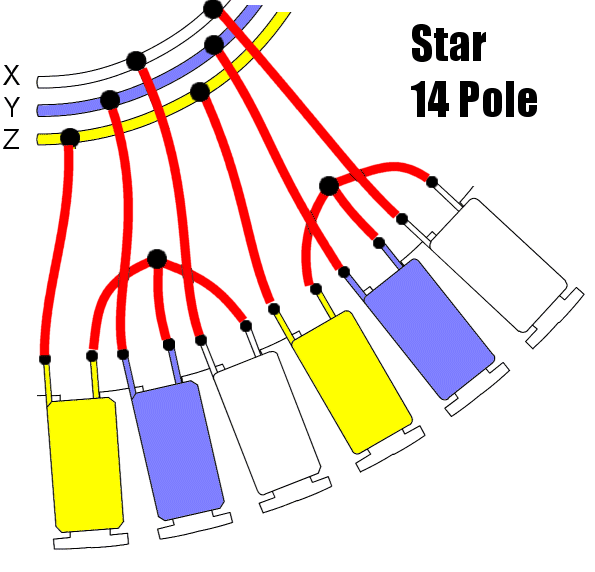

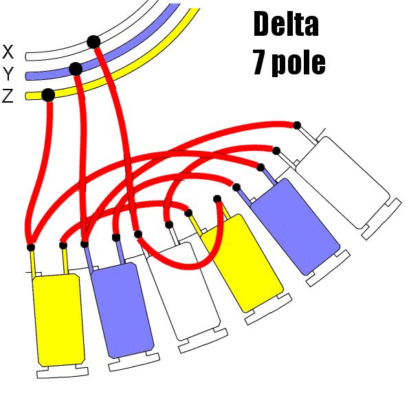

I drew up 4 diagrammes to show the difference between star and delta connections on the F&P. Its gets a bit messy, especially the last one, but if you follow the red wires you should be ok.
Each coil has a start and end connection, the start connection is the wire that disappears under the coil ( it is the start or first layer of the winding ), and the end connection is the wire at the end of the winding, or the wire on top. Think of each coil as a little battery with its polarity swapping from end to end as the magnets go past. Its when we connect these little batteries together, is important to make sure we get the start and end connections the correct way around, or we end up shorting the coils out.
Star connection: the start wires of coil 1, coil 2 and coil3 are connected together. The ends of each coil make our 3 phase power.
Delta connection: the end of coil 1 connects to the start of coil 2. The end of coil 2 connects to the start of coil 3. The end of coil 3 connects the the start of coil 1.
This is a Star wired as 14 poles, good for 100 series stators in strong winds.
This one is a star 7 poles, the most common converstion and good all rounder!
Now we get fancy with a delta 14 pole. If you have VERY strong winds, like F&P Murray , this is the one to go for.
And this is a delta 7 pole, less current, more volts than above.
As a rule, delta give more current but less volts, so delta is good for high winds.

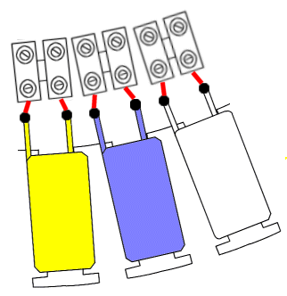

As F&P's would be pretty rare up in Canada, I would suggest you make your stator so it can be easily reconfigured. This can be done by adding screw terminals to each of the 42 poles. I have seen this done, but cant find the photo, so drew this diagram....
This way you can play around with different combinations without the risk of damage to the windings. But even if you do damage a coil, they can be rewound, see Murrays message above.

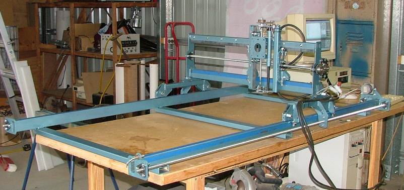

You should see if your friend wants to make fibre glass blades for the DIY windmill builders. I've been building a CNC router to make blades on, as well as other stuff. I fired it up today to check the motion systems, all ok but needs some tuning to get the speed up. The bed size is 1200 * 600, so its big enough to make a set of 3 blades in one go. I still need to buy a router for it, trying to find one thats quiet, a set of blades would take a couple of hours to rout, thats a long time to have a router screaming its head off.
I'm tempted to rip the milling attachment off my lathe . Its quiet and I never use it.

Thanks for the help and didn't think of doing this. Just little confused about how the F&P hub comes from factory is it already wired up as 14pole star as a standard. Then on your pic on top would this be star/delta or series/parallel setup. I will post pics as I build and going to use a coupler from F&P hub to main shaft on VAWT, well my plan anyhow. I think I am the only rare bird with a F&P hub, must be nice to have them so common there. I am back on my feet and making good progress slowly
Thanks Again
Wayne
Posted: 09:40pm 09 Jan 2006
Hi Wayne
Yeah you are right, This page http://www.thebackshed.com/Windmill/FPRewire.asp has more details. I've got the terminology mixed up a bit in the drawings.
