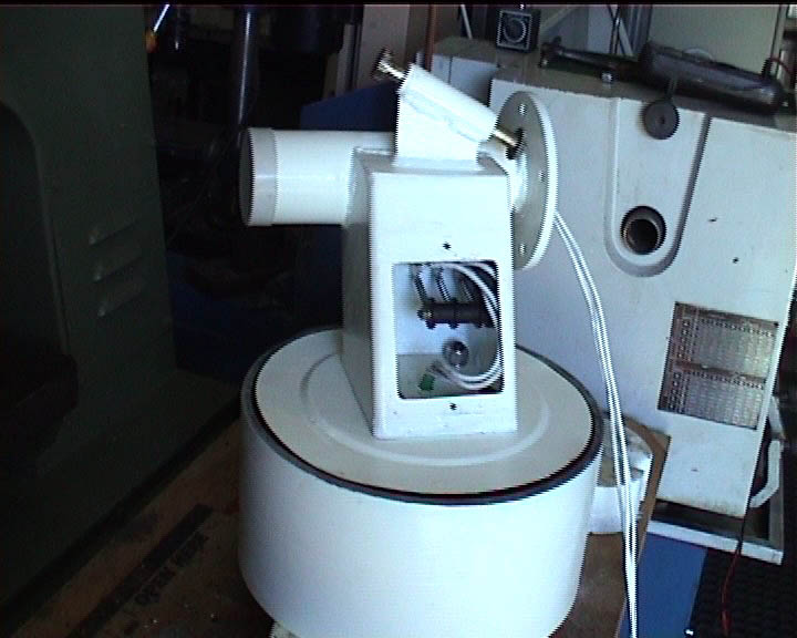

i don't have any pics of the parts during construction but when i biuld the next one (mid feb) i will certainly take some. most parts are off shelf including brushes for slip rings they come from a forklift starter motor i have to grind the correct radius on them. the whole slip finger/ring assy is very simple i got the idea from an old dunlite 32v machine that i repaired some years ago.

Posted: 10:18am 17 Jan 2006
side view of alternator and offset bracket and yaw tube,slip rings and brushes inside offset bracket

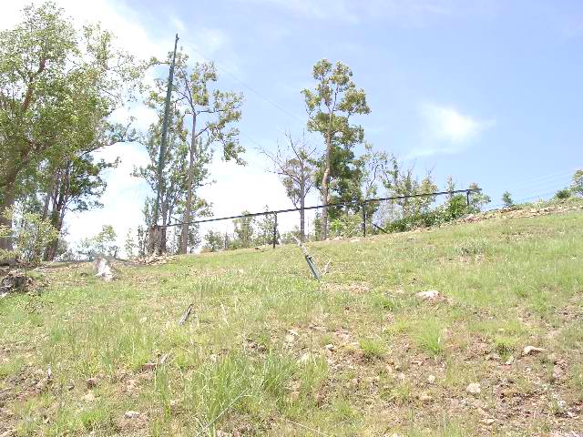

Hi Peter, Lovely work , I think I saw your work some time back of you stamping out the stator lams,??, somewhere,can't remember. Can you please post some more pics of the stator close up and the rotor,or post a link to your pic's. ? . if you have any.
I see you are using square tube for the mast , . I have used 3x3x 3/8 equal angle back to back- a bit heavy and I get a bit of bending while it is being raised and lowered, but so far it's not a worry. My big winch hauls it very easily,just a bit worried on the lowering action -so far so good and the gearing of the winch slows it to a stop in a second or so.

I had a look at the pic of the tower it does look like it's square but
it actually 89mm NB round...    The tower in the pic is 12m long    2 sections of  sched 40 water pipe 7x7x7 rope  it also bends a bit when tilting but
no problems. I use a tifor winch to operate the tilting, a bit slow but
is under control at all times. your tower looks pretty good do those trees interfere with the mill? Wasn't me you saw making lams, don't have a pic site

Posted: 11:51am 19 Feb 2006
hi peter, actually the trees are on the 'downwind" area(even though they are uphill of the tower). I cleared the area and left a 5 foot stump of bloodwood some 2 foot 6 inches in dia . soaked it in creosote for 6 months ,so it should see me out.
still trying to remember who posted a pic of him stamping out lams.
My guys are rigid steel 7 strand line guy wire from the electrical line construction company. the steel anchor pieces go down to a "deadman" about 3 feet down and are concreted in-had to use a jack hammer into rock ,so they are not going anywhere fast ,lol.
