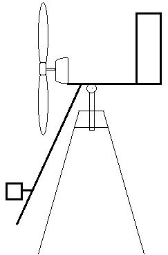

The furling system with moving the rudder seems to be doing the job well. With regards to that, I had a trip out to the Chatham Islands many moons ago, where the locals had the old Gentle Annie washing machine motors as the power producer. Yes, it was a LONG time ago. Most of the wind installations had a furling system that simply tipped the generation head backwards, rather than sideways to the wind. Simply had a counter weight with the generation head on a universal joint above the pivot. Now there is probably a good reason that system I haven't seen, but can't picture why.

Hi Pete,
If you are asking about this type of furling then there are a few turbines that use that system, the whisper is one rotates up but at an angle as well. Another uses a gas strut, It works but there is always a downside and when it furls up it will cause a torque and want to turn sideways as it furls. In my opinion all furling is a very crude form of turbine regulation and safety but the alternatives are costly.

Thanks Phill. Gyroscopic procession must also happen with horizontal shifting out of wind as well. I don't have a mill of any sort, but follow this site with interest as all things mechanical crank my handle.
Just thinking that an adjustable counter weight may be simpler than getting spring tensions right. Can see that a rudder pulled 90deg will keep the mechanical bits sideways to the breeze if no energy is required from the mill. But that's what hot water elements and dump loads were developed for .
